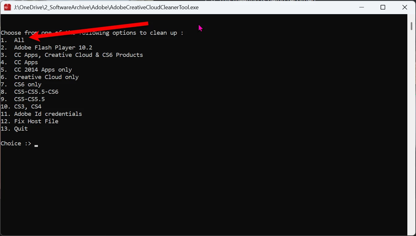

Dave Creamer of IDEAS
March 12, 2025
I would suggest using the Adobe CC Cleaner app, remove ALL, manually make sure all your caches are deleted, manually remove any Adobe folders left in the Libraries, reinstall the Creative Cloud app, reinstall the software from that app.
March 9, 2025
Read the solution--don't just uninstall InDesign.
As Steve Werner said, run the Adobe CC Cleaner tool and remove EVERYTHING Adobe, not just InDesign.
https://helpx.adobe.com/creative-cloud/kb/cc-cleaner-tool-installation-problems.html
Download the Creative Cloud app, then install InDesign from the app.
March 9, 2025
Just to confirm--with the CC Cleaner, you selected ALL.
