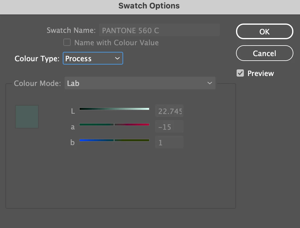

Need to convert Pantone colours to CMYK, but when trying to it will only let me have LAB colour
  • September 14, 2023
  • 返信数 2.
  • 1624 ビュー
Will LAB colours be okay to print? I can't get it to convert to CMYK the options are greyed out

You should really use the CMYK colour breakdown in the Pantone Book, they're side by side in the Pantone book.
And it would be noted that the CMYK will be a different shade - so it's typical to try to match your Pantone colour to a variant of the CMYK on the same page in the Pantone book.
Peter Spier
September 14, 2023
@Eugene Tyson That works for Color Bridge books, if you have them, but solid color books don't have process color swatches along side.
And those CMYK numbers are in an unknown profile for an unknown press that pantone uses to print the books, and they won't necessarily give the same color on another press or a digital output, so I'd prefer to let InDesign use the published Lab values to determine a good CMYK mix. Or even let the printer do the conversion.
It's always a crapshoot for a good match, but I think the odds are better going through Lab.

Instead of redefining the spot color use the Ink Manager (in the Swatches Panel flyout menu) to output as process.
September 14, 2023
amazing! thank you so much!!!

If you know you will never output as spot inks you might want to use the Pantone Color Bridge colors instead (they're Pantone's packaged process conversions) but how close a match you will get is, I think, somewhat more dependent on the output profile of the printing device than letting InDesign use the Lab values to find the correct simulation for a specified profile.
Keep in mind that you will never get a perfect color match converting spot color to process. Some colors convert well, others are well outsice the CMYK color gamut.
