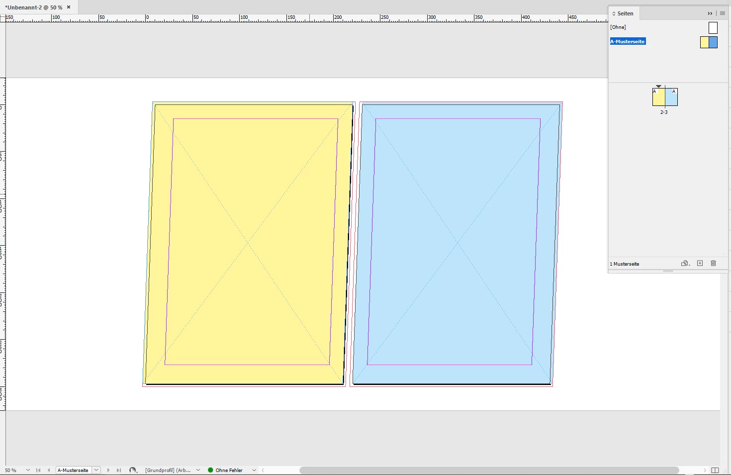

Well, there is a deeper solution.
Part the two master pages a bit from the spine.
If that does not work, also part the document pages a bit from the spine.
In a facing pages document this is hard to do. We are on uncharted territory here:
The only way I see: Skew the pages with the Transform panel when the pages are selected with the Page tool.

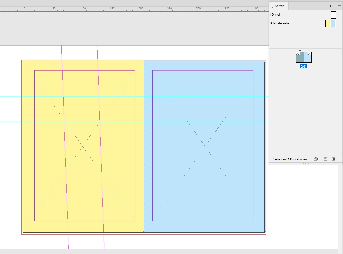

Sample of two skewed master pages:

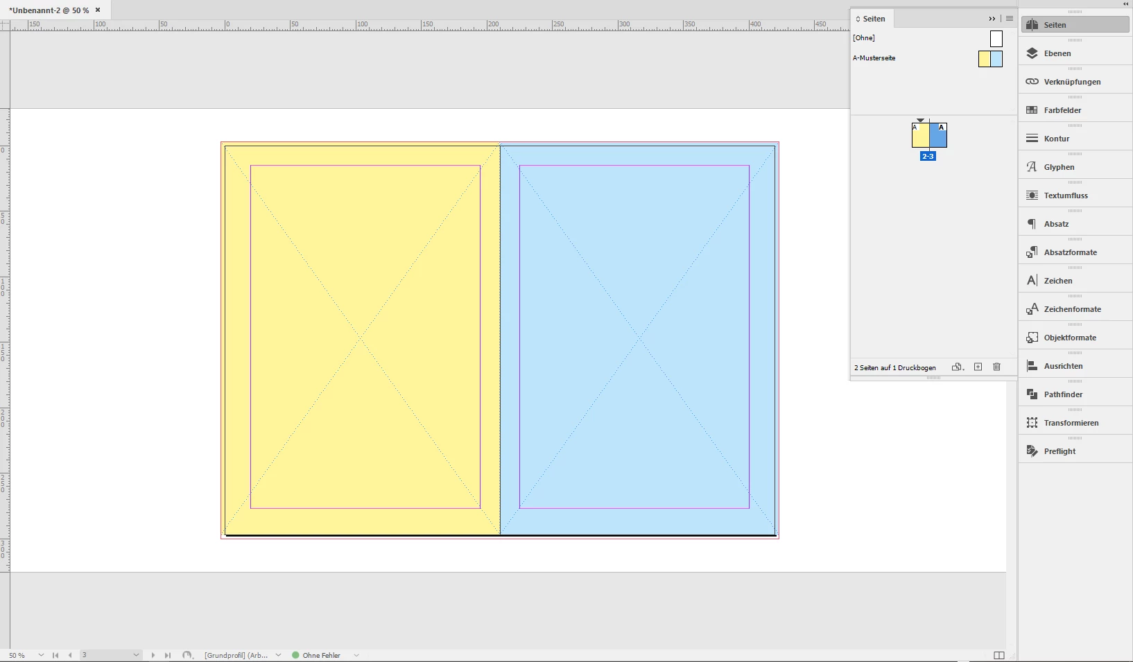

Applied to the document pages:

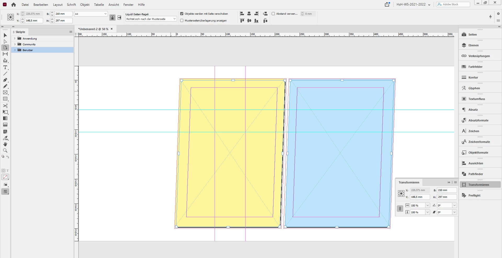

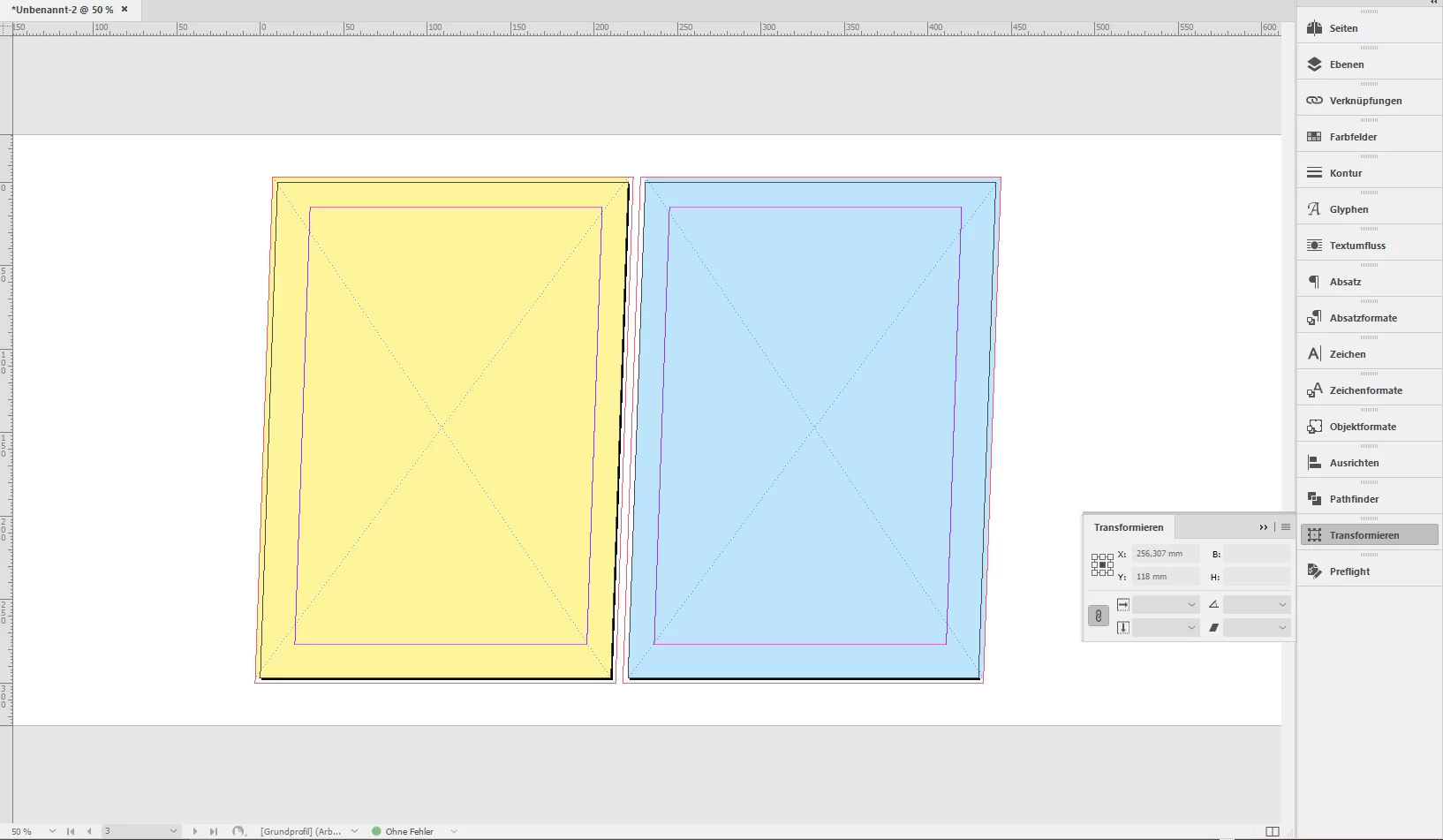

If you still see an issue also skew the document pages ( in my sample I skewed by 2° )
One issue with that solution are the vertical guides from a master:
Not so when the document pages are also skewed to the same degree:
You see, this solution is a bit adventurous…
Uwe Laubender
( ACP )
