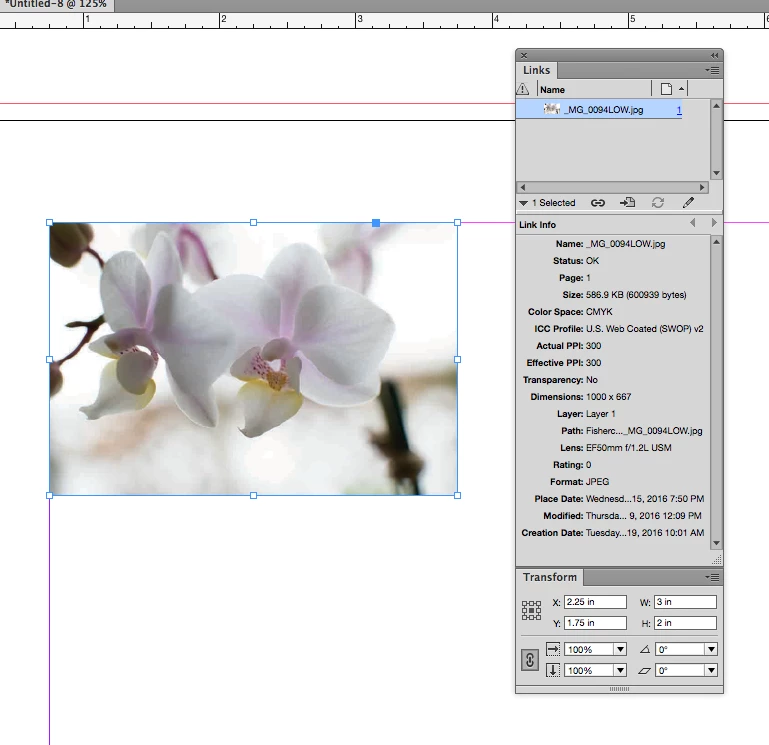

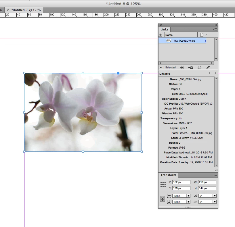

rob day
June 16, 2016
I still don't see a clear answer to the question of how do you create an image in Photoshop that will place into Indesign at the same size?
In InDesign the size relationship of placed objects is to the print output dimensions—an image's pixel dimensions do not matter.
Pixels can be chosen as a static output measurement, but the unit of measurement has nothing to do with resolution which can be confusing. So to illustrate my #7: When my rulers are set to Inches, this image's print output width and height are 3"x2" and you can see the Effective output resolution is 300ppi.
If I change the ruler units to pixels the width and height read as 216x144, but that has no affect on the output resolution, which remains at 300ppi. The Transform readout is showing the output dimensions of the image's frame in static pixels where 1 pixel = 1/72", or = 1 point
