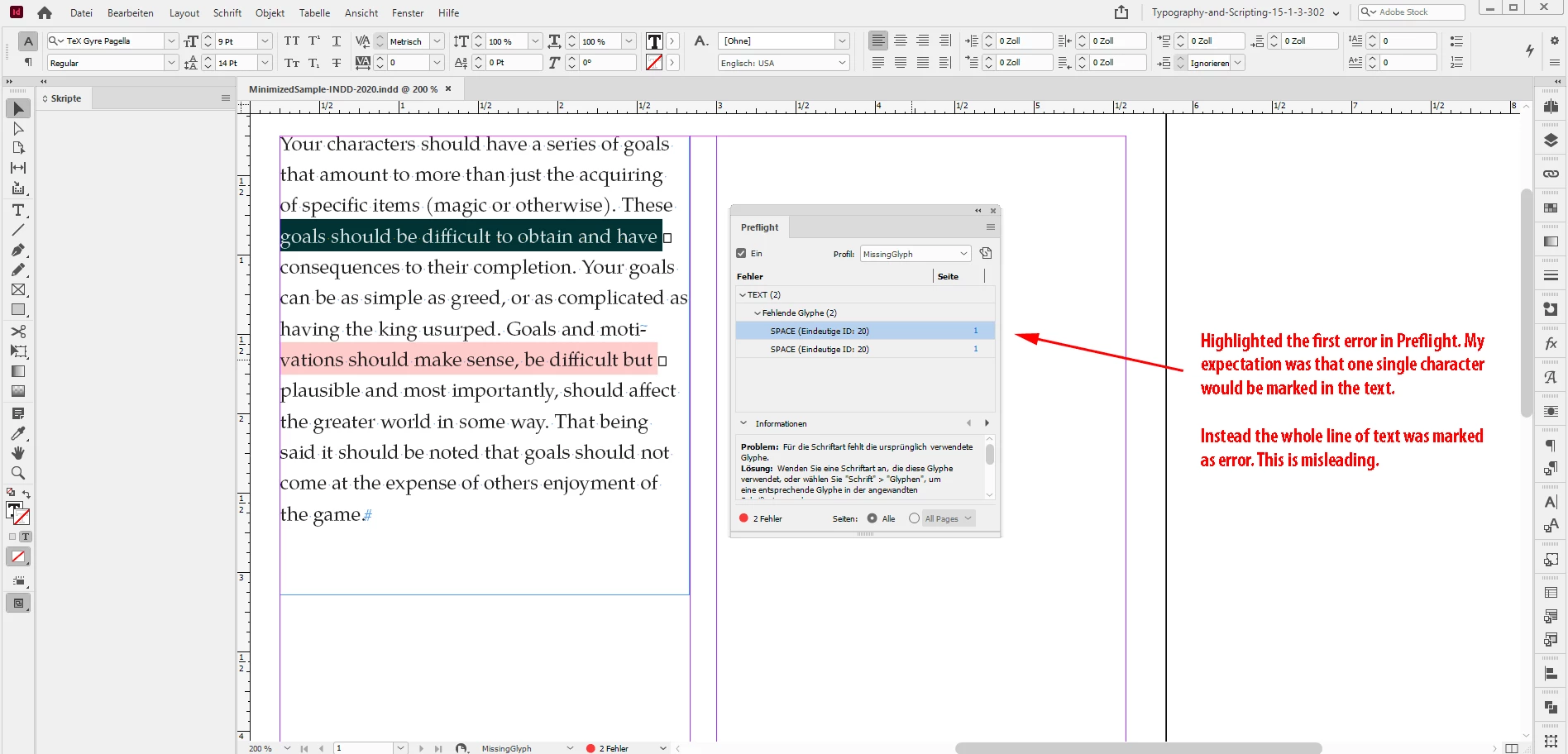

I'm trying to cut and paste from my main document (in OpenOffice) to InDesign. I'd say that 98% of the text is fine but occasionally I get random sections of text highlighted in pink with tiny squares next to them (see attached pic below). I don't believe this to be a missing font issue because I will have an entire paragraph with this particular font be perfectly fine. While another has roughly 3/4 of the text normal and the other 1/4 highlighted in this way. I can't simply change the font because I need that font I have for the body text. So far rewording the text has worked (to an extent) but after a certain point it will randomly highlight again. Any help would be greatly appreciated. Thanks

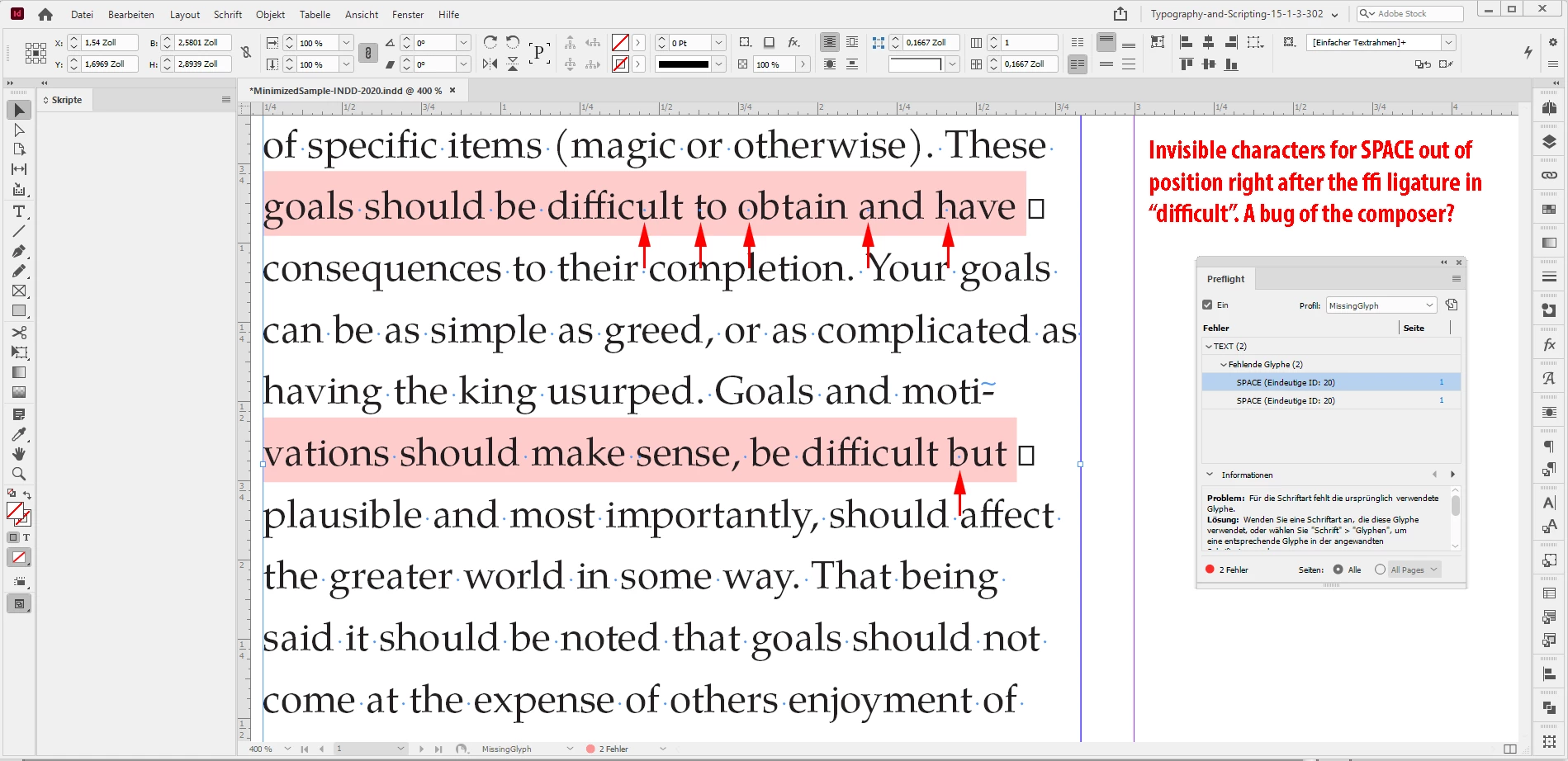

also checked a minimized document with just one paragraph with InDesign's Preflight.
A missing glyph error is showing up with glyph SPACE:
So we have at least four issues here:
[1] An optical missing fonts warning where there is no missing font. Preflight does not detect a missing font.
[2] A preflight warning of missing glyphs with character SPACE that is misleading.
[3] Obviously an issue with that font and the ligature ffi.
[4] A non-def character at the end of every line that comes out of nowhere and is also exported to PDF.
Ah. And just another one.
[5] Wrong positions of the invisible characters for the spaces right after the ffi glyph in the text:

September 21, 2021
Your link is working very well.
Also downloaded the missing font family TeX Gyre at:
https://ctan.org/pkg/tex-gyre-pagella?lang=en
Made the fonts available through a Document fonts folder and see the same issues like you do in your InDesign document:
There is no style override with characters or the paragraph in this line of text.
I have Style Override Highlighter enabled. Also invisible characters; where InDesign already has issues to render the little widgets for the blank characters if you look closely. The character at the end of the line is a mystery. Let's use the Story Editor window and the Info panel to detect what it is:
Info says it's a plain blank character at codepoint 0020.
The weirdness begins if I open the Glyphs panel and inspect every single character of the word "difficult". Nothing unusual when I start with the "d", the "i", but then with the selected "f" InDesign becomes a bit strange. Something's wrong with that ligature "ffi" in that OpenType font:
And you may notice that the same happens a few lines below. Also with the word "difficult" and the following blank characters.
Can we fix the issue if we turn off Ligatures in the applied paragraph style? Yes!
So that's it. A bug in the font.
I would contact the makers of the font and report that InDesign has issues with ligatures.
Especially with ligature "ffi".

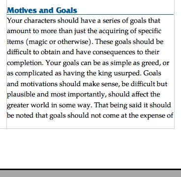

Mycelian작성자
September 17, 2021
Left is InDesign, Right is OpenOffice
