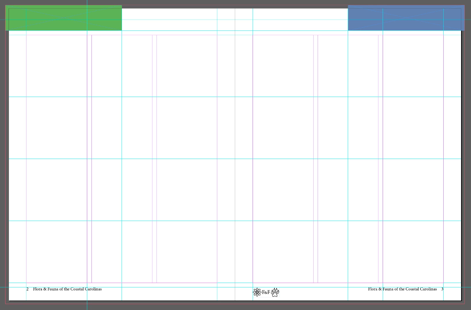

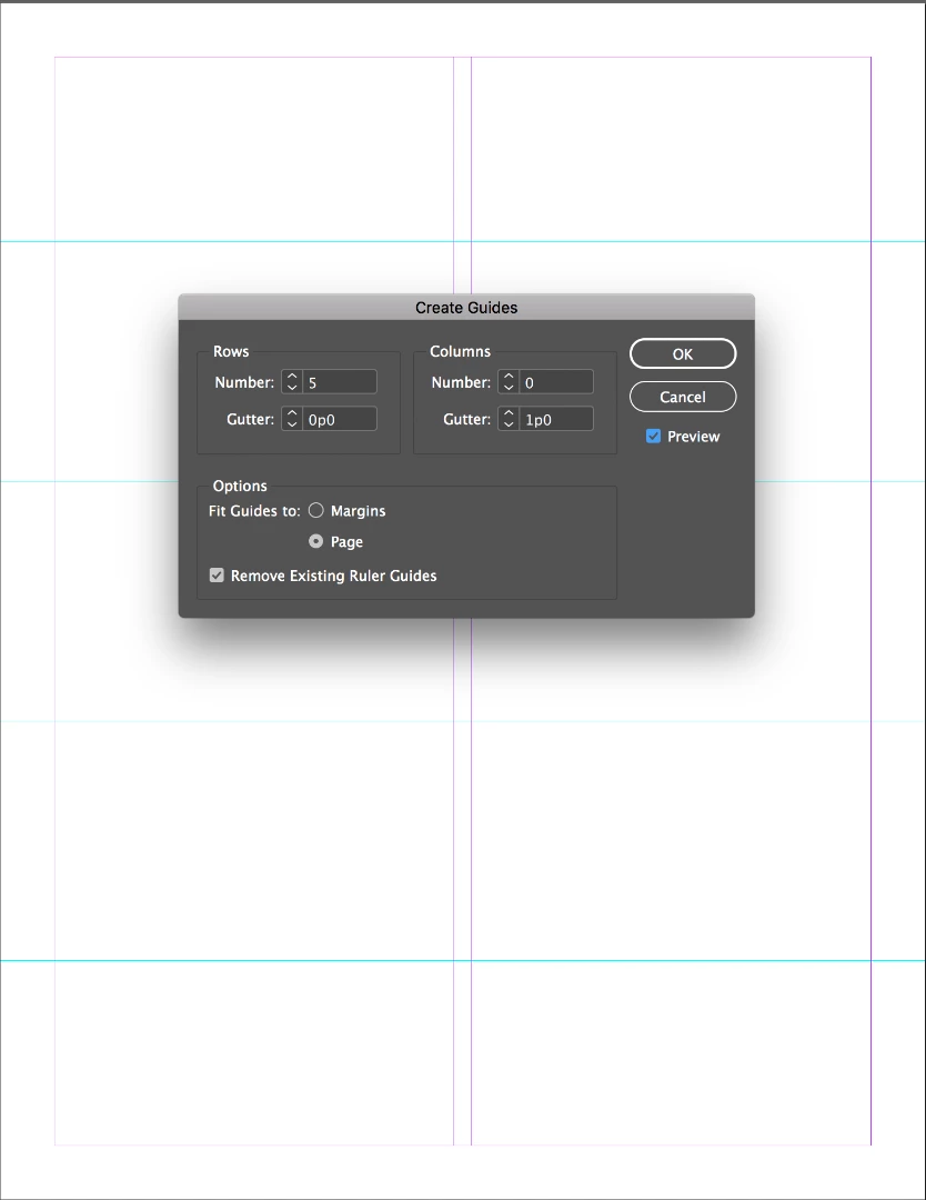

Hi sundaymorning:
It's a great question. I identify them as "visual aids to help with alignment" in my Intro to InDesign classes. We normally start with creating margins and columns—which most of my students already understand from their experience with Word.
Then we learn how to drag guides out of the rulers, to help align multiple objects:
From there, we learn how to use guides to define a grid to help organize the layout:

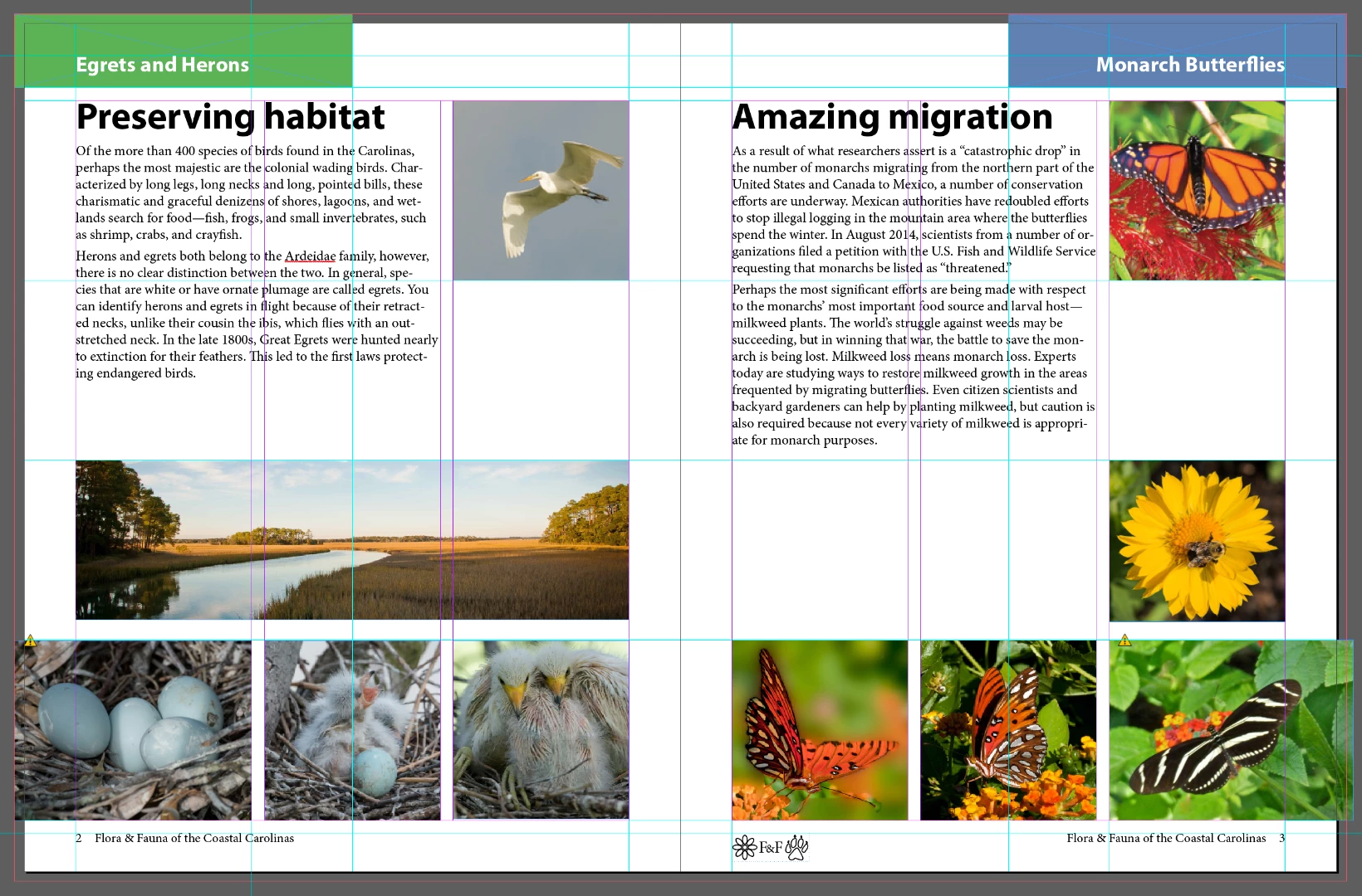

Here is an example of margin guides, column guides and ruler guides in use to align the various objects. (This is actually one of the files we build from scratch on the first day of class.)
~Barb
