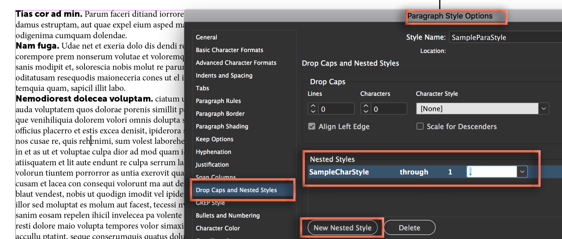

I'm not sure what it's called, but I want to have a paragraph without a line feed, such that the next paragraph starts right after the first, on the same line if space allows.
Years ago, I used Ventura Publisher to do this. I don't remember what they called it. Basically I have two paragraph styles. The first would be style 1-the text would be however long. Then, style 2 would follow right after that.
Does anyone know how I can accomplish this?
    Correct answer SJRiegel
    You could accomplish this with nested styles. You would have to insert a marker (End Nested Style Here) at the end of your first "paragraph", and change the formatting with a Character Style (because without a paragraph return, all the text would be in the same paragraph, so would have to share the same Paragraph Style.)

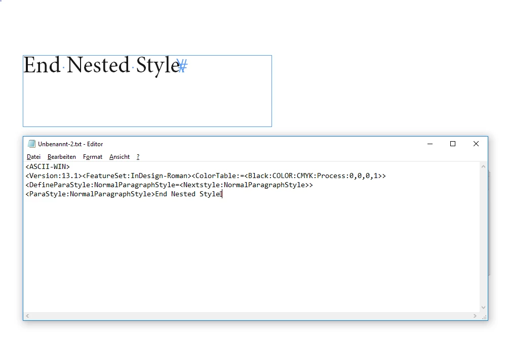

    Thanks, everyone, for the feedback - some really good ideas. The CS5 reference document with embedded tags in text files is immensely helpful in outputting database records that contain those tags so they "auto format" when pulled into InDesign. One question, though. Is there an ASCI character or code for the "End Nested Style" character? In other words, if I were publishing from my database to a text file, I'd write something like:
    <ParaStyle:Member_Listing>Mr. John Jones lives at 1234 anystreet and has been a member since 1985. <END_NESTED_STYLE>He is a member of the botanical gardeners society and has three acres of roses planted on his back 40.
    May 15, 2018
    Hi ClaytonKing ,
    you could try to export some text containing that special character to Tagged Text and look for the code.
    It's Unicode Value is 0003. Don't know if that will help, here's a screenshot of that little experiment on Windows 10 with InDesign CC 2018.1 :
    Uwe

    SJRiegelCorrect answer
    May 14, 2018
