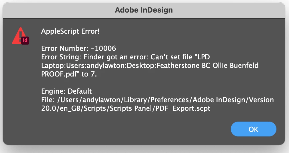

LawtonKAR
Oct 14, 2024 7:58 PM UTC
Scripts Not Functioning After Update to InDesign CC 2025
I have a load of scripts used to produce different PDF's. These will not work in the New InDsesign 2025.
Attched screenshot of error message.
This is one of the codes which I have used for over 10 years until the new version.

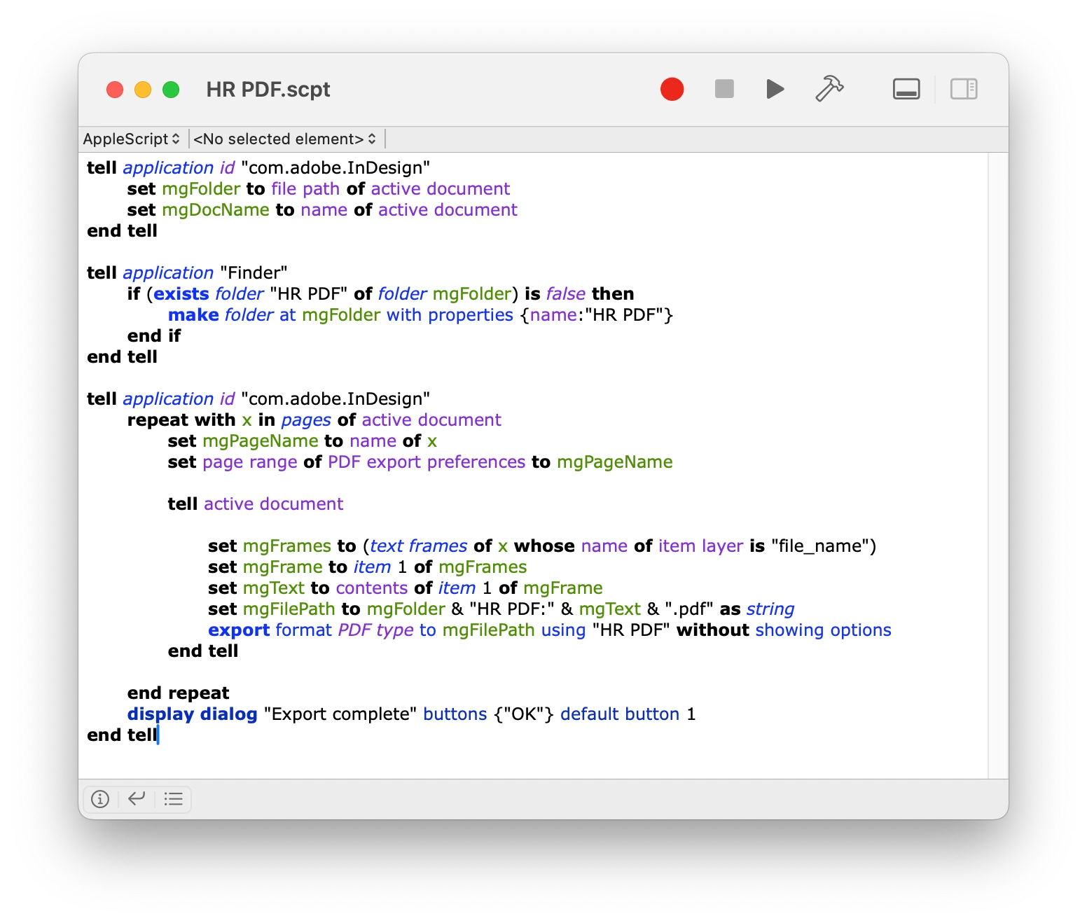

leo.r
leo.rCorrect answer
Mar 6, 2025 12:42 AM UTC
I think i might be in way over my head here as I have no idea what to do with that i'm sorry.
quote
By @Luke25170286g4xv
In your particular script, all you need to do is change
export format PDF type to mgFilePath using "HR PDF" without showing options
to
export format PDF type to (POSIX path of mgFilePath) using "HR PDF" without showing options
57 replies
Mar 5, 2025 10:25 PM UTC
Hi all, apologies for tagging along with this post but i'm also having a similar problem since updating to Indesign 2025 (v20). We run a script which outputs indiviual pdf pages from a multi page document, named using a specific filename on a seperate layer into a HR Folder in the same folder location as the active indesign doc. This has worked for years prior, and still does with Indesign 2024 so just wondering what the fix could be here? Currently holding back on full update to 2025 but with a lot of other colleagues starting to update it's becomming a bit of a problem.
I run the script and it still runs as it should without any error messages however, in the HR PDF folder that it creates it is always empty with no PDF exported? Any help would be massively appreciated. Script we're using is attached below for ref - thank you!
Robert at ID-Tasker
Mar 5, 2025 10:29 PM UTC
Mar 5, 2025 10:54 PM UTC
Thanks @Robert at ID-Tasker , explains it clearly for a novice like myself to understand! So knowing that, is there a way to adjust/tweak the current script for it to work in POSIX path Style at all?
LawtonKAR
LawtonKARAuthor
Oct 16, 2024 5:50 AM UTC
The probelm is that InDesign isn't producing the PDF's.
I have removed the last part of the code, this elimates the error code, because it can't find the PDF's on the desktop.
Looking at other comments about paths need changing, this line may be the problem
'set _dest to path to desktop as string'.
Can anyone advise how the path should be up dated to work in v20.0.
