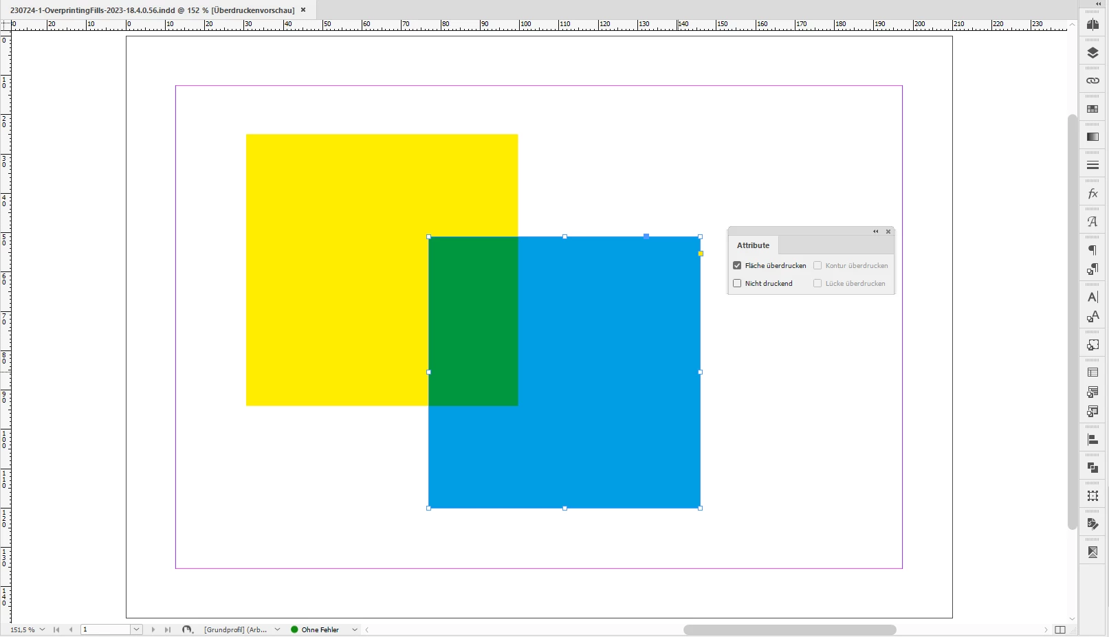

[1] Two rectangles on the page, one filled with "Yellow", the other one stacked upon with "Cyan".
The "Cyan" one has a fill with overprint enabled. So that with Overprint Preview you'll get a green in the overlap area like that:

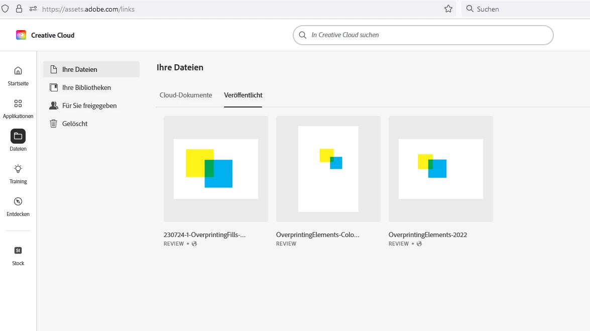

When I look into the Links section of my Creative Cloud the preview of that document looks OK:

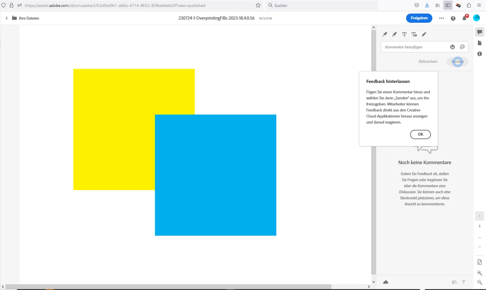

But the published review is missing the overprint:

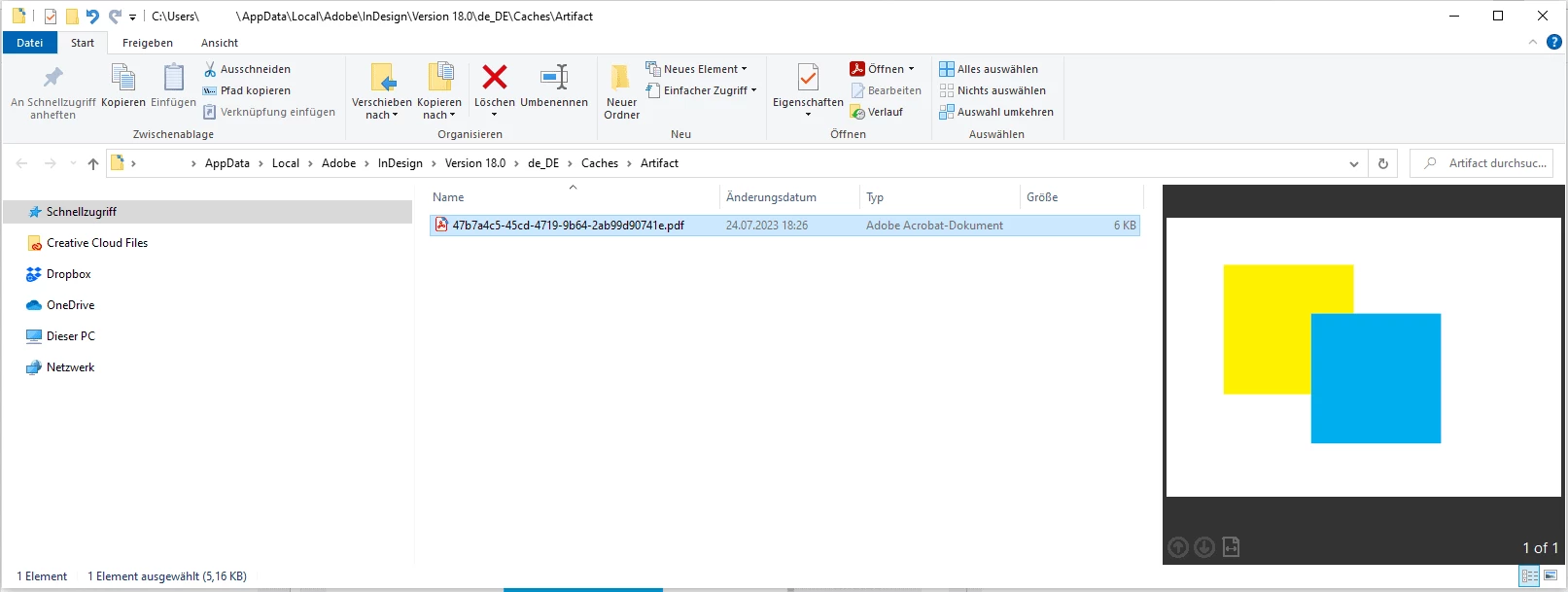

[*] And here we have it, the "artifact" that is temporarily stored in a subfolder of my User folder on my machine:
So, something similar happened to your document; only that there is an visible error with perhaps color management on the review showing up on the web. Hm. What kind of color management are you using with that document? Could you share a sample document packaged? Put it on Dropbox, WeTransfer or a similar service and share the download link so that we can see into more details.
