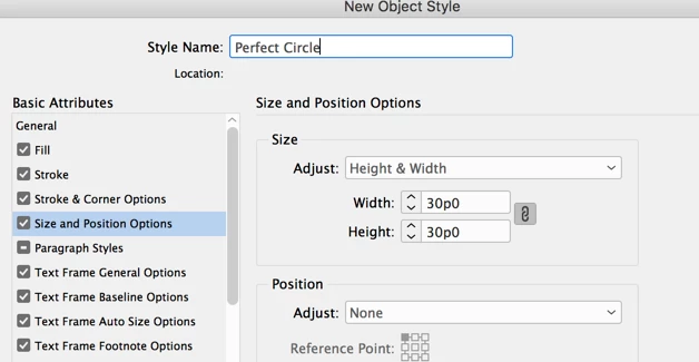

    AnneMarie Concepcion
    Mar 21, 2018 8:59 PM UTC
    1) Try this sequence: select the frame tool, then hold down the Shift key first before you drag, and release the Shift key after you release the mouse. First in, Last out. (Ditto for resizing a circular frame. Shouldn't be necessary but sometimes helps.)
    or
    2) Select the circular frame w/the Selection tool and resize it from the keyboard: Command-> (the greater-than symbol above the period) scales up the image and the frame itself proportionately; Command-< (the comma key) scales it down. Add the Option key to scale in greater increments. (On Windows, Command is the Control key, Option is the Alt key.)
    or
    3) if the circle is not a perfect circle, make it so by giving it equal measures in Width and Height in the Control panel.
    or
    4) If you're using InDesign CC 2018, you can make an Object Style that creates a perfect circular frame (at your standard size or just a starting size), then just apply that style to your bad boys. Use one of the above methods to resize it afterwards, if your circle frames are at diff sizes in the file.
