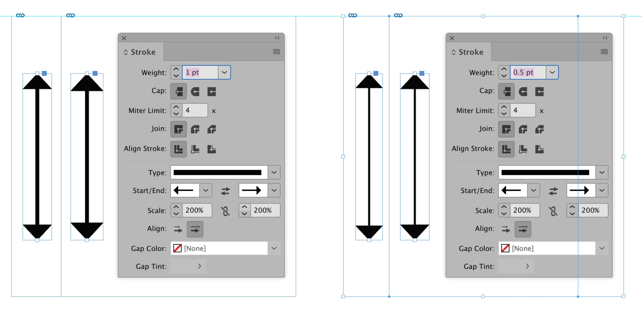

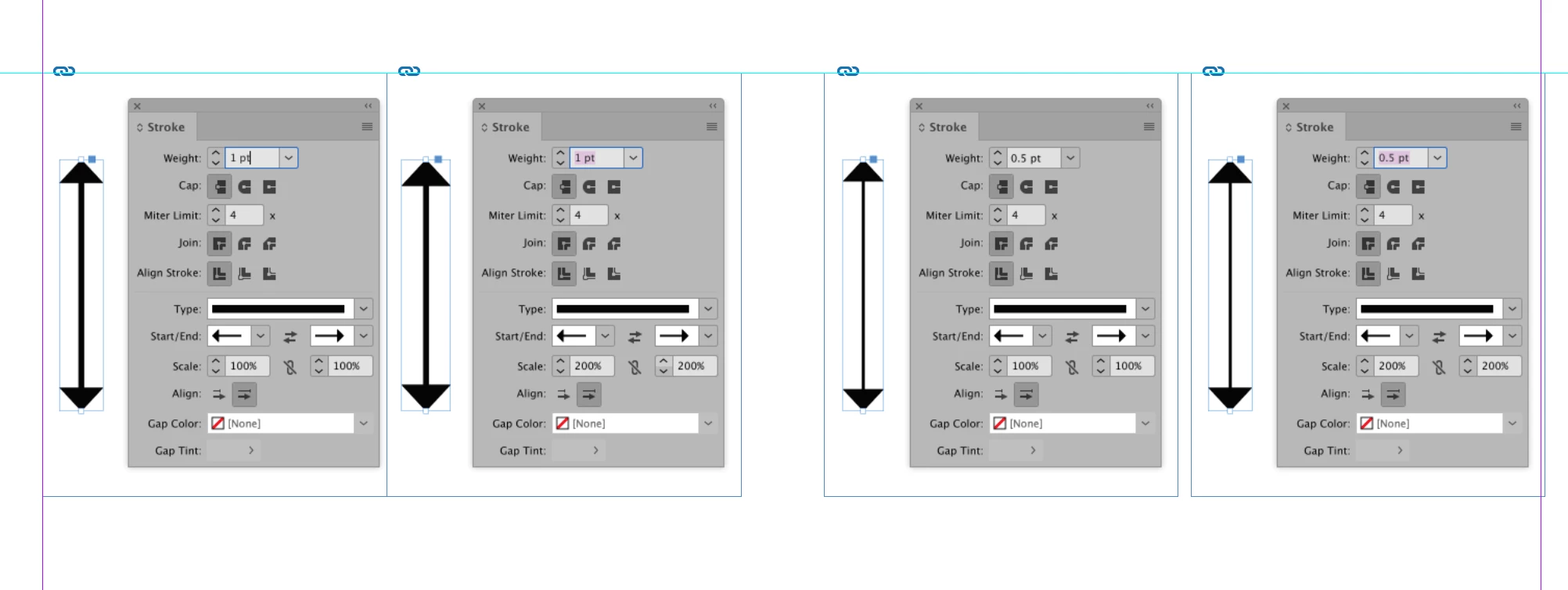

Steve Werner
July 5, 2019
It appears to be working for me with macOS 10.14.5 and InDesign CC 2019 14.0.2:
I moved them screen captures on top of each other so you could see them better side-by-side.
Here are the settings for the four screen captures:
