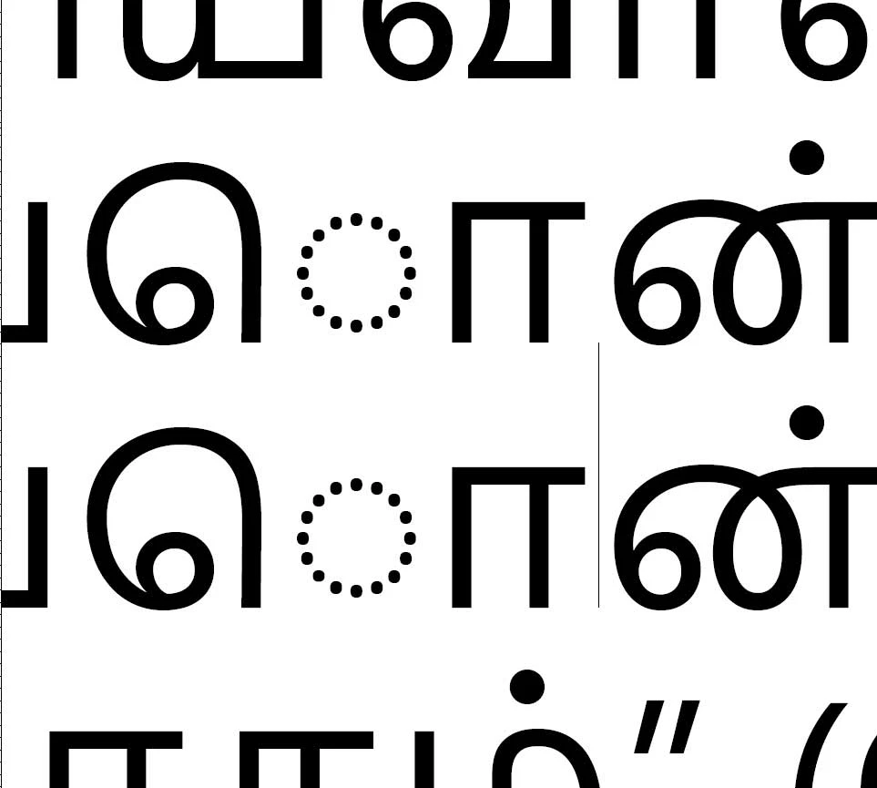

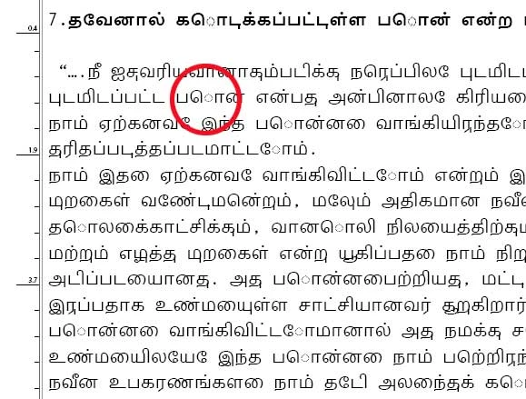

I'm having trouble using Tamil fonts in ID CS3 (Win10). The glyphs get mixed up and an odd character is placed between the transposed characters, I suppose indicating that something unkind has happened to the ligature.  It's probably something to do with Unicode fonts (which I don't understand at all!). I'm using the Nirmala UI font.

That dotted-line circle is a substitution that occurs when glyphs are supposed to combine. Usually, to when working with complex-script fonts, our first question is "Have you turned on the World-Ready Composer?" But you don't have access to that in CS3. Nirmala UI would not work on Pagemaker, either. Back then we used pre-Unicode fonts with custom encodings.
Ancient software may be the problem — but, what was used prior to CS6 (or whatever is current) before even CS3.
If your Tamil text is keyed in Nirmala UI, going back to ancient software won't help, either. If you have to use CS3, you are most likely going to need to have the text rekeyed (or converted to e.g. Bamini proprietary encoding, and then re-checked by someone literate to find any conversion artifacts) and then set it in some other font.
