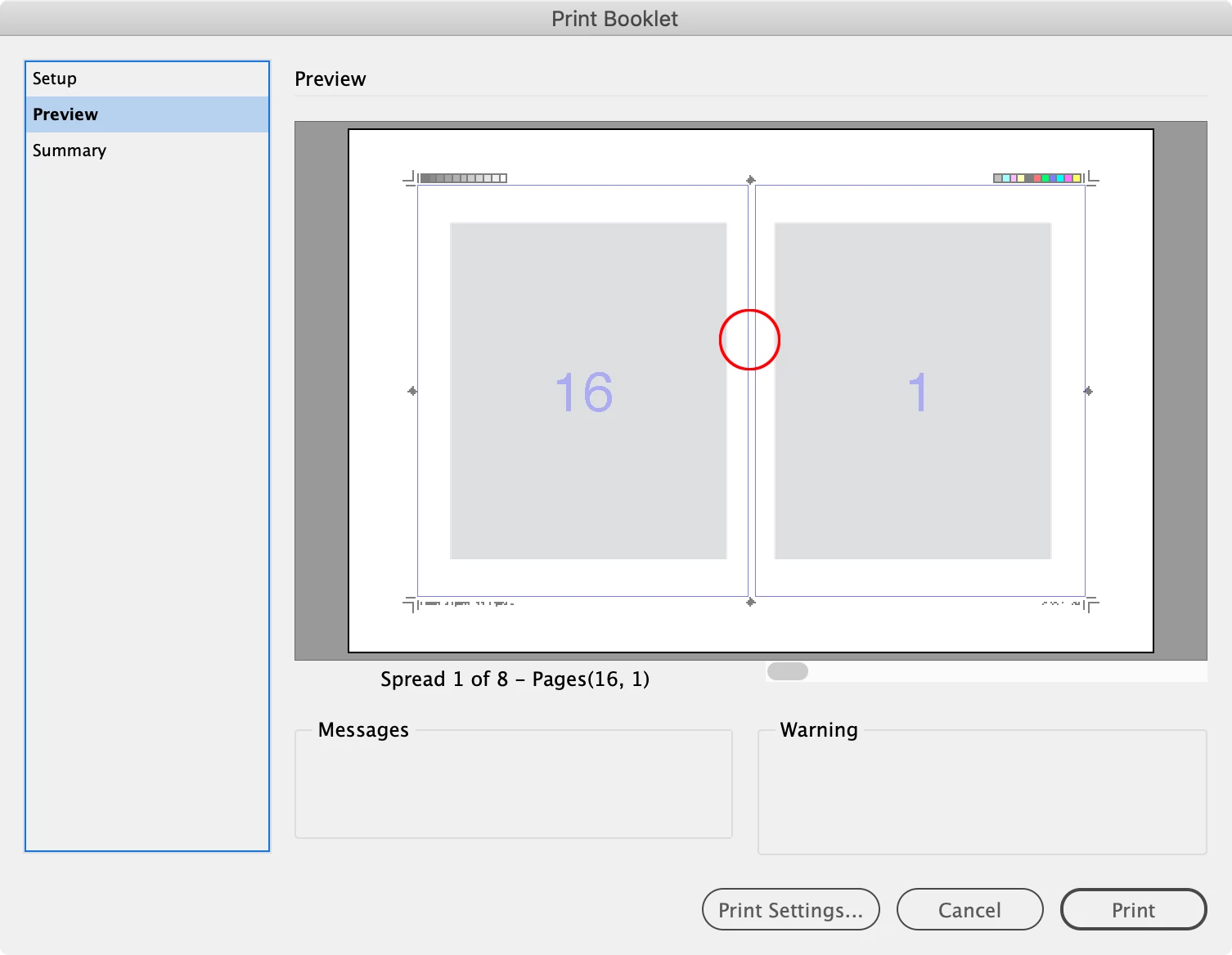

Hi @Typothalamus , You are referring to binding creep, which should be handled by the printer during imposition and not included in the page layout:
Even Indesign’s primative Print Booklet imposition feature includes a creep allowance.
And assuming a creep allowance, 12 mm does not seem like enough for a hardcover’s  inside margin. You might find an old hardcover book, take it apart and measure the inside margins when the spread sheets are flat.

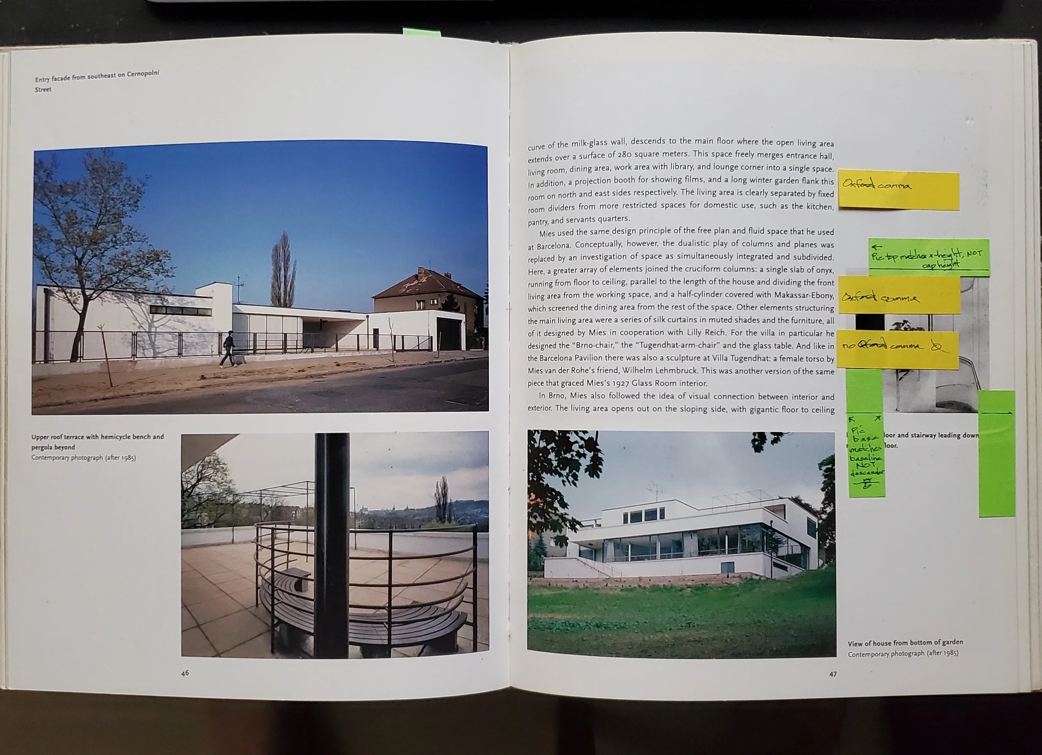

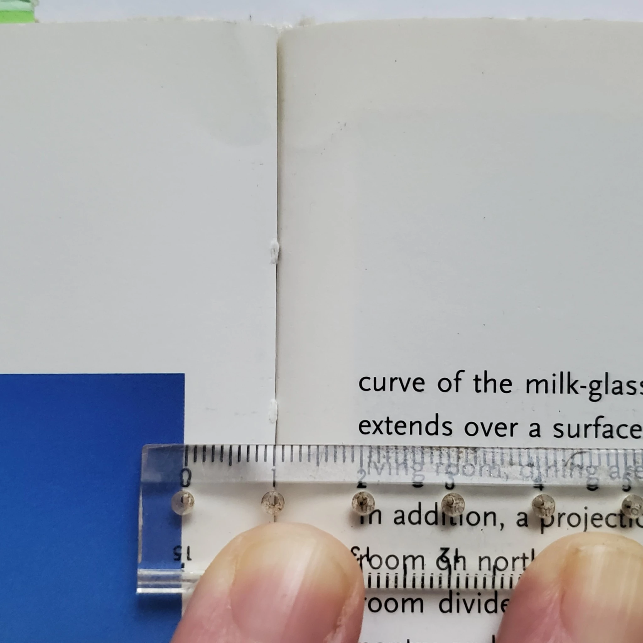

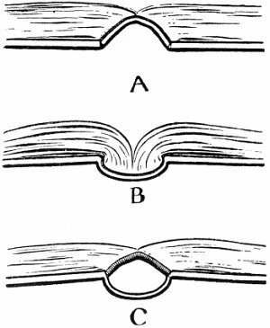

Thank you – the design was modelled upon Taschen's successful budget series and is quite similar in many respects. These as you see below actually have a 1 cm inner margin. They’re of the same format size, binding, and construction type – hardback with hollowback spine, sewn. Hollowback enables opening reasonably flat, as in the diagram below labled "C."   However, Taschen’s budget series is typically around 100 pp., which I suspect, along with their very specific construction style, allows for that even narrower margin to work. Is binding creep or gutter creep less critical in a shorter volume?
I gave ours more leeway at the start, increasing the inner margin to 12mm. It was anticipated that the printer handles imposition and creep by compensating, adding more material to a point. But I'd be open to destorying our Taschen workhorse copy to measure the inside sheet flat.
