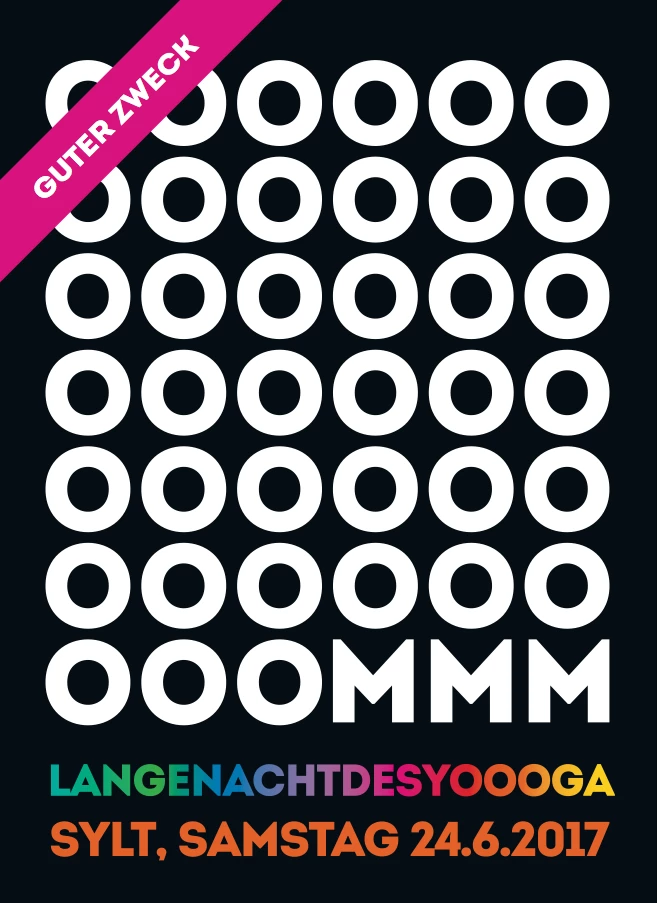

Help... I designed a booklet and sent a test to the printers. Something is wrong with the trap settings. That is how far I got with my reasearch on the web. Here is the problem:
Some sample pages from the booklet. This is waht they looked like in the PDF on screen:

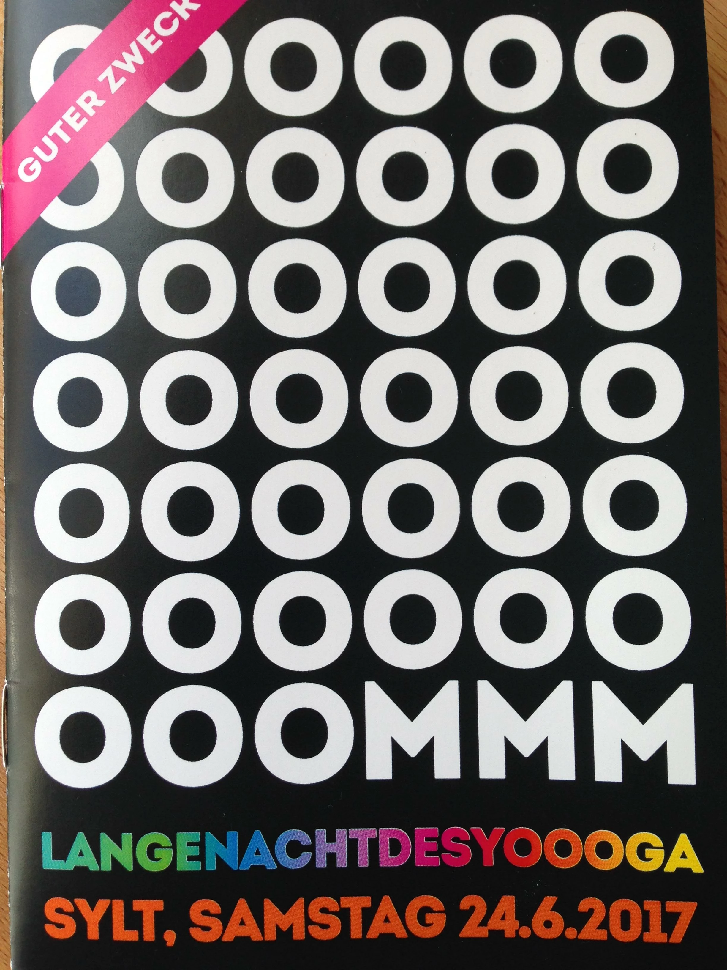

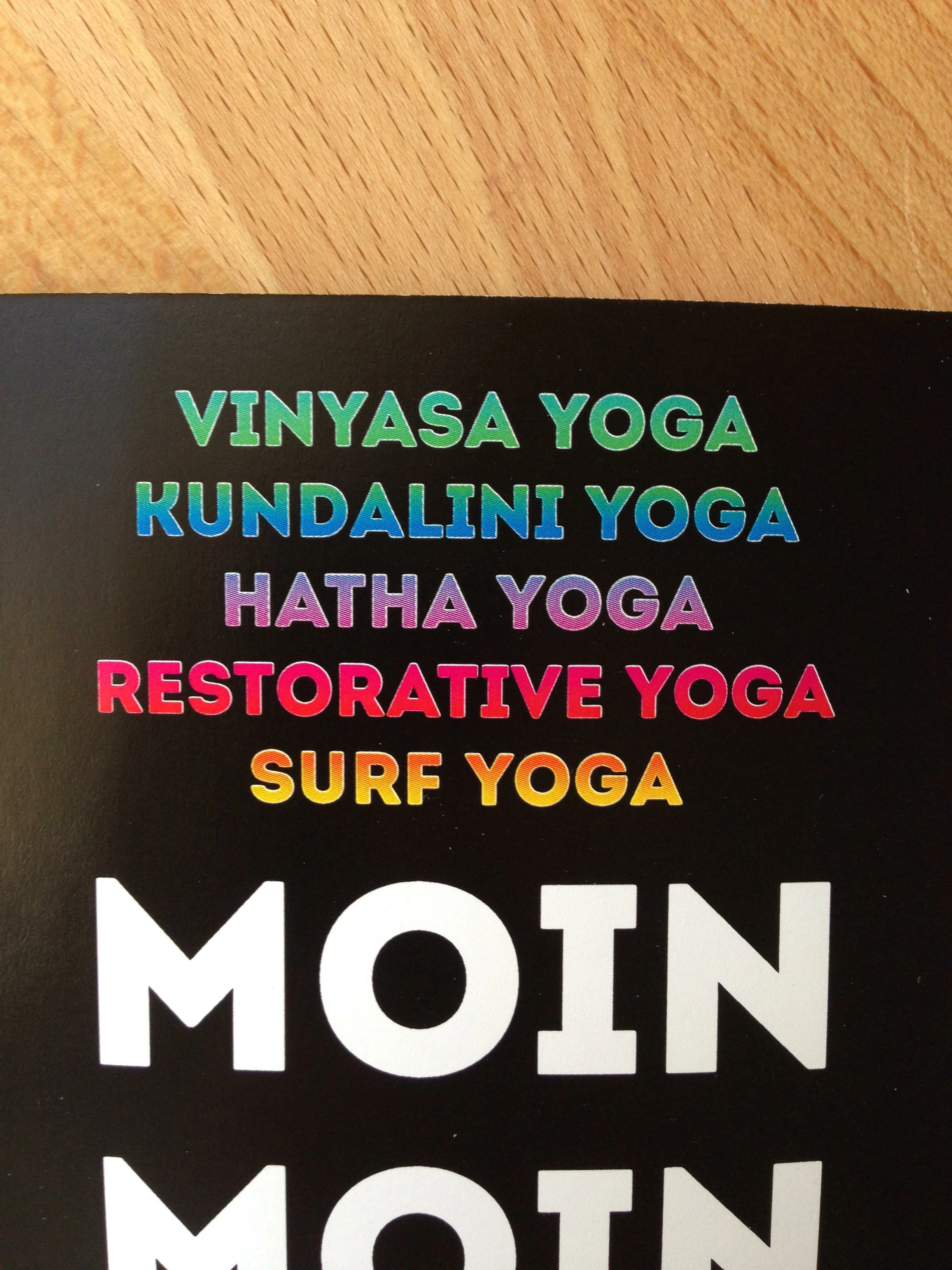

And here are pictures of what they looked like when the test came back from the printer:
The problem is the white gaps between the colored text and the black background. Sort of like Halos. Not so attractive.
It has somethign to do with the settings in this box it seems:
But what exactly is it that needs to change so that the colored texts overlaps into the black and doesn't cause more harm?

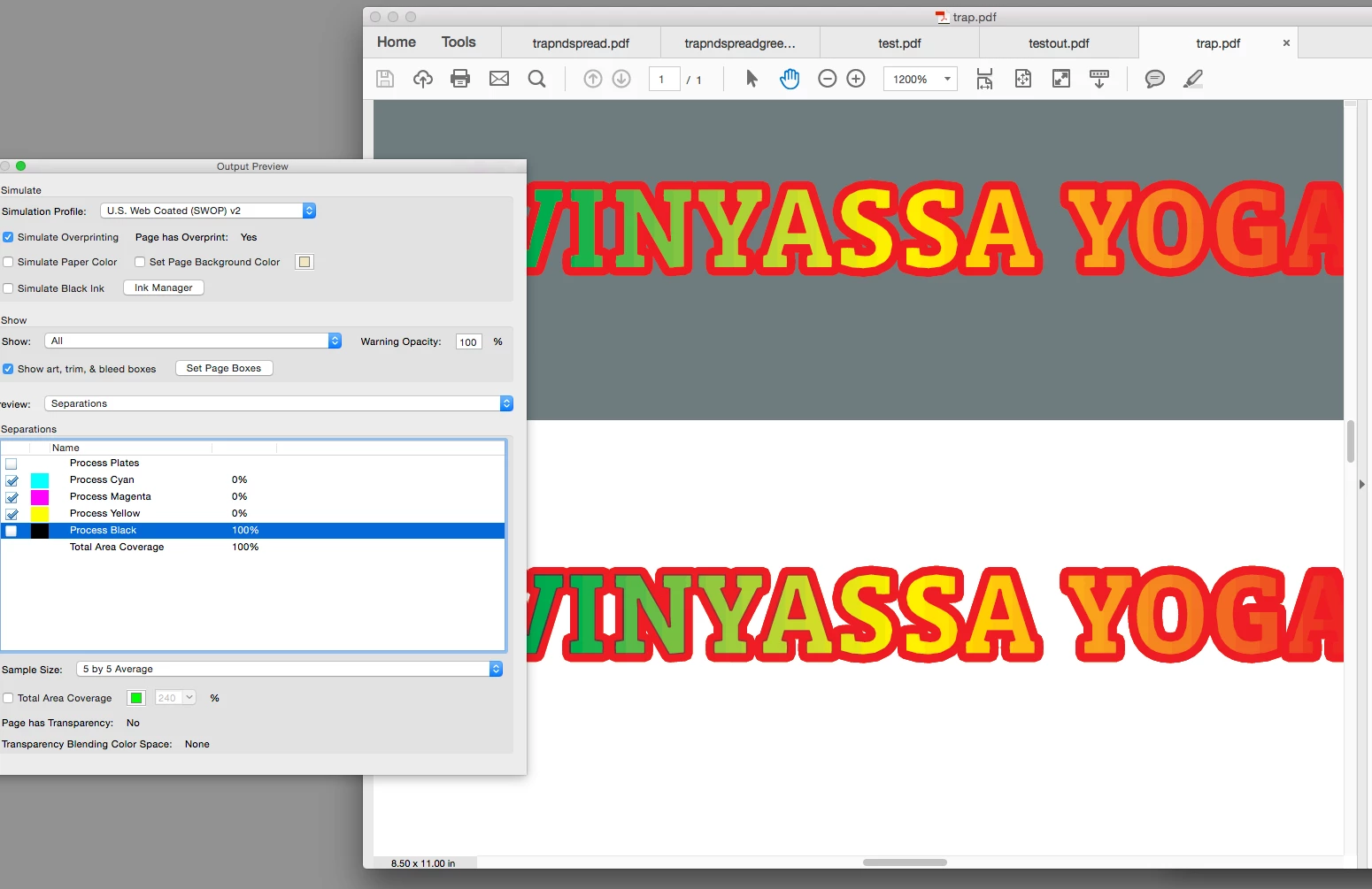

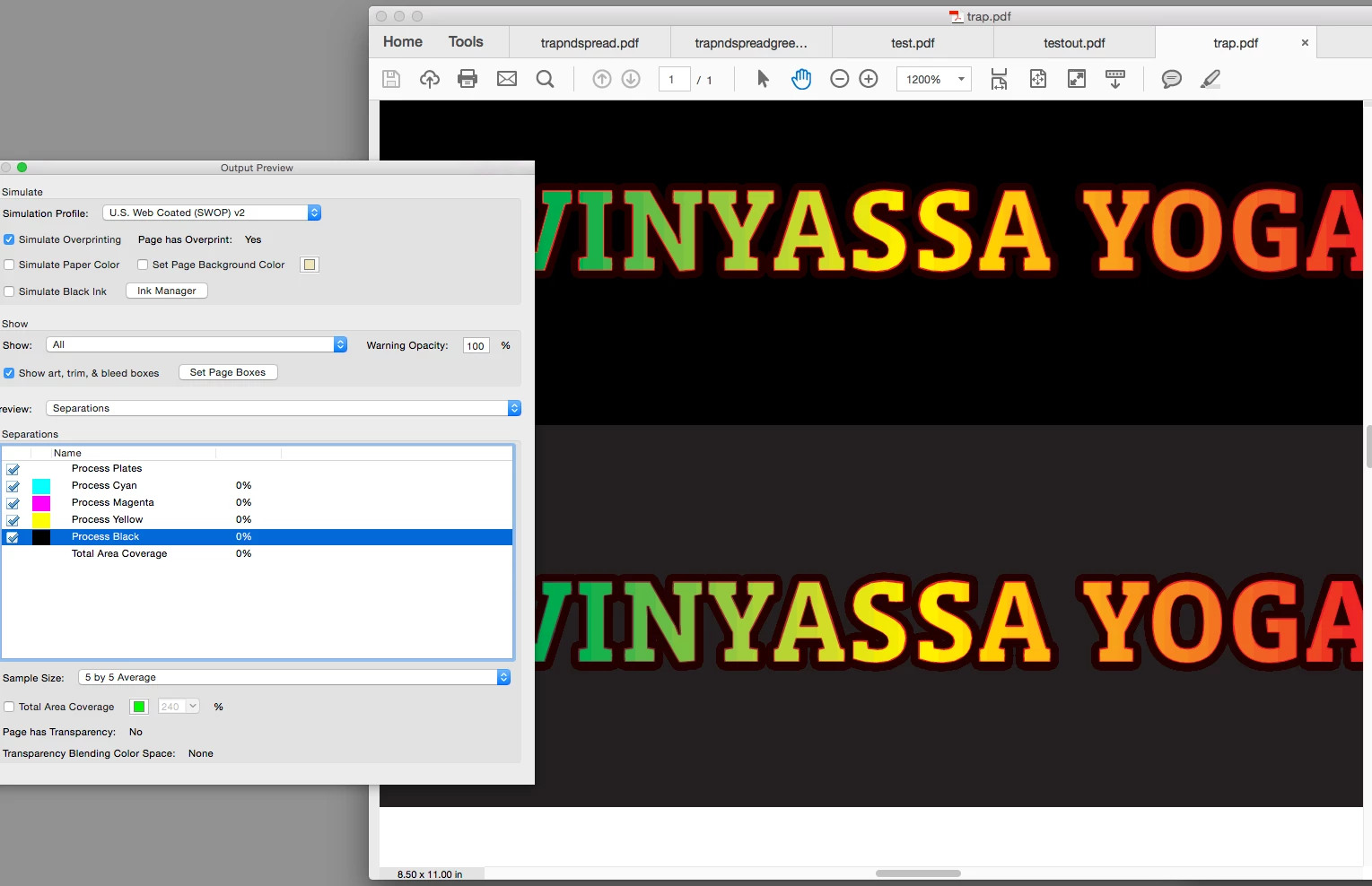

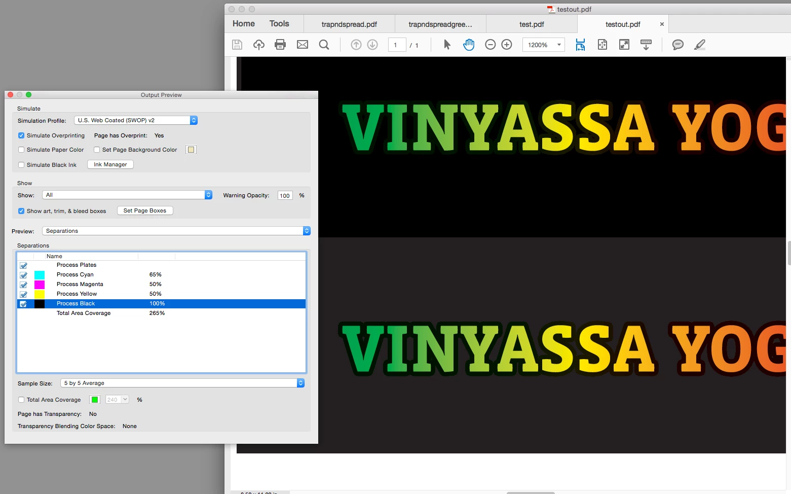

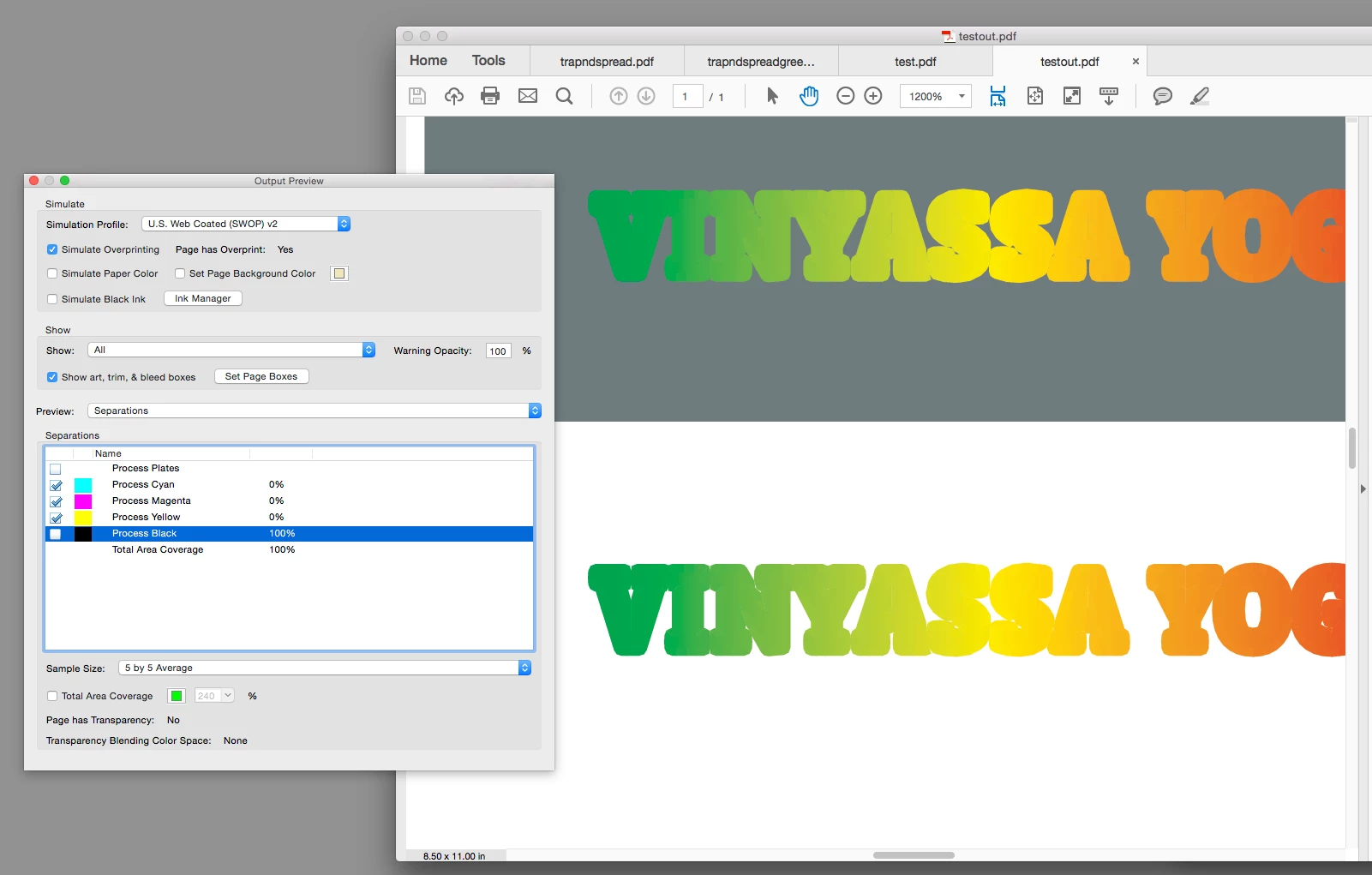

    I'm not sure if this relates to your problem, but it looks like InDesign's (and maybe Acrobat's) built-in trapping has a problem with gradient's applied to text. So, you can print a postscript file using Output>In-RIP Separations and distill an InDesign file that includes traps.
    Here's what happens with text filled with a gradient using InDesign's trapping defaults—I'm setting small text so we can see the traps—seems like a bug:
    If I convert the text to outlines the trapping works as expected:
    Trapping really is the printer's responsibility, but if they can't solve the problem you could try converting the text to outlines either in InDesign or in the exported PDF

    InDesign's built in trapping only works when printing directly from InDesign–you can't export a trapped document. AcrobatPro works the same way Acrobat's trap settings are applied when the document is printed, so even if you wanted to control trapping from your end you couldn't do it via a PDF export.
    Looking at your photo it looks more like a white stroke than a missing trap—the white outline around "YOGA" is too consistent to be a trapping problem. Can you share the PDF that was sent to the printer?

    Thank you Frans and Rob. The printer says it is not their Problem. Neither is there a white stroke around the letters. It appears every time throught all the docs for all 8 Cities that I am making these booklets for. I have contacted 3 printers and they all say the same.
    The PDF versions are the first 2 pictures in my original post. As you can see there is no white stroking going on.
    But if the PDF has no stroke, the white outline is being introduced in their output—I assume the white doesn't show in a composite proof? If the printer is using Adobe's trap engine try running a test with the text as outlines.

    You should leave trapping to the printer. If you deliver a PDF this will be done in RIP by the printer. That said: it looks like your black is a Rich Black, not only K. In that case keep away kicks in, or at least it should. I see this as the printers fault, not yours. Ask for a reprint.
