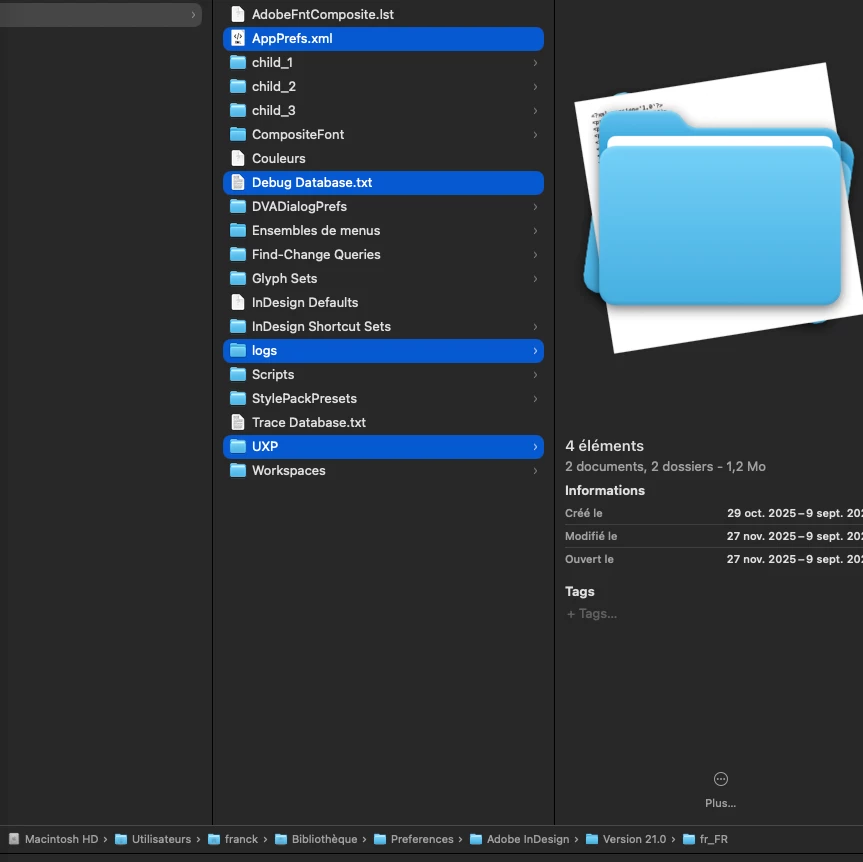

J’ai une solution qui pour l’instant marche.
J’ai essayé
  • -’d'abord d’enlever dossiers dans la bibliothèque du système (certains dossiers d’application support, préférences en rapport avec Indesign… ) Désolé je sais plus lesquels
    ensuite dans le dossier bibliothèque de la session, certaines préferences (cf capture d’écran).
  • et redémarrer le Mac

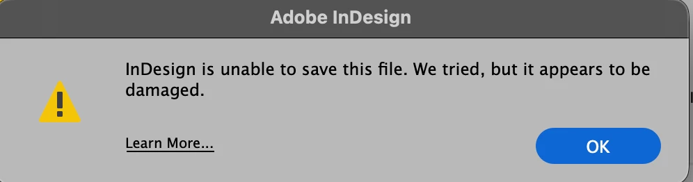

We had the same problem at our office, “InDesign is unable to save this file. We tried, but it appears to be damaged” and a 0 Kb dummy file.
I would recommend switching to an SMB-protocol and try again, this worked for our colleague.

Can open and save existing files, save .idlm-files but can’t save new files from InDesign. Need to save locally and move to server. Have added Full disk access to InDesign. Tried installing InDesign 20.5.5. Same problem. “InDesign is unable to save this file. We tried, but it appears to be damaged.” Then it leaves a 0 Kb dummy file.
Macbook Pro M5 Pro
Macos 26.6.2
InDesign 21.5.1
Connecting to an afp-server.

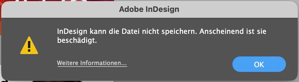

We have the same Issue! In the past working, saving, opening from NAS worked 99% of the time. We have TB of files on NAS
  • now “save as” is not working anymore saying “Indesign cannot save this file. File seems to be damaged.” I only see then a 0 byte file on the NAS
  • Copying the file to NAS is working
  • Opening from NAS is working
  • Saving on NAS is working
  • BUT “save as” to NAS is NOT working
MacOS: 26.6.1
Adobe: 21.5.1
