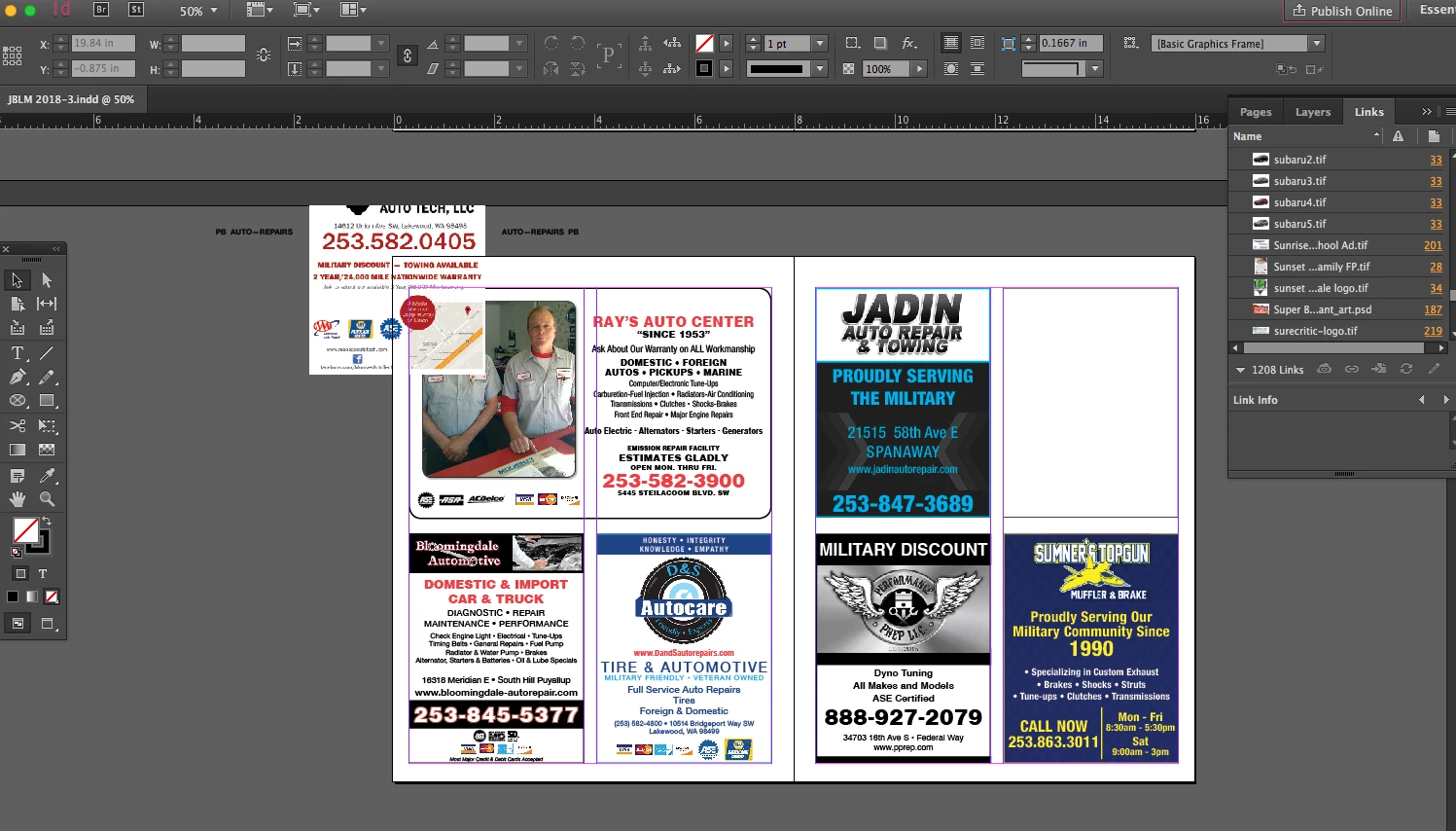

Panic Mode! I need an InDesign expert! After running a CC Update and reopening an InDesign file, half of my linked images have now "disappeared" into the pasteboard somewhere. In the image above, the tiny cyan square in the middle of the spread shows where my linked image apparently is (see the links panel on the right), but it's registering as on the pasteboard, and I can't grab it or resize it or anything. About half the ads in my 240 page document are "gone" like this... does anyone know what happened and how to fix it??? PLEASE?????

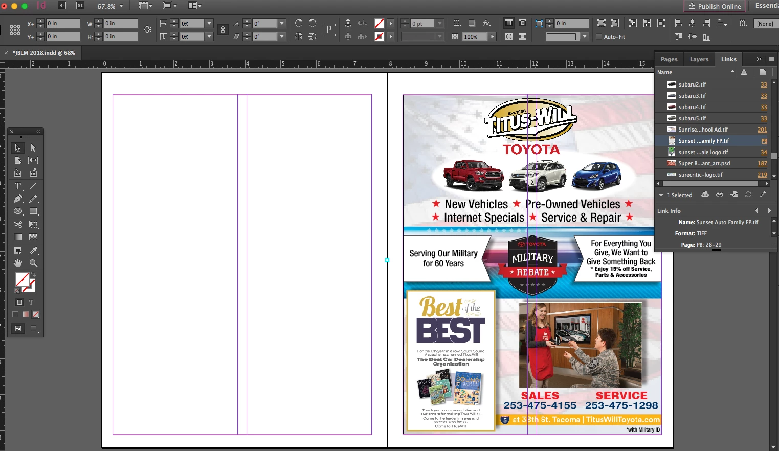

Things keep getting curiouser and curiouser. Now that I'm trying to manually repair everything, it appears that something occurred where a few linked images were selected at random, and they "grew" vertically so that they took over several spreads (as oriented in the pages panel). Because those linked images were text wrapped, they knocked out some of the images above them... or something like that. It isn't the only problem, but it appears to be one of the problems. I have no idea what happened, but it was definitely a glitch of sorts. I got a flash of a warning dialog when the Creative Cloud Installer was updating that said something was corrupt, but it was there and gone so quickly I couldn't see what it was warning me about.

I did... no luck. The best workaround I've found so far was Bob's suggestion to export to IDML.... which, although it restored most of the links, scrambled and resized a bunch of things, and created bizarrely huge object frames where there should be none. It's not ideal, but I can at least have something to work from as I go through and manually repair all..... 242.... pages.... Please send coffee!

Bob Levine: IMDL Export "sort of" helped a bit... now I can at least see the images (at least some), but they are still oriented as if they were aligned to the top left of the page. Not on every spread, and not every image. It's very haphazard and with no rhyme or reason. Notice how one ad is off the pasteboard to the upper left corner, along with the folios? But the other ads are exactly where they should be.
Jane-e (nice Twin Peaks reference!): I can't resize them because I can't actually adjust the image at all. If I select it, and even just nudge it with the arrows, I get the "this would cause the object to leave the pasteboard" dialog box. I could probably replace all the images with fresh copies, but I'm under a tight deadline and there are literally hundreds.

January 8, 2018
