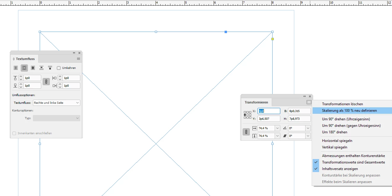

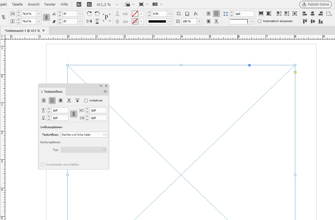

    Hi casinclaire ,
    that a 1-pica value is doing a 0p7.44 pica wrap around means that your frame is scaled.
    Select the frame and open your Transformation Panel. You can reset the scaling as 100%. Then a 1-pica value would return a 1-pica wrap.
    From my German InDesign CC 2018.1.
    1.pica text wrap value on a rectangle that is scaled to 74.4 %.
    The effective value is not one pica. The rulers are set to Pica.
    Transformation Panel. Redefining scaling to 100 %:

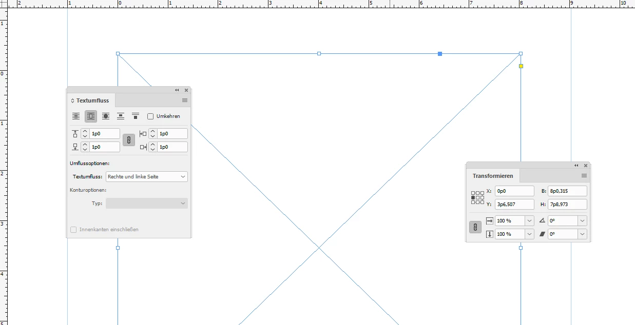

    Now the result of that action:
    Uwe

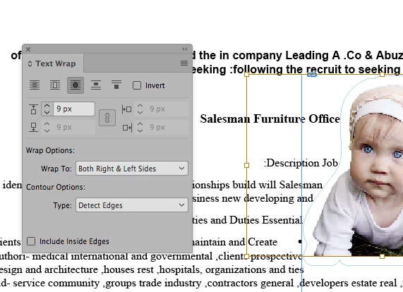

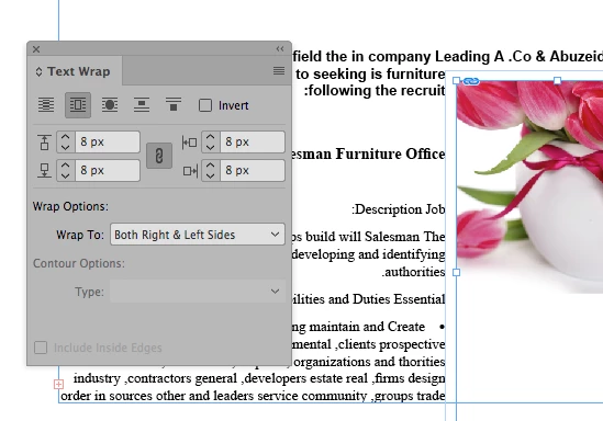

    If the image you want to Wrap the text around doesn't psd file you have to choose deduct edges.
    If you want to wrap to be around the bounding box
    With Black arrow choose the frame (not the image inside), just choose Wrap around bounding box. the second choice from left, so you will have the the options to change the top, bottom, left and right offset.
    If the Image you have imported has a transparent background or it is psd file.
    choose wrap around object shape, contour options: detect edges.

    Hi casinclaire ,
    Uwe
