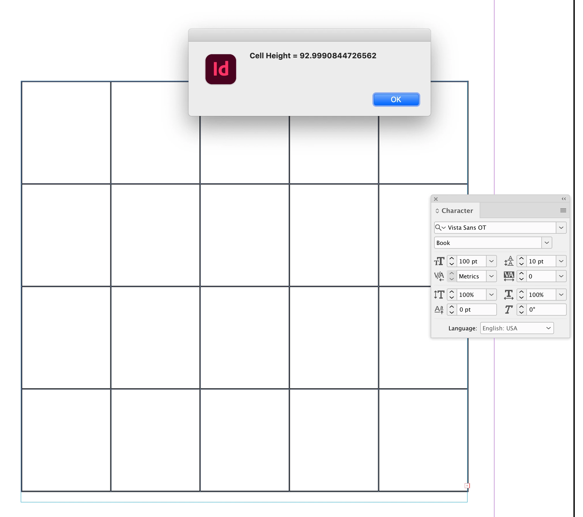

a slug is the approximate height of the highlighting in selected text
Seems like "approximate" is the operative word. If I set my default point size to 100 and the leading to anything, a new table’s cell height is 92.99 pts, which doesn’t seem to correspond to any combination of font metrics –point size, ascent+descent, capheight, etc—definately not leading:
Gotta love it...

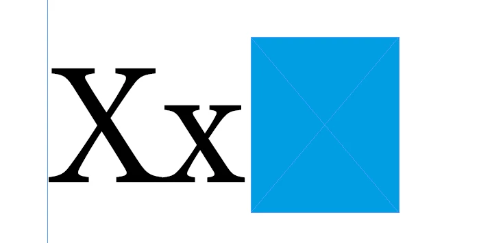

Interestingly, one of the options in anchored frame's Y-relative-to value is EMBOX. It's not exposed in the interface (unlike ascent, cap height, leading, and x-height). Looks as if it was once part of or intended to be part of the interface, but was abandoned was left in the scripting model.
Some expriments show that an anchored object's em-box height is the same as the font's type size. Its position is such that a character's cap heigh is centred in the box:
P.
