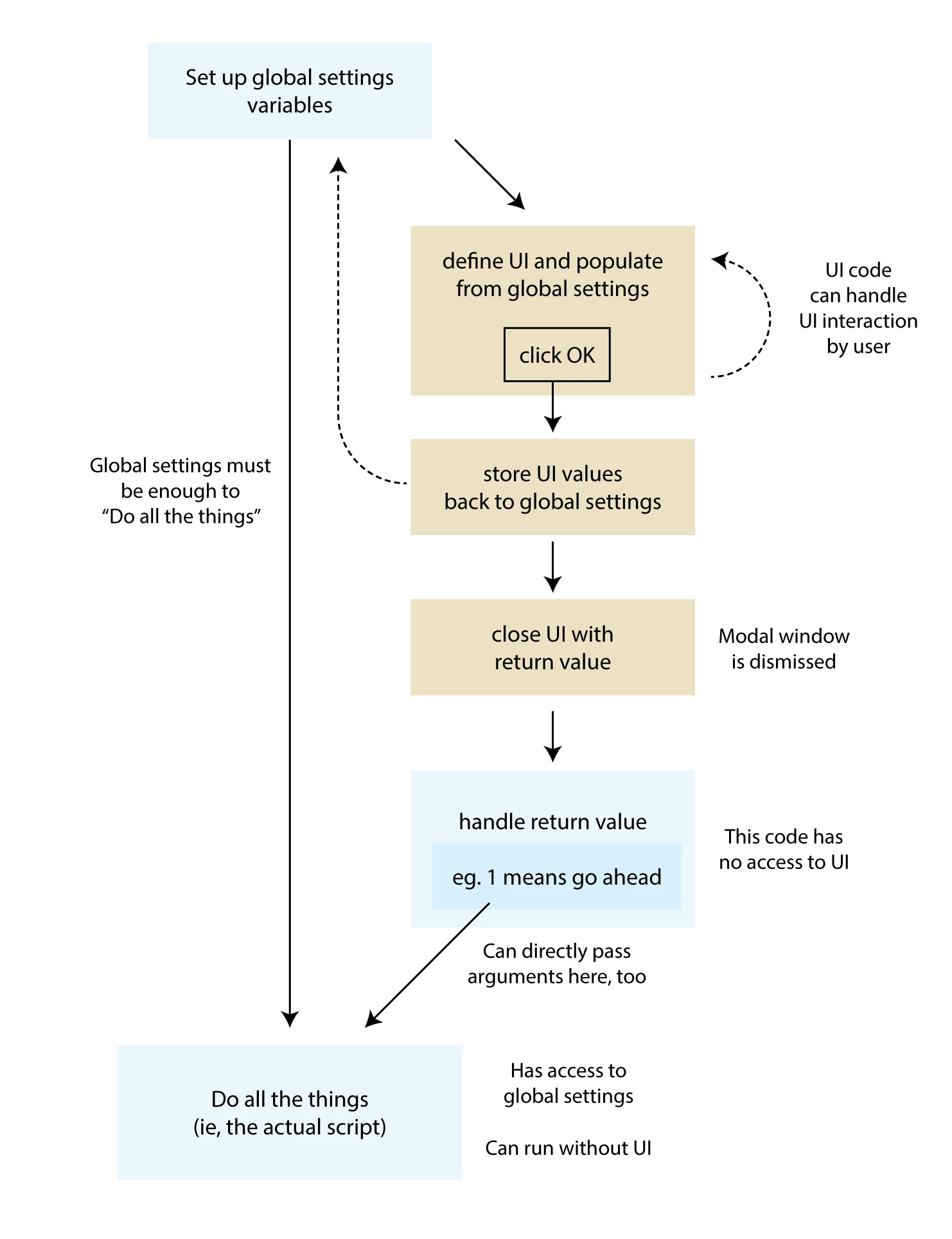

The correct answer of that thread is important. In Indesign, a scriptUI window is modal by default, which means in practice that you can't touch anything else until you've hit the OK button. But this can be difficult to understand due to the way scriptUI dialogs are usually implemented in our code. I recommend setting yourself the puzzle of separating the UI code from the "main engine" code. The test of success in this is if you can call your "main engine" with or without invoking the UI. This is very useful anyway because it means you can re-purpose your script to run in batch mode style, performing many repetitions using parameters that are fed to it via code.
Here's one way to structure this:
Edit: see actual example of this structure on my answer here.
