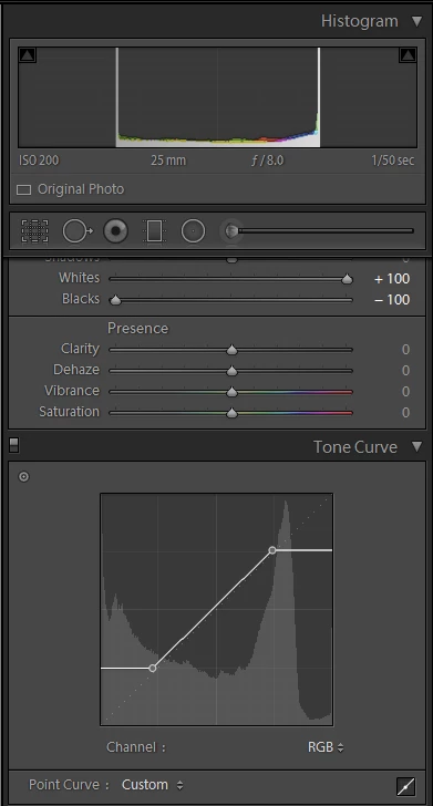

    The answer is in richardplondon's post earlier: Because the Tone Curve works with the range handed to it by the Basic panel. In other words, they are linked, but only one way, and not in the direction you want. For example, if you drag the Whites and Blacks sliders to limit the tonal range of the image, you can immediately see the histogram in the Tone Curve shift and clip. Because you can't set Tone Curve values beyond 0–100, you can't use the Tone Curve to recover tones beyond what it received from the Basic panel. If you want the Shadows slider to have more range, what you want to do is raise the Blacks level in the Basic panel.

    The Tone Curve is applied after the Basic panel Tone controls. To prove this move the Tone Curve end points vertically from the 0% and 100% and then try to reestablish the 0 and 100 clipping points using the Whites and Blacks controls in the Basic panel. It can't be done (see below). So it does matter in what order these controls are adjusted.
    No, it does not matter. Yes, the tone curve may be applied after the Basic tone controls. Nobody is saying otherwise. But that is not the point. The point is that this order is always the same, no matter in what order you did the edits. That is because the 'edits' are only a list in XMP, and when applying those edits Lightroom will go through the list in a fixed order, that you cannot change.
