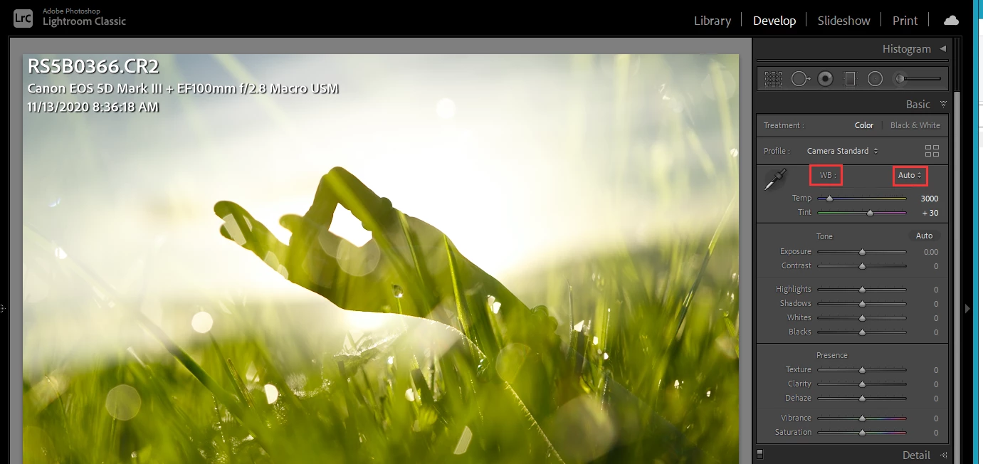

I imported your image into LR 5 and the First View was of a Greener image and then it changed to the yellow warmer version.
The first version, greener, is from the Embedded JPG image that is included in every RAW file. that embedded version take on whatever settings you had set in the camera. The yellow version Discards those setting and a Preview is built by Lr using only Raw Data.
In either LR 5 or LrC V10 if you set the WB to Auto you get back the Greener version.

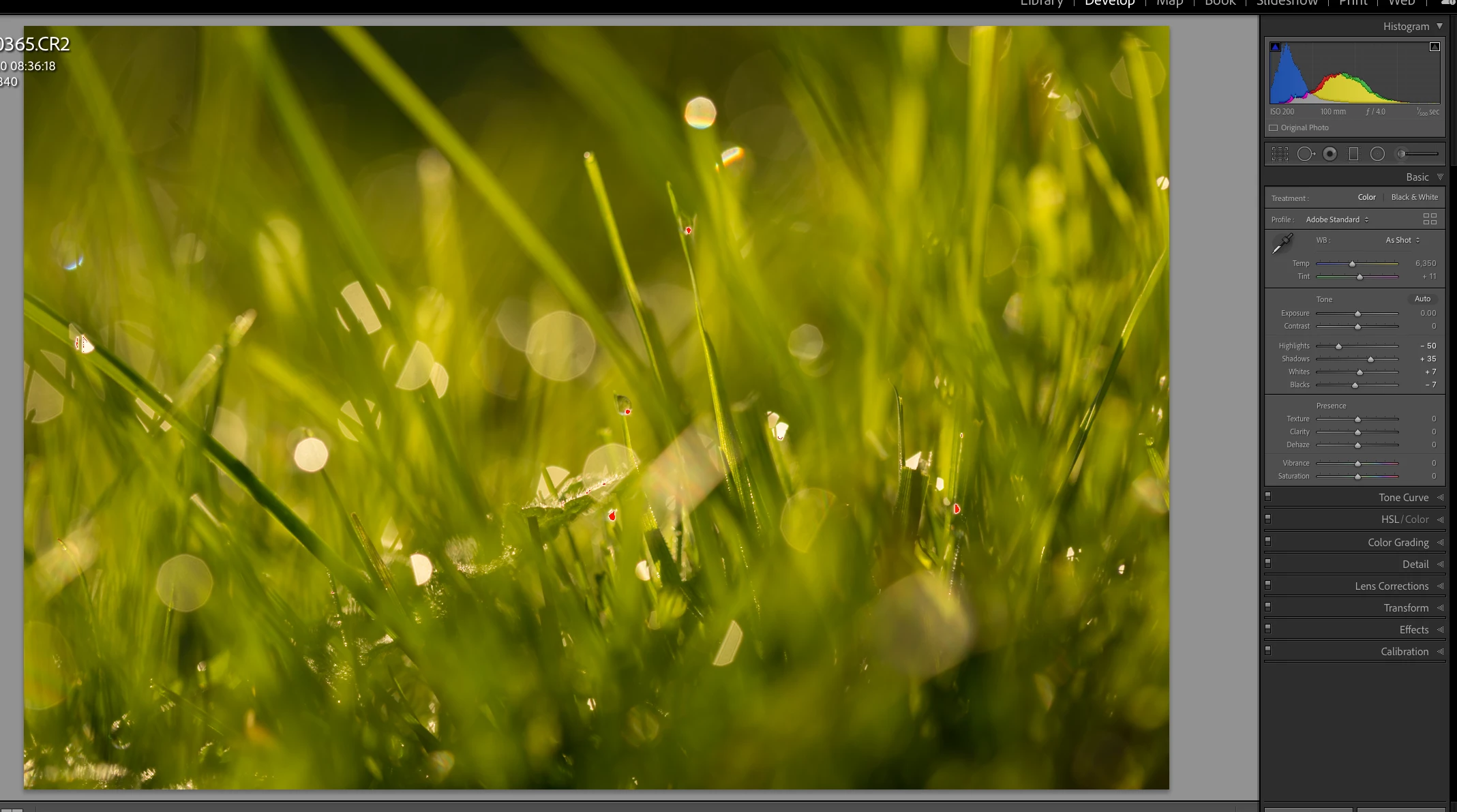

This is the image of the Grass:
The camera merges the 2 images together so that the underexposed areas of image 1 are filled by parts of image 2 creating a third image - the image below is SOOC and exported directly from Lightroom last week and these are the colours I would like to keep but at the time I only exported a low res version to show to a client as a proof.

The best suggestion I have had so far is to change the WB on the current file to Auto in Lightroom and this turns it fully Green.    I would prefer to find out what happened to my file (and all the other double exposure files) in lightroom so that I can prevent it happening again.

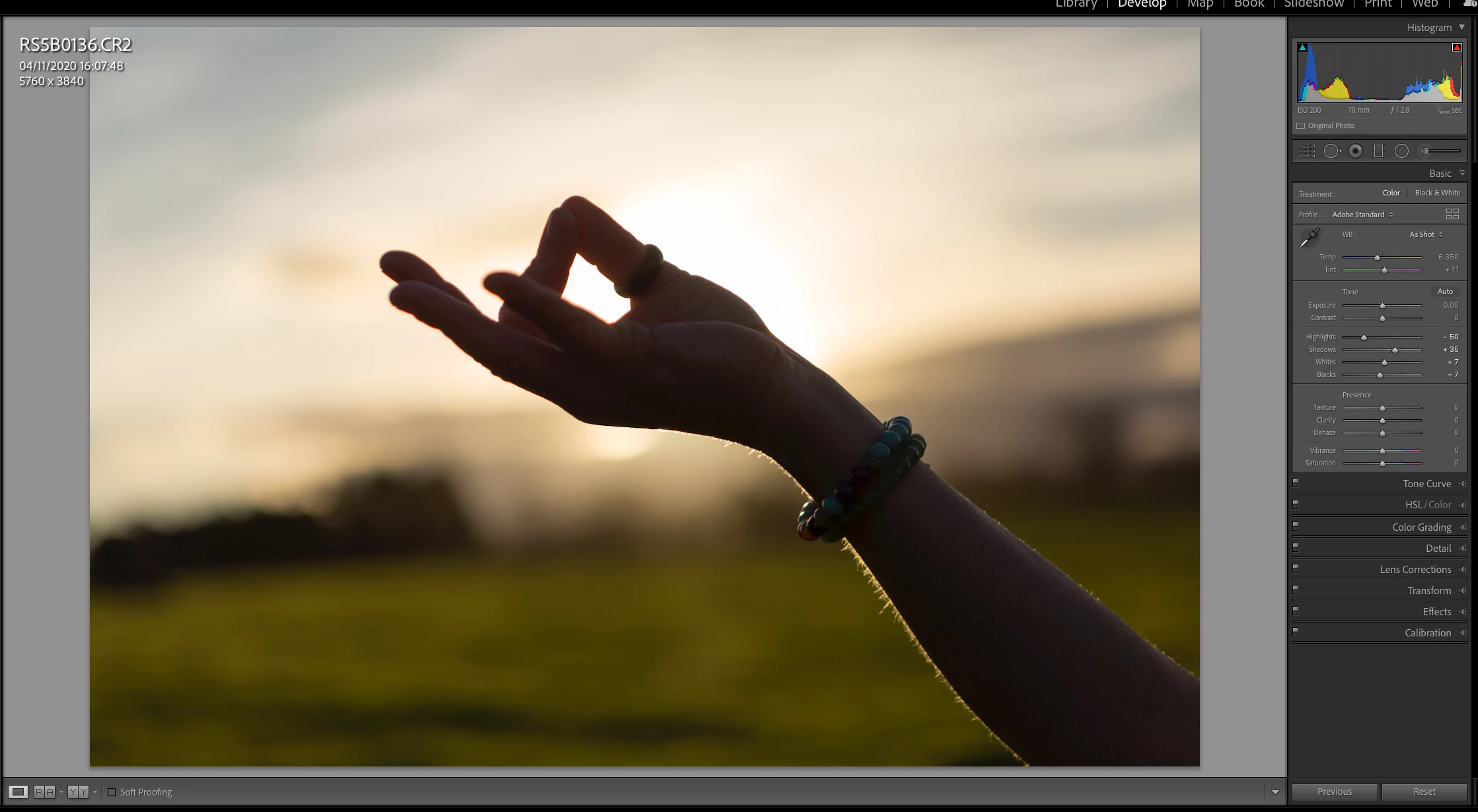

"Last week I made this double exposure of her hand, which was a silhouette and then double exposed it with dew on grass."

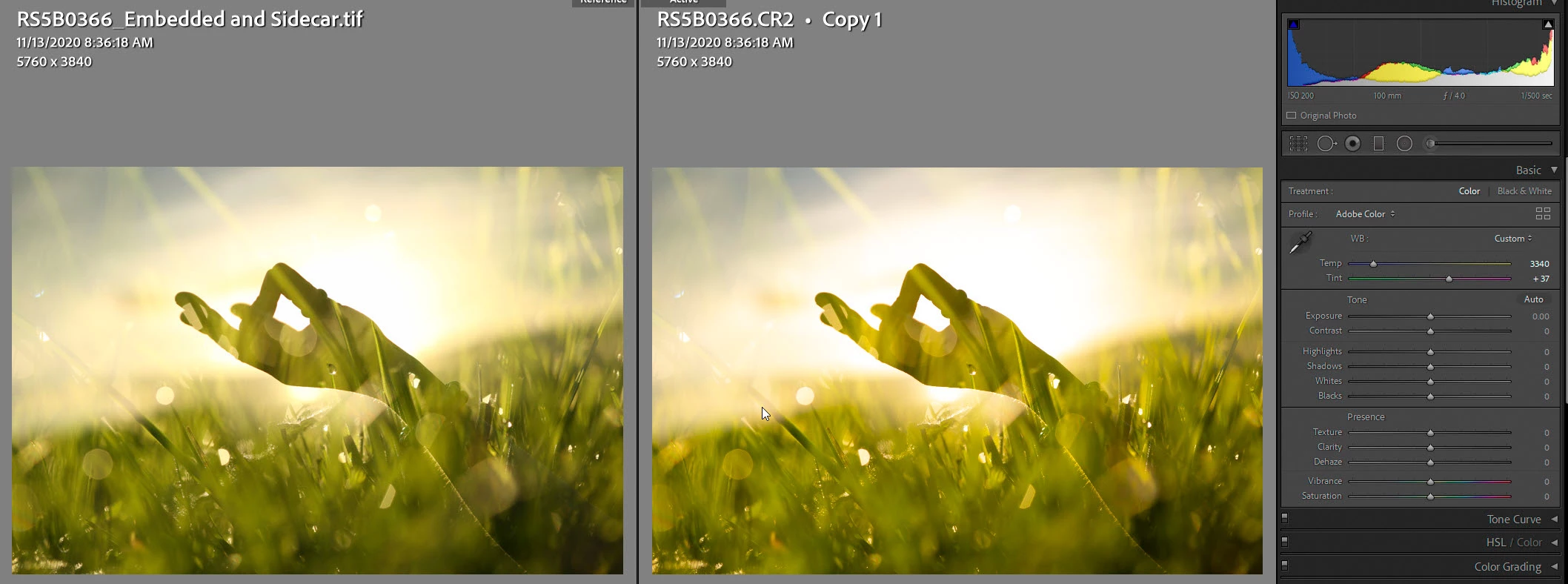

It appears you shot the hand picture with tungsten lighting and the grass picture with daylight. Since this is a double expsoure it appears the 2nd expsoure WB settings (Daylight) were recorded in the CR2 file As Shot settings. Here's the in-camera embedded JPEG image next to LrC image with WB adjusted. It looks better, but not exactly the same as the in-camera JPEG. I suggest in the future to use the same lighting source type for both exposures, which should fix the issue.
EDIT: If you select the Camera Standard Profile with the below WB settings (3340, +37) it looks very close to the in-camera JPEG.
