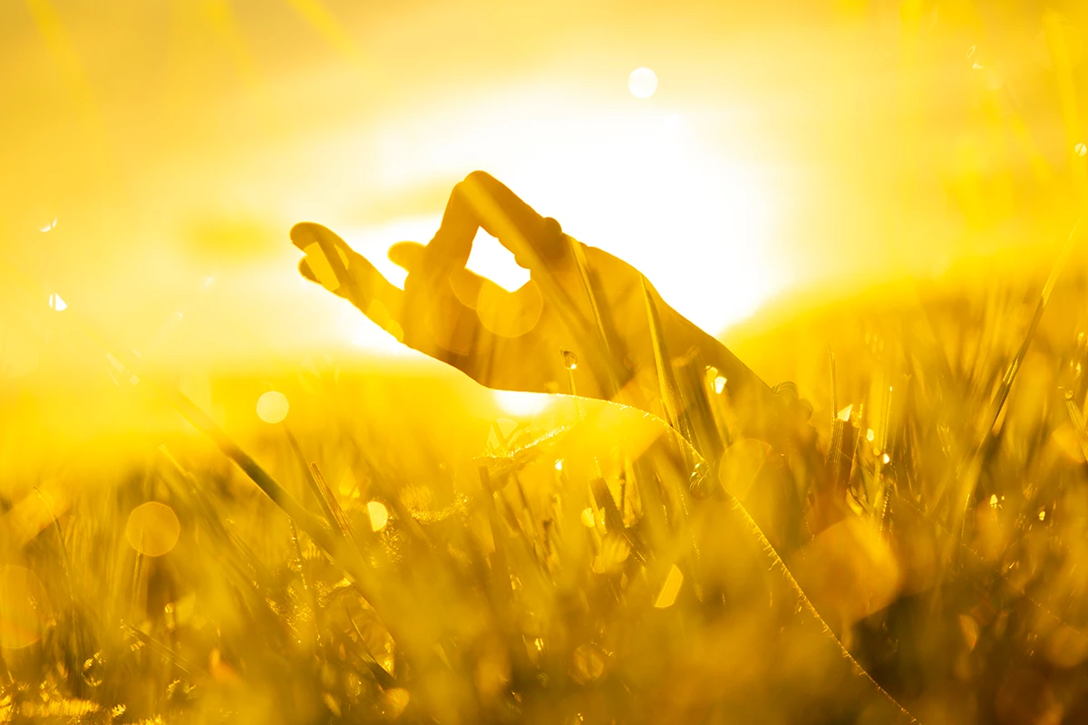

I was playing around with in-camera double exposures for a client who does yoga and mindfulness.  Last week I made this double exposure of her hand, which was a silhouette and then double exposed it with dew on grass.  It's not edited but it gives the idea.  I sent the green version to her to check that she likes the direction I am going with this and thats why I still have a low res copy.
My problem is that when I went back into LR Classic this week the colours in the raw file are not the original colours of green grass but funky yellow colours instead.  It's not an issue of screen calibration, this is something that has happened to the file.  The original in the folder on my Mac still looks fine but when I pulled it into Camera Raw to see if that would make a difference, the colours changed to the funky yellow too.

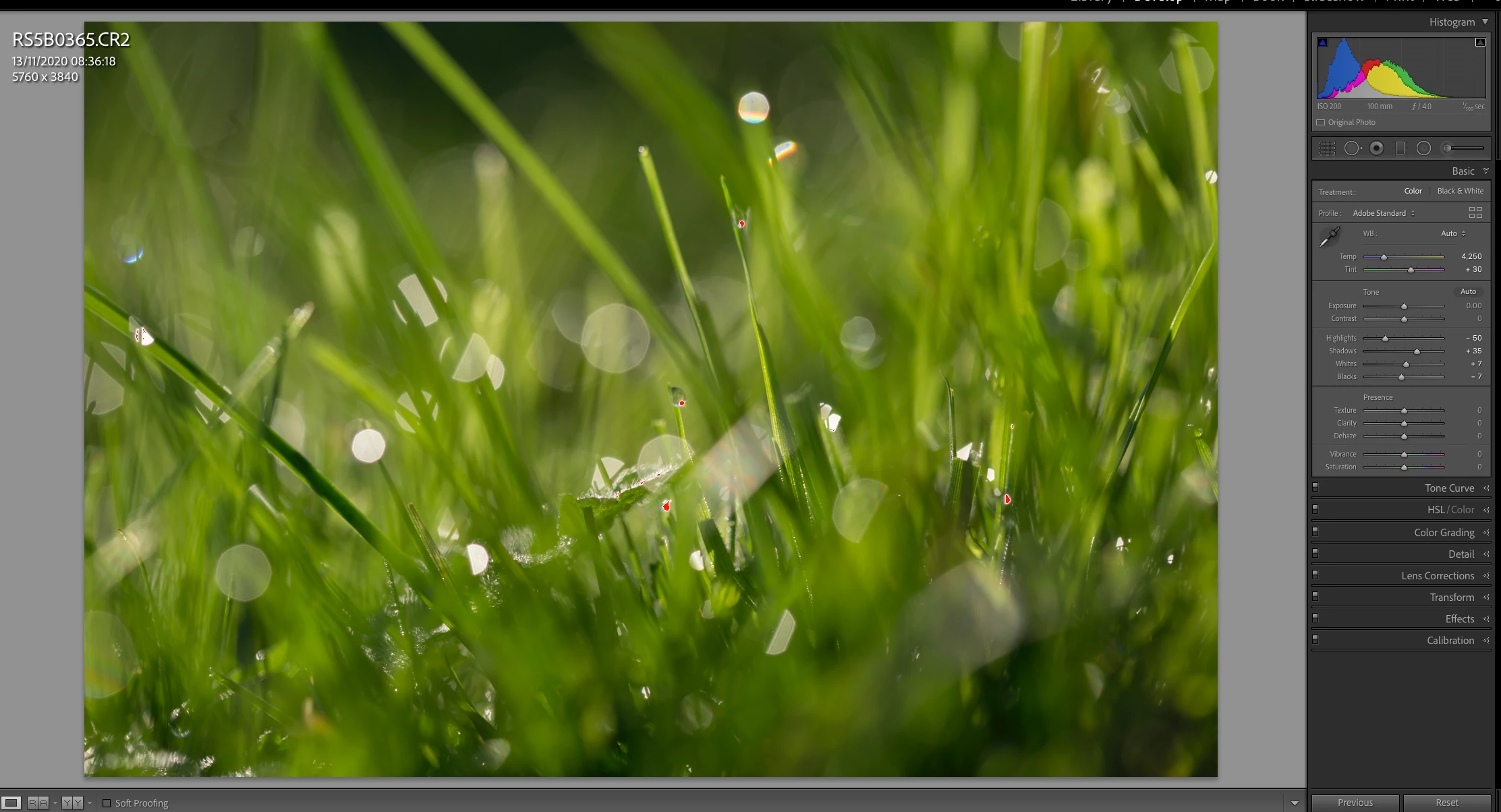

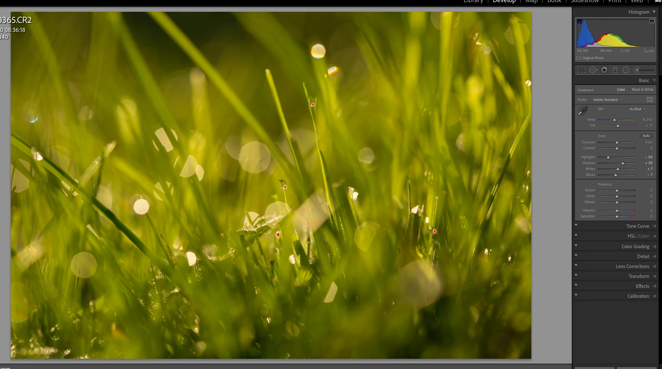

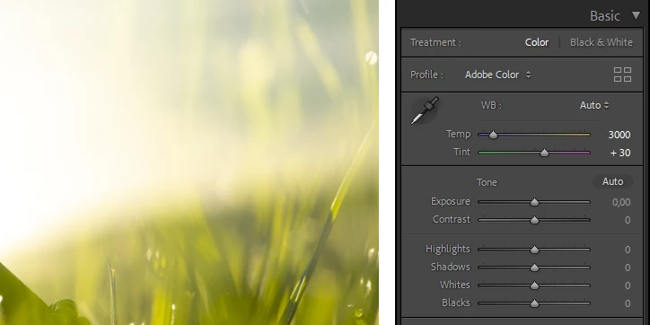

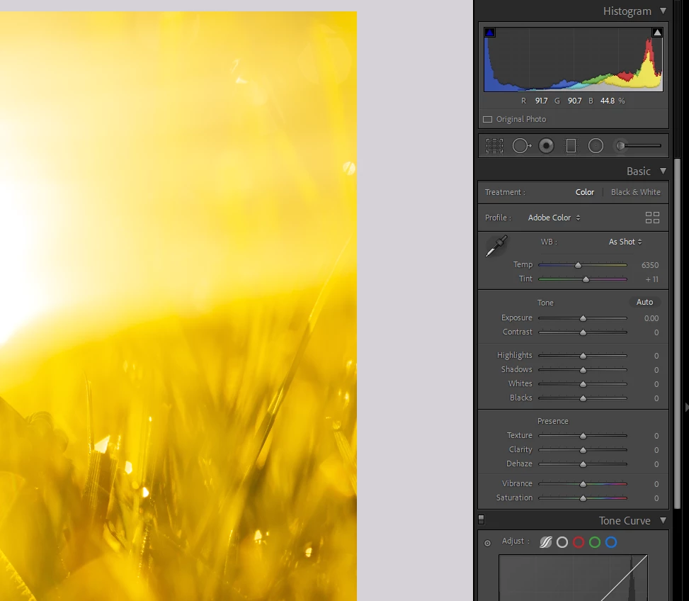

Same on my end. Imports yellow. As normal, in Develop, defaults to As Shot WB. Changing to Auto (in this case) makes it go green.
You may want to review the original camera, and see if perhaps something like WB was shifted.
hmmmm, screenshot (As Shot WB) note the values. Fairly sure not normal if in camera was set to Daylight, or even Auto.

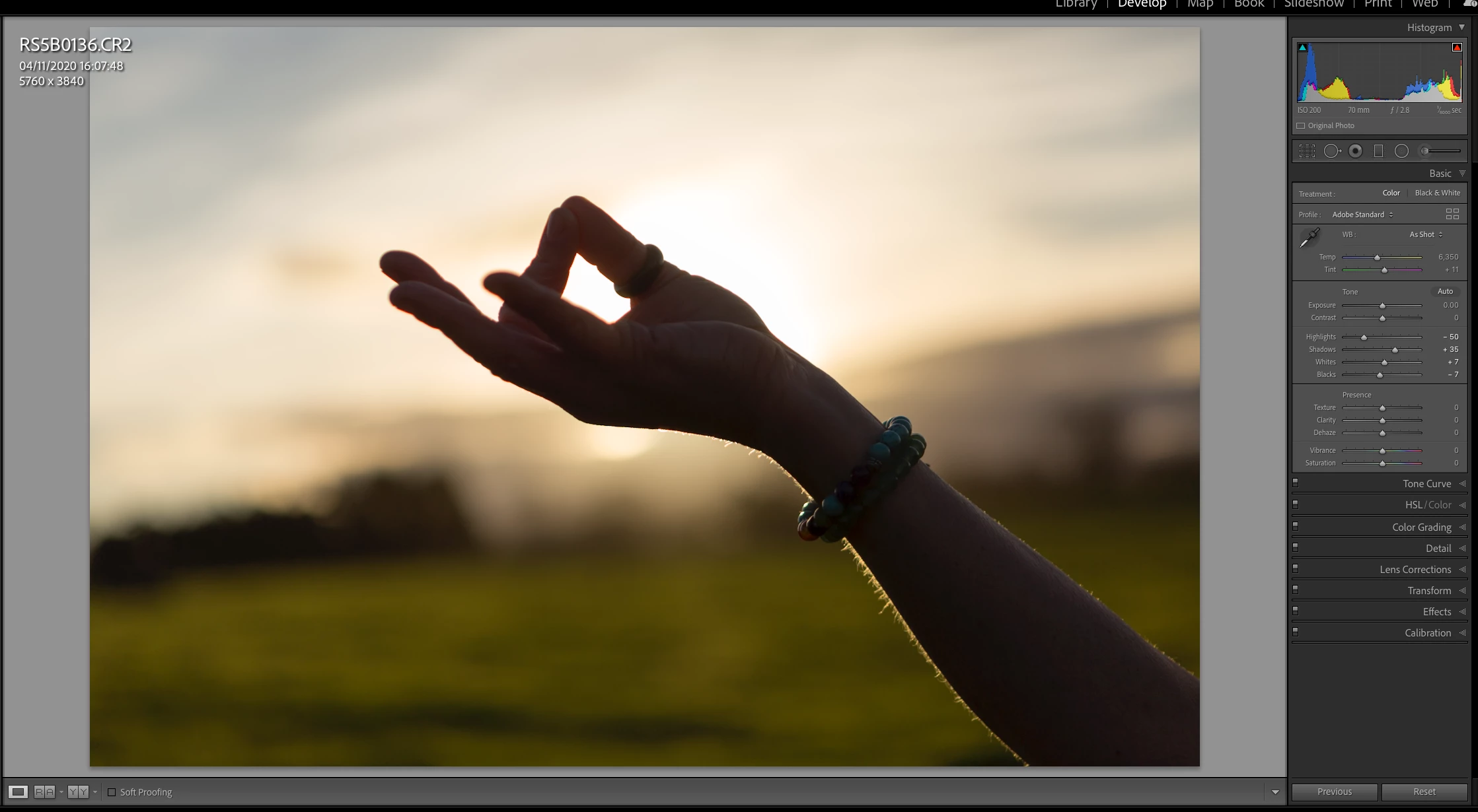

Hi Guys,
I've uploaded screengrabs of the original RAW files to create the in-camera Double Exposure.  While there is considerable yellow in the As Shot original of the grass, as you'd expect when the grass was drenched in sunshine, it's nothing like the funky yellow that the resultant Double exposure image turned.
Thank you for the idea of using Auto WB in LrC to bring back the green but I'd really love to understand what has happened so that I can prevent it from happening again.

I downloaded the raw file and imported it in Lightroom.
It opened yellow, like your second screenshot.
Changing the White balance from As shot to Auto changed it to green, quite similar to your first screenshot.
So may be you had it on Auto, and accidentally changed it to As shot?
