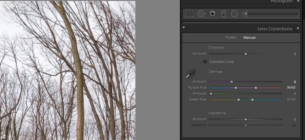

Hi there,
I updated Lightroom classic yesterday (11.11.19) and it seems that manual defringe panel is not working. Does enyone else have this issue?
Many thanks, Linas

November 12, 2019
I`m not doing retouching zoomed in at 1:1. It`s not necessary to zoom in as fringe color selector enlarges area by 5x5 pixels and you can clearly see area effected. Do you have any experience with Lighrtoom?

"I`m not doing retouching zoomed in at 1:1. It`s not necessary to zoom in as fringe color selector enlarges area by 5x5 pixels and you can clearly see area effected. "
I agree with Per Berntsen that you should make this adjustment in 1:1 Zoom view, which makes it easier to determine the actual image area you are sampling. That said it should still work properly at Fit view using the sampling eyedropper.  I can see an anomaly similar to what you mention at Fit view, but only when switching back to the Library module. The fringe in the below image is magenta color, which appears to be removed at Fit view in the Develop module after the Defringe eyedropper sampling. However, when I switch back to the Library module while still in Fit view the fringe is still there, but now appears green in color. Zooming to 1:1 view and back to Fit view corrects ths issue and the fringe is no longer visible.
All of these screenshots are at Fit view.
NO DEFRINGE APPLIED
DEFRINGE APPLIED IN DEVELOP MODULE
DEFRINGE APPLIED SWITCH TO LIBRARY MODULE
November 12, 2019
Update: It`s working, but I have to zoom in 1:1 for it to take effect. Any solutions ?

November 12, 2019
It`s visible at any zoom. Removing fringe only takes effect if you zoom in and out.
For example - I select area effected with fringe color selector, sliders automatically adjust but efect is not visible unless you zoom in and out.
