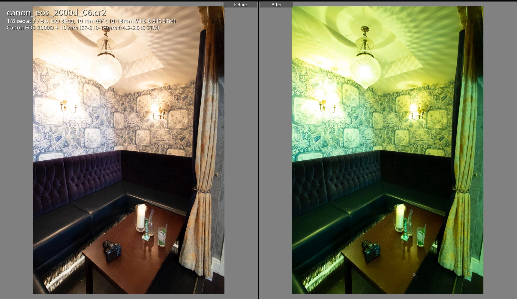

    elie_di  wrote
    This is not a case of a faulty or inappropriate profile; the 2000D and the 1500D and the T7 are all different names for exactly the same camera and if one were not supported, none would be.
    Yep, just verified that myself. Canon EOS 2000D - Wikipedia However, there is something wrong with the camera profiles.
    I downloaded a CR2 file with similar lighting here: https://img.photographyblog.com/reviews/canon_eos_2000d/sample_images/canon_eos_2000d_08.cr2 The As Shot LR WB readings are 4150 +94 and using ExifTool it shows Canon MakerNotes value of 3215 with RGGB levels very close to the camera's Tungsten preset. I changed the LR WB setting from Auto to Tugsten and changed the WB setting to 3215, which caused the image to shift to a very yellow-green hue. This very clearly indicates something is wrong with the camera profiles and NOT the camera or its settings!
