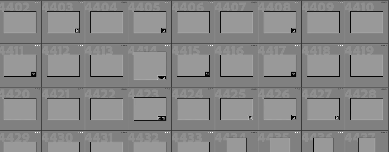

Hi everyone,
I'm encountering an issue in Adobe Lightroom Classic where I'm seeing gray previews even though I have the "Original + Smart Preview" setting enabled. Here are the details of my situation:
  • Lightroom Version: Lightroom Catalog - V13-3
  • Operating System: AMD Ryzen 5 5500U, Windows 11 Education
  • Issue Description:
    • I have the "Original + Smart Preview" setting enabled in Lightroom Classic.
    • Despite this, many of my photos are displaying as gray thumbnails.
    • When I check the Library module, the histogram indicates that the "Original" is present, so the files are not missing.
    • I've tried generating new previews by going to Library > Previews > Build Standard-Sized Previews, but the issue persists.
    • I've also tried disabling the GPU setting under Preferences > Performance, but this didn't resolve the issue.
I'm at a loss for what to try next. Has anyone else experienced this issue or can suggest further troubleshooting steps? Any help or insights would be greatly appreciated!

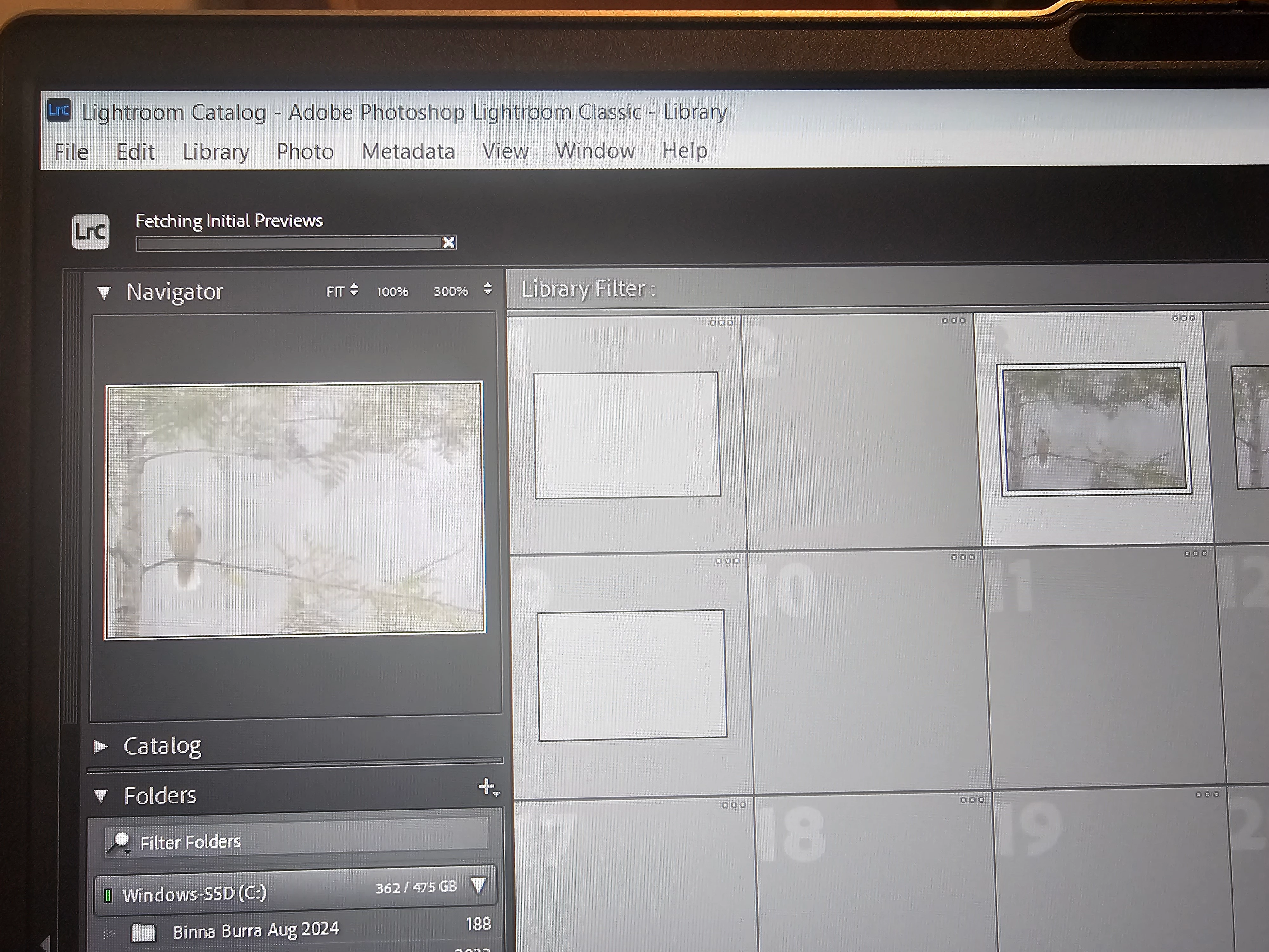

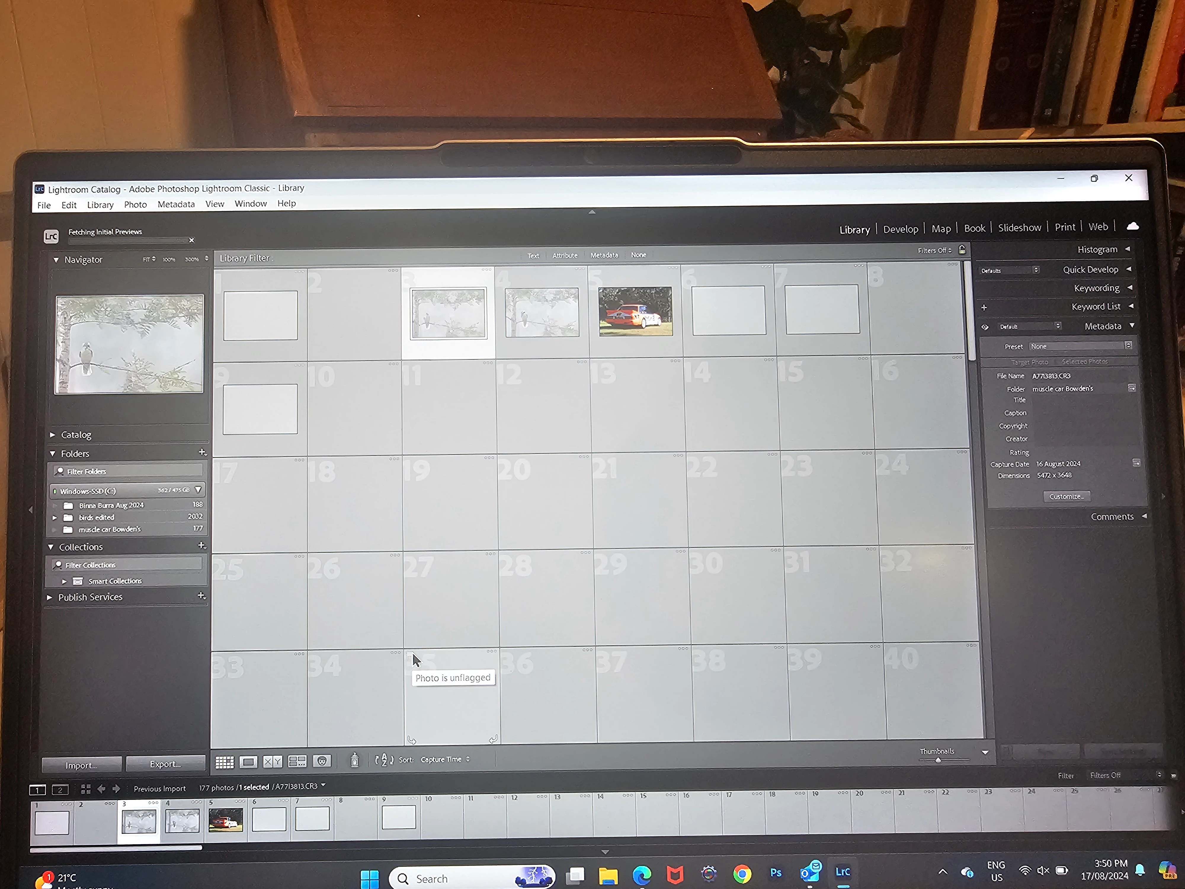

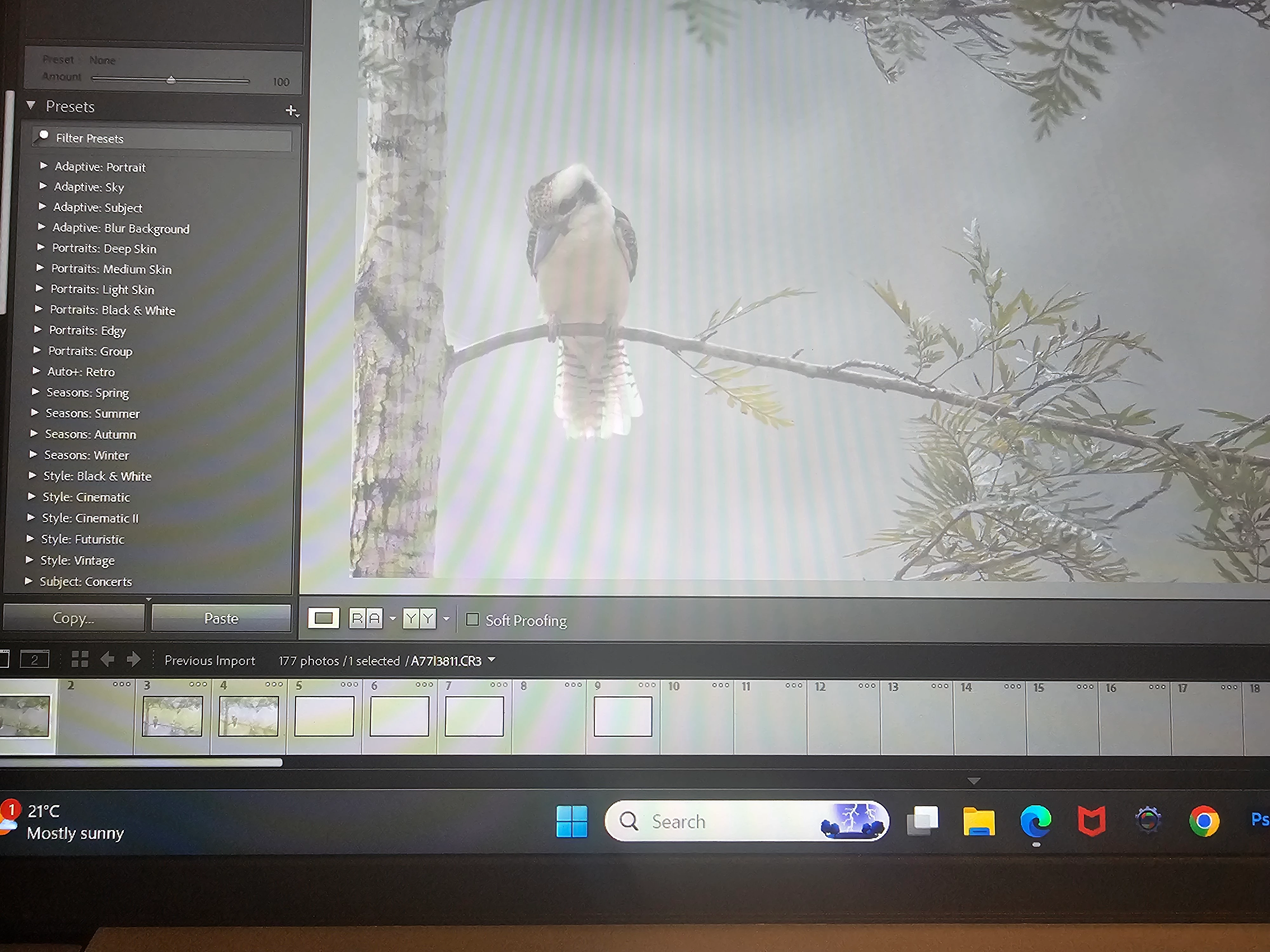

August 18, 2024
Hi, I am experiencing the sme issues after I did 3 updates, attached are 3 images, I am guessing you have the same problem, I have tried un-installing and re- installing but same issues
GoldingD
August 18, 2024
quote
By @Dirk A Klynsmith
  • Have you updated to LrC v13.5 yet?
  • Have you let LrC run overnight and allowed LrC to hopeful finish the sync?
A few members with earlier issues found that allowing a very unreasonable time for LrC to finish the sync (overnight) eventually worked.
