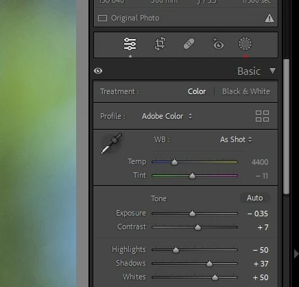

I am using Lightroom Classic 12.3 on Windows 11. I have a number of photos that need their AI masking updated.  These are identified in the Develop module by a small red dot under the masking icon (see attached).  Is there any way I can identify all the photos in my catalog that need to have their AI masking updated?

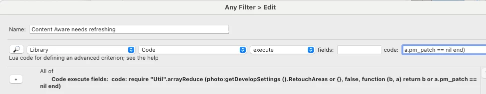

"I've also noticed that there are some files that need the healing brush to be updated.  Is there any way to find those?"
Try this Any Filter query:
Copy and paste this line (as one line) into the "code:" field:
require "Util".arrayReduce (photo:getDevelopSettings ().RetouchAreas or {}, false, function (b, a) return b or (a.SpotType == "heal_patchmatch" and a.pm_patch == nil) end)
Update: I corrected the "code:" line above -- I had given an old incorrect version. (I'm adding this as a built-in filter in the next release.)

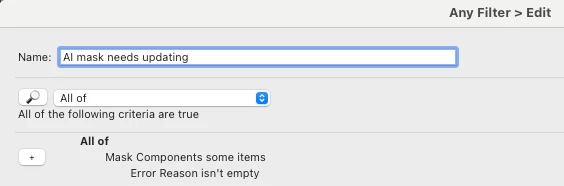

If you really want to see the photos needing updating, you'll have to use the Any Filter plugin's Search command with this query:
