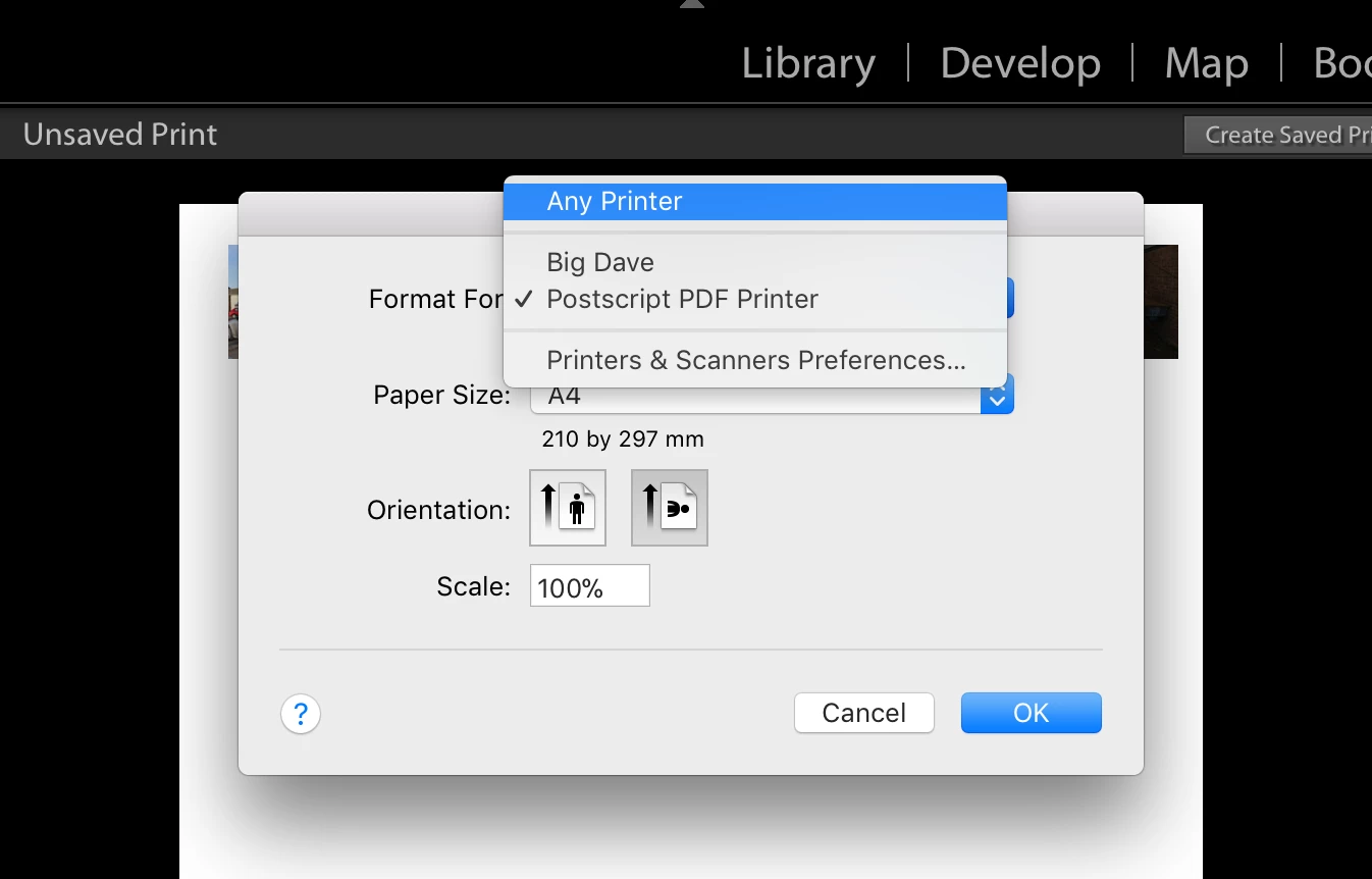

Sorry this is so late. The options in lightroom are really not intuitive for this. I was having the same issue printing to PDF. This isn't a printer / driver problem. Just a case a poorly implemented UI and UX testing I would guess.
I found that going into print setting is the key.
Then make sure the settings you are changing are for the printer you are using.
I just selected "Any Printer", changed the orientation to landscape and hit ok

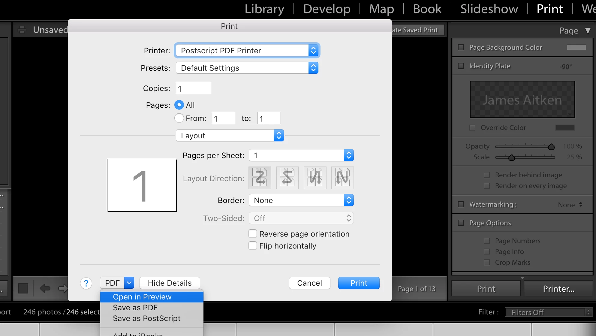

If you select "Any Printer" you can check it's working before you print by going into "Printer", Select PDF in the bottom left and then "Open in Preview" or "Save to PDF". If you wanted to you could always just save the PDF and print from that (I have been doing this so I have back ups)

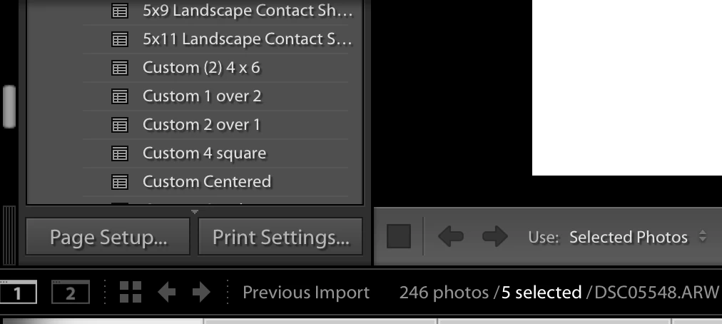

I have this same nonsense issue. Latest drivers, latest software. Adobe's incompetence, however, is legendary.
I do have a usable workaround though.
1. In the PRINT module, Click PAGE SETUP button. Create a new paper size that is the landscape size you want to print -- eg 11" WIDTH, 8.5" HEIGHT. Select this as your paper size, and make sure you are still using PORTRAIT orientation on this landscape-oriented paper size.
2. Design page layout as desired. Make sure your colour management is set properly in the PRINT JOB panel.
3. To print, click PRINTER..., then in the dialog box click the lower left drop menu that says PDF, in this menu click OPEN IN PREVIEW.  (This will cause Lightroom to render the print job as if it was going to the printer, but the OS intercepts it.)
4. When the PREVIEW application opens, you should see your print job properly laid out as landscape pages.  Just double check everything.
5. In PREVIEW select FILE -> PRINT, you should get a new dialog, here select the normal PORTRAIT version (eg. 8.5" WIDTH, 11" HEIGHT) of your page size, in PORTRAIT mode, and make sure AUTO ROTATE is checked and SCALE is 100%.
6. All your pages should print as landscape properly. You can now close the PREVIEW app, you don't need it anymore.
This is the best I've been able to do with this nonsense. Hope it helps someone else.
