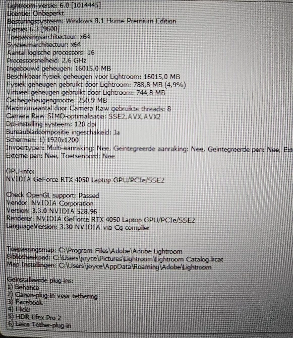

Systeminfo (it's in dutch):
Lightroom-versie: 6.0 [1014445]
Licentie: Onbeperkt
Besturingssysteem: Windows 8.1 Home Premium Edition
Versie: 6.3 [9600]
Toepassingsarchitectuur: x64
Systeemarchitectuur: x64
Aantal logische processors: 16
Processorsnelheid: 2,6 GHz
Ingebouwd geheugen: 16015,0 MB
Beschikbaar fysiek geheugen voor Lightroom: 16015,0 MB
Fysiek geheugen gebruikt door Lightroom: 767,8 MB (4,7%)
Virtueel geheugen gebruikt door Lightroom: 750,6 MB
Cachegeheugengrootte: 248,8 MB
Maximumaantal door Camera Raw gebruikte threads: 8
Camera Raw SIMD-optimalisatie: SSE2,AVX,AVX2
Dpi-instelling systeem: 120 dpi
Bureaubladcompositie ingeschakeld: Ja
Schermen: 1) 1920x1200
Invoertypen: Multi-aanraking: Nee, Geïntegreerde aanraking: Nee, Geïntegreerde pen: Nee, Externe aanraking: Nee, Externe pen: Nee, Toetsenbord: Nee
GPU-info:
NVIDIA GeForce RTX 4050 Laptop GPU/PCIe/SSE2
Check OpenGL support: Passed
Vendor: NVIDIA Corporation
Version: 3.3.0 NVIDIA 528.96
Renderer: NVIDIA GeForce RTX 4050 Laptop GPU/PCIe/SSE2
LanguageVersion: 3.30 NVIDIA via Cg compiler
Toepassingsmap: C:\Program Files\Adobe\Adobe Lightroom
Bibliotheekpad: C:\Users\joyce\Pictures\Lightroom\Lightroom Catalog.lrcat
Map Instellingen: C:\Users\joyce\AppData\Roaming\Adobe\Lightroom

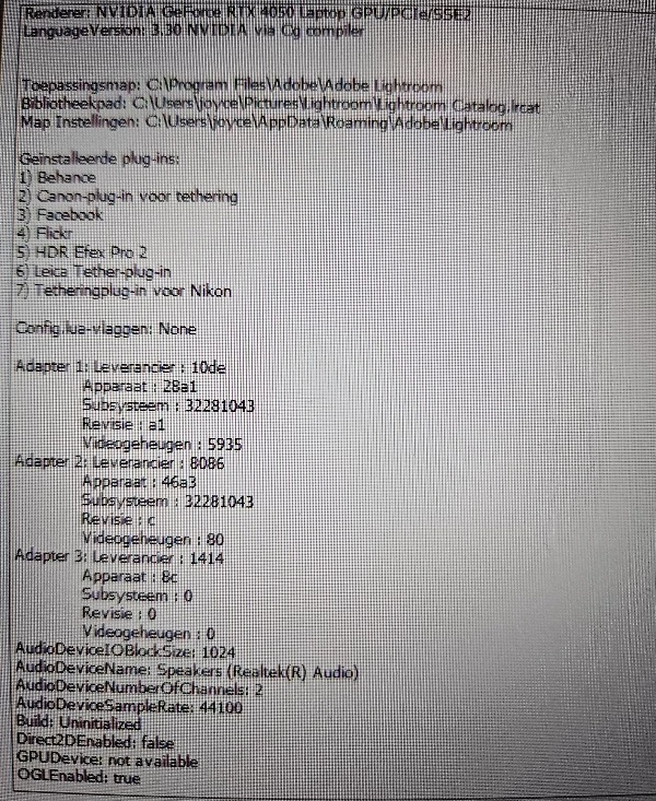

Please post your System Information as Lightroom Classic (LrC) reports it. In LrC click on Help, then System Info, then Copy. Paste that information into a reply. Please present all information from first line down to and including Plug-in Info. Info after Plug-in info can be cut out as that is just so much dead space to us non-Techs and it takes up vast amounts of scroll space making the reply less readable and less likely that others will bother with your post.
December 22, 2023
Lightroom isn't responding very well at the moment, so I have attached 2 foto's with the systeminfo. I hope that works as well.
I hope someone can find a solution, because nothing I have tried so far didn't help.
Thank you!🙏
GoldingD
December 22, 2023
That second photo show Lr 6, apparently as in ancient lr 6 from pre subscription days.
It also shows Windows 8
What the heck?
To get and post better info, in Lightroom, click on Help, click on System Info, click on Copy. Paste that info into a reply (you might want to trim the info down a bit, as most of the info after the plugin info is largely gobblygook to many of use). Photos of a monitor suck, Please actually copy and pastee instead.
