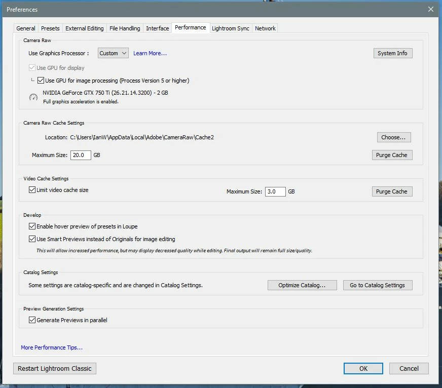

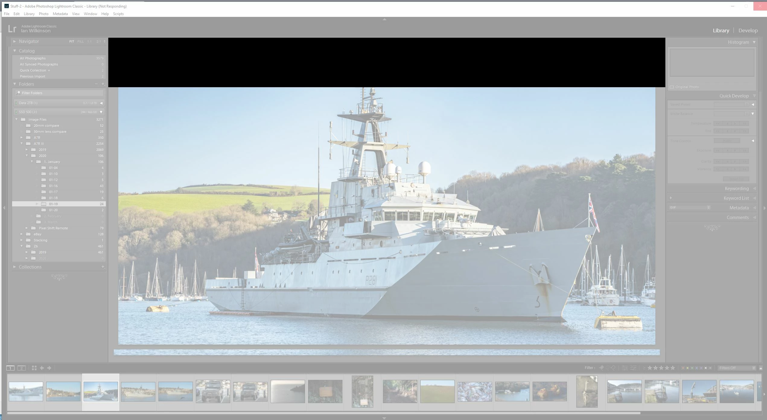

Shortly after startup Lr stop responding — this now happens every time Lr is run. A spinning blue doughnut appears, a black rectangle is displayed top and centre, then the remainder of the window turns a translucent grey. This last for a minute or more, during which time the screen is unresponsive. Eventually the display clears (usually a few seconds after I've fire up Task Manager) and normal operation is resumed.
This behaviour only started happening recently and hasn't been fixed by an uninstallation and re-installation of the software.  I read another thread for this problem and tried a couple of suggestions, like switching off GPU support and checking for disk space availability (92GB free out of  237GB on SSD) but to no avail.
I attach a screen grab of the error, screen grab of the Performance tab in Preferences and a text file of System Info.
Any suggestions gratefully accepted, please...

Thanks very much for all of your help David — I think it's fixed now!
1. Updated NVIDIA driver to 441.87 — didn't seem to make any difference.
2. Disabled GPU — no luck again.
3. Tried launching LRC in Develop mode — BINGO! not freezing.
4. Reverted to launching in Library mode — problem returned.
5. Disabled LogiOptions plugin — Problem solved!  Able to launch both in Develop and in Library mode.
6. Remembered that I bought a new Logitech mouse last week — AAAARGH! That's when Lr started misbehaving...

Displays: 1) 2560x1440
Input types: Multitouch: No, Integrated touch: No, Integrated pen: Yes, External touch: No, External pen: Yes, Keyboard: No
Graphics Processor Info:
DirectX: NVIDIA GeForce GTX 750 Ti (26.21.14.3200
So, a couple of observations
1. GPU
NVIDIA 750ti driver version 432.00
out of date, current available v 441.87
You should have a NVIDIA  app called GeForce Experiance, check it for updates, then use it to check for and update your GPU  driver. Never ever rely on MS updates for non MS devices.
Edit/When updating that GPU driver, consider a clean install, In the GeForce Experience install of a new driver, I think, that involves crossing custom. Sometime previous drivers when updated can leave garbage behind that fouls things up.
2. Not running 4K,
so Use GPU in LRC probably not of much use, thry with and without on a photo with lots of edits, especially lots of adjustment brushes, if no performance difference scrap that, as sometimes use a GPU fouls things up on non 4K. Probably not fouling up launching your catalog, Use GPU applies to Develop module, not Library module typically brought up at LRC launch.
