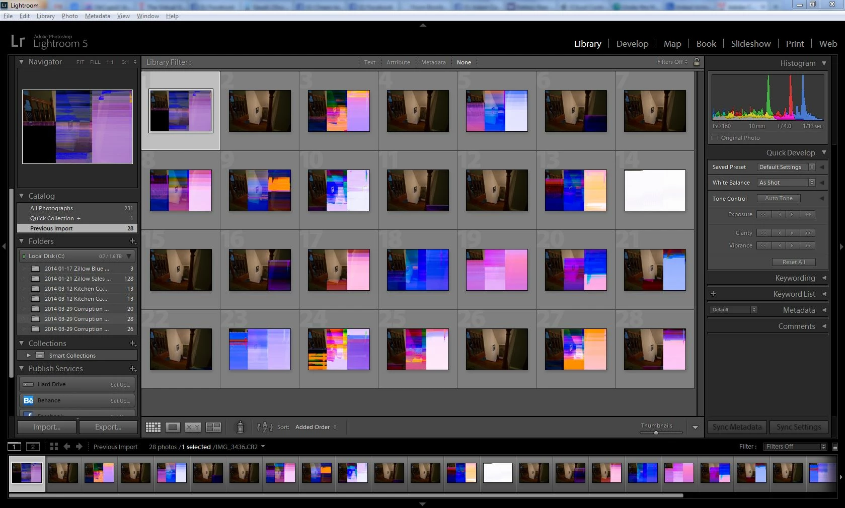

I've started having some issues with RAW files being corrupted when I open them in Lightroom. I've done a lot to troubleshoot and narrow down the symptoms, and here is what I can tell you. If anyone has any ideas for how to solve this, I'd really appreciate it!

Here's what the corruption looks like in my Library view. Note that all of the photos are the same. I just rapid-fired a bunch of shots down the hallway to test this out.
I first noticed the corruption on the PC, pulling photos from the 32GB card. I bought a new hard drive (SSD hybrid), installed a clean version of Windows 7, and upgraded to Lightroom 5, then the 5.3 update. I re-downloaded some photos from the 32GB card, and they still show up corrupted. So here is my further testing:
  • I shot a series of photos like shown above on the 32GB card, downloaded them on the laptop with a new USB cable. The photos look good.
  • I shot a series of photos on the 4GB card, downloaded them to the laptop with the same cord, they look good.
  • I imported the same photos photos from the 4GB card and from the 32GB card on the PC with my existing Lighrtoom Catalog and they are corrupted.
  • I created a new Lightroom Catalog on the PC and downloaded the same photos from the 4GB card and from the 32GB card on the PC and they are corrupted.
So what gives? I think we can rule out corruption or issues on the hard drive, the OS, the USB cable, and both of the CF cards. It baffles me that a new HD, clean OS install, new catalog, new USB cable, and upgraded Lightroom haven't solved the problem. Is it possible that there is some other part of the hardware on my PC which is corrupting the files?

I appreciate the kind advice Modesto but I think you're off base on the graphics card problem.  There is no way a graphics card would cause only some images to show corruption.  The graphics card has no concept of individual files. Graphics card issues would be more widespread and would not somehow limit themselves perfectly to individual files displayed in different visual locations on the screen in different applications.  Just a PSA for others reading this thread.
I also won't bother copying the corrupted files to another system.  The corruption has already happened.  100% guaranteed.  If two pieces of industry leading software show the same issue as well as multiple OS viewers there is no reason to try another.  This is not a general format or compatibility issue (which might benefit from trying another piece of software), it is clear cut corruption.
Ah HA!  Found the issue.
I was mistaken when I said I had viewed / edited / exported one of the files earlier.  It turns out it was another file in the series.  After more testing with the original memory card it's clear the corruption happened at on the card it self.  Attempting to view the images on that memory card via the built-in card reader on my Macbook Pro as well as a 3rd party USB card reader both show the same corruption.  The card (or perhaps camera, though less likely I think) corrupted the file at capture / write time.
I believe the reason the corruption was not visible in Lightroom until I viewed them in Loupe view was that I had the "Build Previews" option in LR set to "Minimal" meaning it was using the embedded previews and not rendering a preview from the RAW file itself. Lightroom only attempted to build a standard preview from the RAW file once I opened it in Loupe view, thus that's when the corruption was first visible in LR. This is what made me think I was witnessing the file becoming corrupt on the fly. Had I set Lightroom to build a preview from the RAW file during import (using "Standard" or "1:1") the corruption likely would have shown right away.
Appreciate the sounding board and advice.  Apologies for not doing my due diligence ahead of time and ruling out the memory card.  I had been mistaken about my previous interactions with the files which threw me off path a little during troubleshooting.
Carry on, nothing to see here

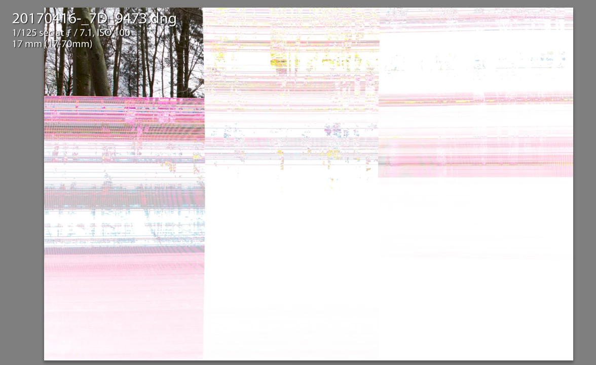

I took 85895 pictures before I used Lightroom CC all this pictures were taken in RAW and with the original canon program.
Non of this pictures were corrupted
Since I use CC I have too many corrupted files , I have one laptop MAC BOOK PRO and one iMAC , on both i see corupted files.
I learn to copy my CF card before I ask LR to convert it to DNG.
All the CR2 files are correct in Digital Photo Professional , but most of the time I have one or more corrupted files after converting it to DNG.
I did some test with a direct USB cable from the CANON 7D MK1 or 5D MK3 and also with a LEXAR card reader. Again the files only corupt when I use LR.

Lightroom never writes to the image portion of your original RAW files. So Lightroom cannot corrupt the files.
The reason DPP is showing un-corrupted files is because DPP usually shows the embedded JPG preview, rather than some version of the RAW, and often the JPG preview is uncorrupted even when the RAW itself is corrupted.
Anyway, because of the above facts, you still need to investigate to see which component of your hardware has caused this corruption.

You say the images look good on the laptop, but they're corrupted on the PC. I assume that you're using LR to view them in both places.
So there is something in the PC that is corrupting them. I don't see why you can rule out the hard drive. New hardware fails more often than hardware that has run for a few months.
I'd check my hard drive and my RAM. Either can lead to corrupted images. Download Memtest and run it against your memory. Disk manufacturers often supply diagnostic programs for their drives. You probably can find one on their website.

I think that I can rule out the hard drive because the problem surfaced on my old hard drive and also is apparent on my new hard drive. I think you might be right that it is a RAM issue. I'll try out Memtest... hopefully I will be able to understand what the results tell me. I'll report back. Thanks!

On laptop, you assessed "photos look good" by importing in Lightroom, and waiting until initial view is replaced by raw rendering? (or some other software which renders the raw instead of showing jpeg preview. if not, then that test doesn't mean much, except that it might take a few seconds before thumbs appear corrupt in Lightroom).
Have you tried a different card reader?

Just to make sure, on the laptop I developed one of the photos which appears corrupt on the PC, and it looks fine in Develop mode in Lightroom as well as in the final jpeg I developed. So I think that the preview isn't the issue. In terms of card reader, I just plug the USB into the side of my camera. I've never seen a reason to add another piece of hardware into my process. Is there something I am missing there? Thanks though!

No. If camera works then you don't need (and problem isn't) reader. But for the record: many people use readers because direct from camera either doesn't always work reliably, or it's less convenient. For example, I use reader because I have one permanently installed and available, whereas I don't keep USB cables permanently strung - 6 o' 1 half-dozen of other...
PS - I think ram problem is likely given the rest..

I would suggest getting Dell or you reseller to run a utility check on the hard drive or USB ports. Definitely a hardware fault as LR does not write to CR2 files.
