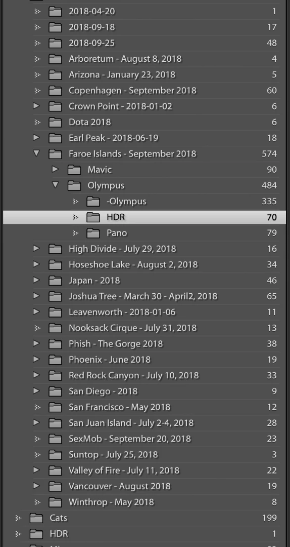

I cannot figure out this issue for the life of me. If I try to create an HDR or Panorama in Lightroom it creates a new folder in the folders and puts that new image in that folder rather than the existing folder which is where I would like ti to go. It does this if I use Photoshop to create hem as well. When I save from Photoshop Lightroom creates a new folder for the image. It only seems to do this in the folder list in Lightroom. If I go to the folders in finder the image is in the proper place. It didn't used to do this it just started at some point. I have done quite of bit of research on this and the only things I have found are making sure my export settings are correct, which they are and also about updating folder location, which doesn't work and just messes up my folder structure. Anyone run into this issue? Thanks.

    If you hover the cursor over each of the two "HDR" folders in turn, a tool-tip will appear which shows the full file-system path to the folder. Can you let me know what the two paths are.....if it's the problem that we think it is, the path should be almost identical except that one character at least will have a different case, i.e. one will be capitalised, the other won't be.

    WobertC​ is almost certainly correct, this sounds very much like the "capitalisation issue". Suggest you post a screenshot of the Folders Panel which shows the "new" folders as well as the folders that you expected Lightroom to use, then we'll be able to suggest a way to resolve the issue.

    Thanks for the replies. I will take  a look at that link when I have some time later tonight, on my way out the door for the day. Here is a screen shot of my folder structure. The highlighted HDR folder is the original. At the bottom you see a new HDR folder where the photo is placed. When I look in finder in OSX the image is in the correct folder (exact same folder as original files), meaning there is not a duplicate folder created on my drive. In this case this was using the merge to HDR function within Lightroom. Doing the HDR process through Photoshop does the same thing. I had this fixed at one point but cannot remember how I did it but the problem has returned.

    The "new folder" that appears in Lightroom- Does it have the same name as the folder containing the original image files? ie. If you right-click on each of these folders and "open in Finder" are you taken to the exact same folder?
    Seeing two folders in Lightroom (the 'new' and the 'source') possibly indicates some corruption with your catalog.
    These symptoms are characteristic of the "Duplicate Folder" bug.  See- Lightroom: Creates duplicate folder after Photoshop edit or Import from disk | Photoshop Family Customer Community
    This 'bug' also cannot be corrected by updating folder location- there needs to be a specific order of steps to fix. (and Jim Wilde always seems to have the answers for this "Duplicate" bug.)
