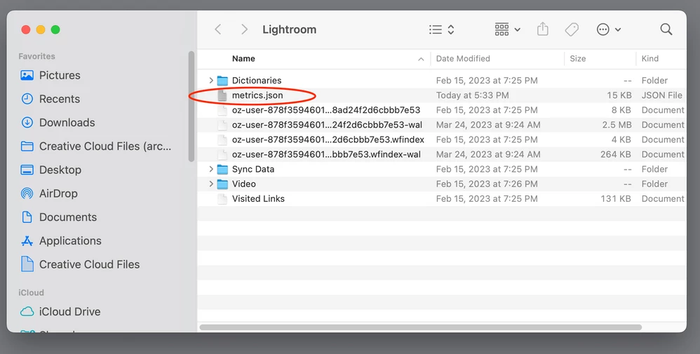

Posting basically recommends deleting or moving a specific CACH file named “metrics.json”
This file is located at:
Mac: /Users/<username>/Library/Caches/Adobe/Lightroom/metrics.json
Win: C:\Users\<username>\AppData\Local\Adobe\Lightroom\Caches\metrics.
This file appears to be created if you have not opted out at Adobe.com from the Desktop App Usage . This can be changed by in the LR menu, select Help > Manage My Account, then go to Edit Profile > Privacy And Personal Data, and disable the option Desktop App Usage > Share Information On How I Use Adobe Desktop Apps.
_____________________________________________________________________

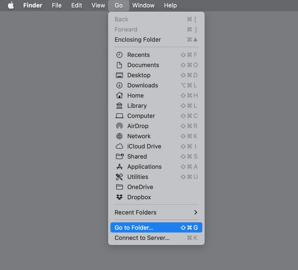

For MACOS users, this file is by default hidden. One way around that as follows:
Restart your computer (to ensure LR isn't running, hidden).
In Finder, do the menu command Go > Go To Folder:

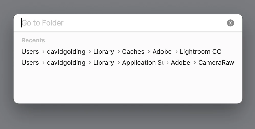

then in this dialog screen:

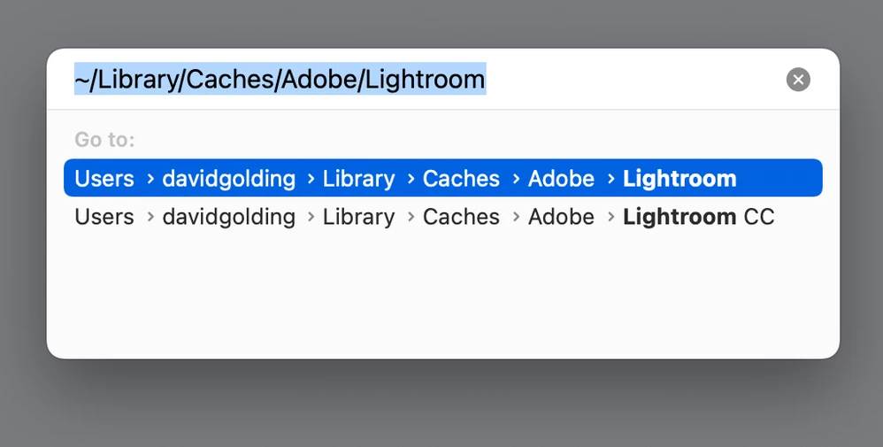

type in:
~/Library/Caches/Adobe/Lightroom
hit the return key, and you should see something like:
