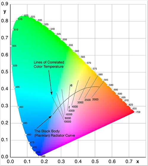

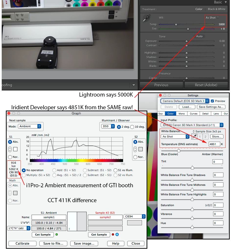

The problem is, the Kelvin numbers define a very large scale of possible colors. You shouldn't expect differing cameras or raw converters to agree (and cameras are the wrong tool to even measure this).
And each converter defines the meaning differently. Gotta do this visually.
Case in point visually to the first sentence, any color on line is IS the same numeric value in Kelvin:
Author “Color Management for Photographers" & "Photoshop CC Color Management/pluralsight"

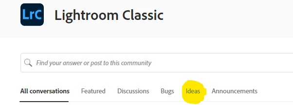

you can click into this special sub-forum, to make a suggestion for how the software is further developed. Good idea to first search if a similar suggestion has already been made, and if so, join your support to that. One posted idea gathering 100 votes looks like very strong user support - while 100 similar posted ideas each with only 1 vote, looks (on average) like very weak user support for the change that they all suggest.
