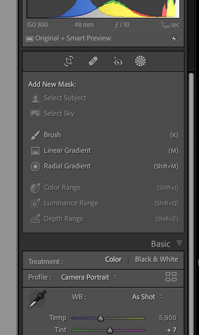

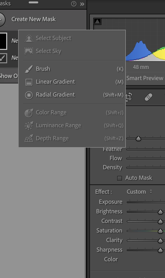

When I open an image with a sky and go to the develop module, I select the mask tool.  The only masks I can create are the brush and gradients.  The select Subject and Sky masks are unavailable.  How do I get them back?  I have a number of plugins from DXO and Luminar.  Is it possible one of them is causing a conflict?

Can you share a screen capture of the mask tool panel?

You have to be using the current process version.  In the Develop Module, use the menu command Settings->Process Version and select Version 5 (Current). NOTE: If you had edited the photos using an older process version, the appearance of the photo may change.
petergpc작성자
May 28, 2022
Whew, that did it!  Thank you!!!
