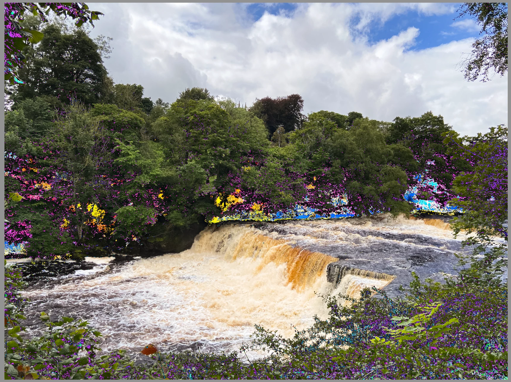

I updated LrC to 12.4 yesyerday. Since then a number of pixels in multiple colors appear appear quite often on the image, mostly in the areas of blacks/darks and when using Tone Curve commands. It's similar to the red/blue pixels which denoted clipping in the areas of blacks/whites, but they appear in very many different other colors. Sometimes they disappear, or decrease, after actioning the commands again, sometimes they do not. Is anybody else facing the same problem which I encounter now for the vey first time after many years of use of LrC? Thank you in advance for your advise.

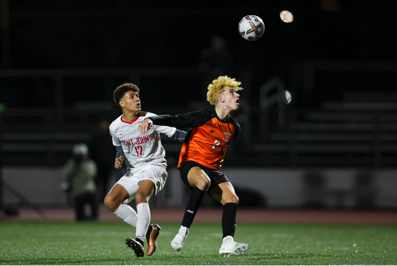

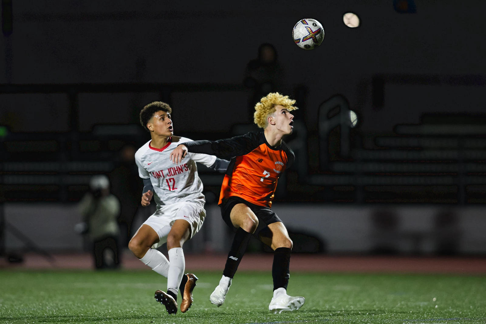

Hi--fairly longtime LR user here. I'm running classic 13.0.1 on a MBP running 12.6.5 (it's a 2015 model so I don't think I can upgrade any further). Tonight, I experienced the seemingly common issue where blacks/shadows in my images were rendering lighter in the Develop module than in the Library module. I checked my Preferences and shut off the GPU as explained in other threads. That seems to have fixed the issue in the Develop module. However, when I export the images, the shadows and blacks do not render how they should--there is a lot of noise and those areas are generally lighter than they should be. You can see the difference in the background of the images below. I figured out a workaround where I sent the images to PS and exported from there (images were rendered fine that way) but that's a lot of extra work that I shouldn't have to do.
Is this a known issue? And will moving back to an earlier version of LR fix this issue? I shot/processed a few times this week without any similar issues. It only popped up tonight. Have also tried restarting/rebooting and nothing fixes it.

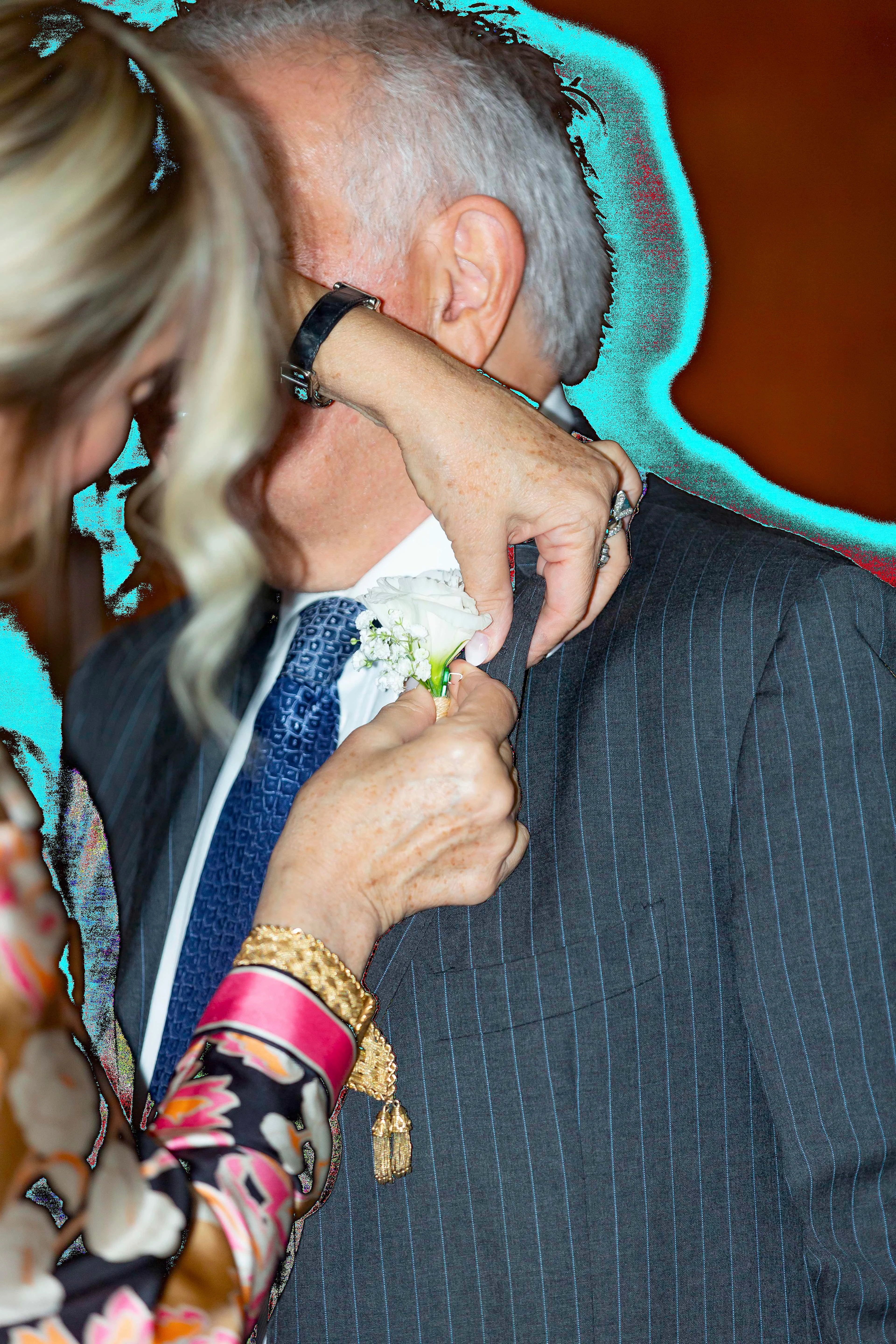

I am using lightroom with a 2015 macbook pro 15". I keep it up to date. I am having a weird issue where there is shadow clipping in all my photos. I pressed J and toggled it on and off and it is always there. The clipping is even showing up in my exported photos. I cannot figure this out. Has anyone had this issue before? I attatched a photo that has been exported with normal presets that has the clipping in the shadow

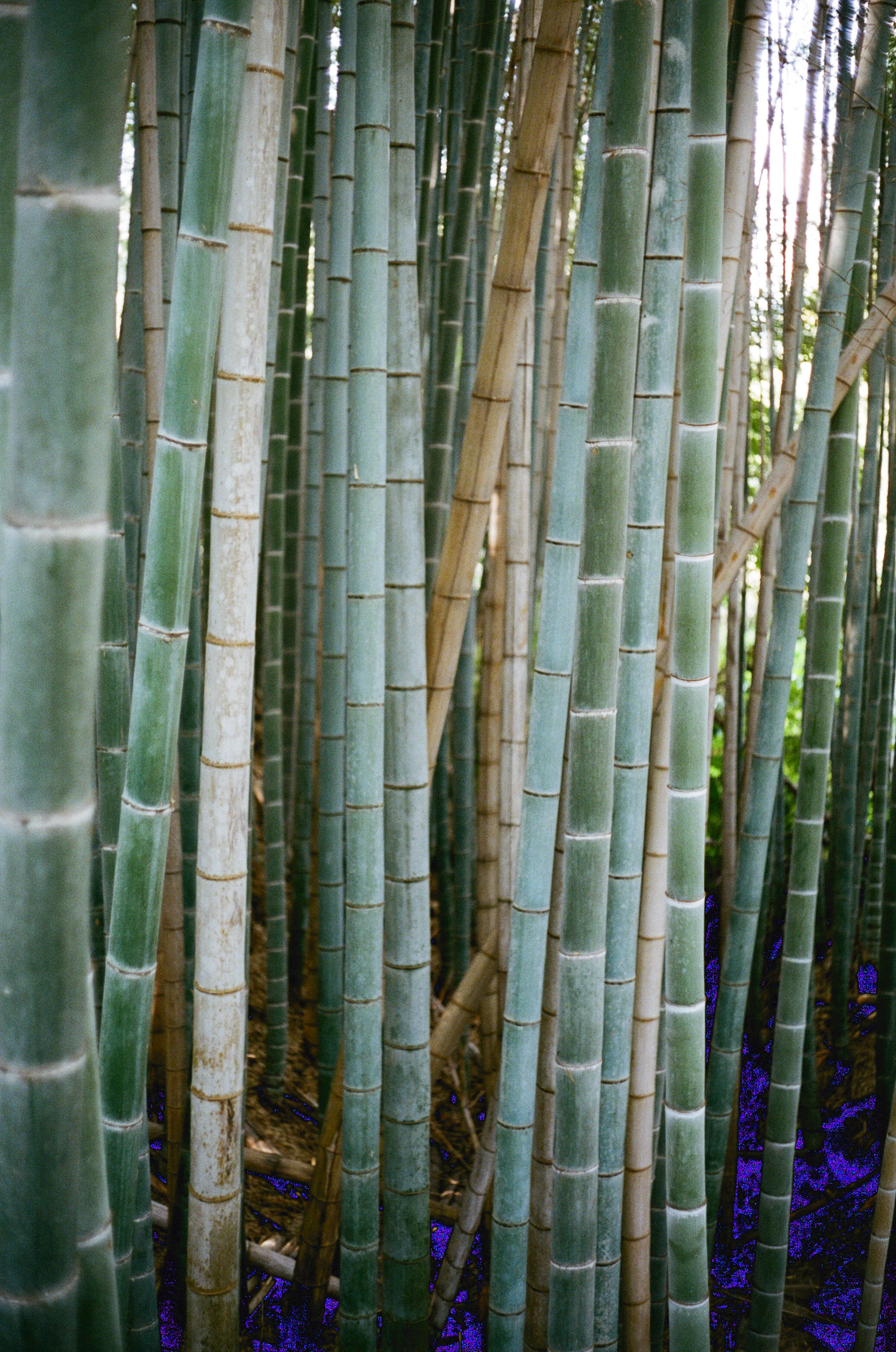

I have a problem with Lr-v13.Ircat because the exported .jpg files after the update are corrupted, there are halos of various colors
