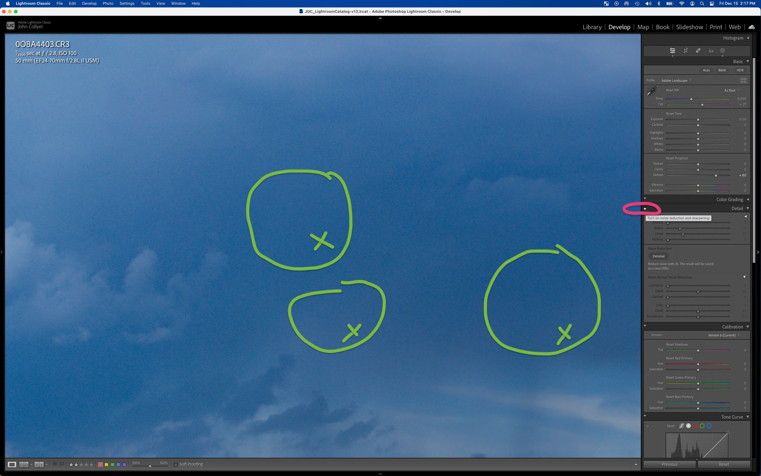

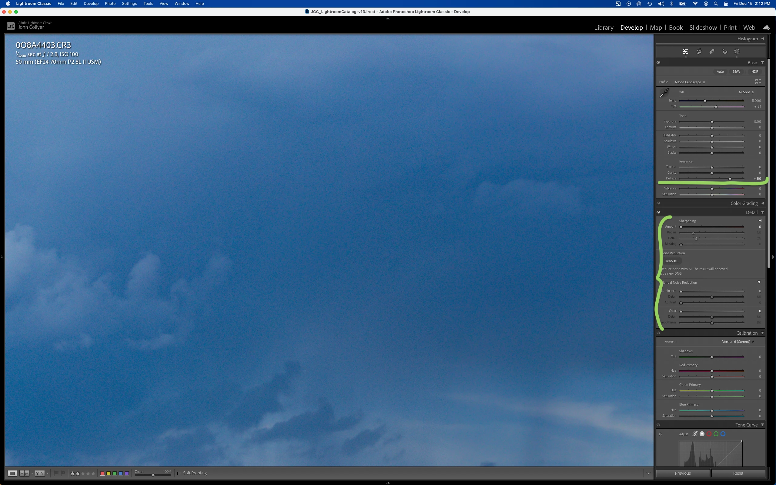

Here is my default develop windows with base processing cranking up the Dehaze setting.  Please note the “Details” setting on the base process, all the slider are set to 0.

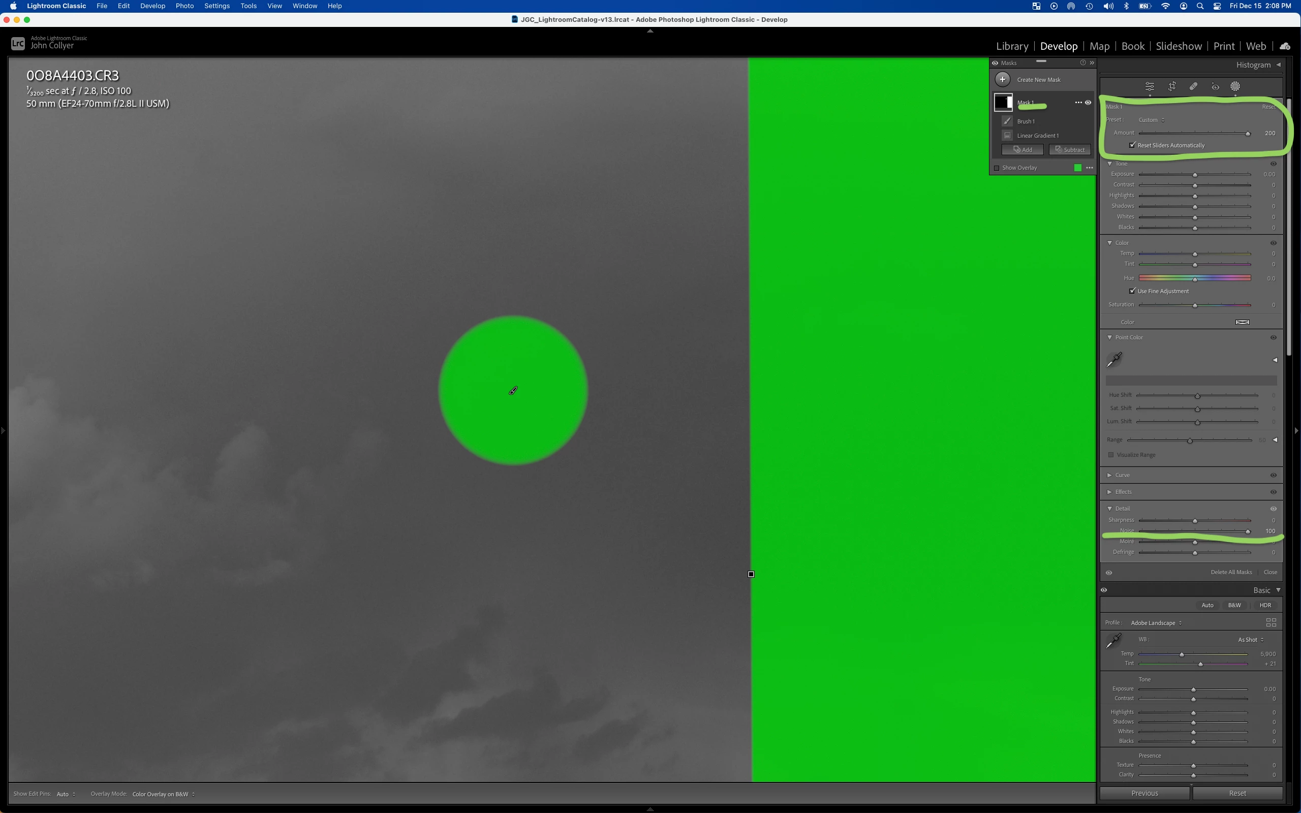

Here is the masked area I want to apply mask noise reduction on

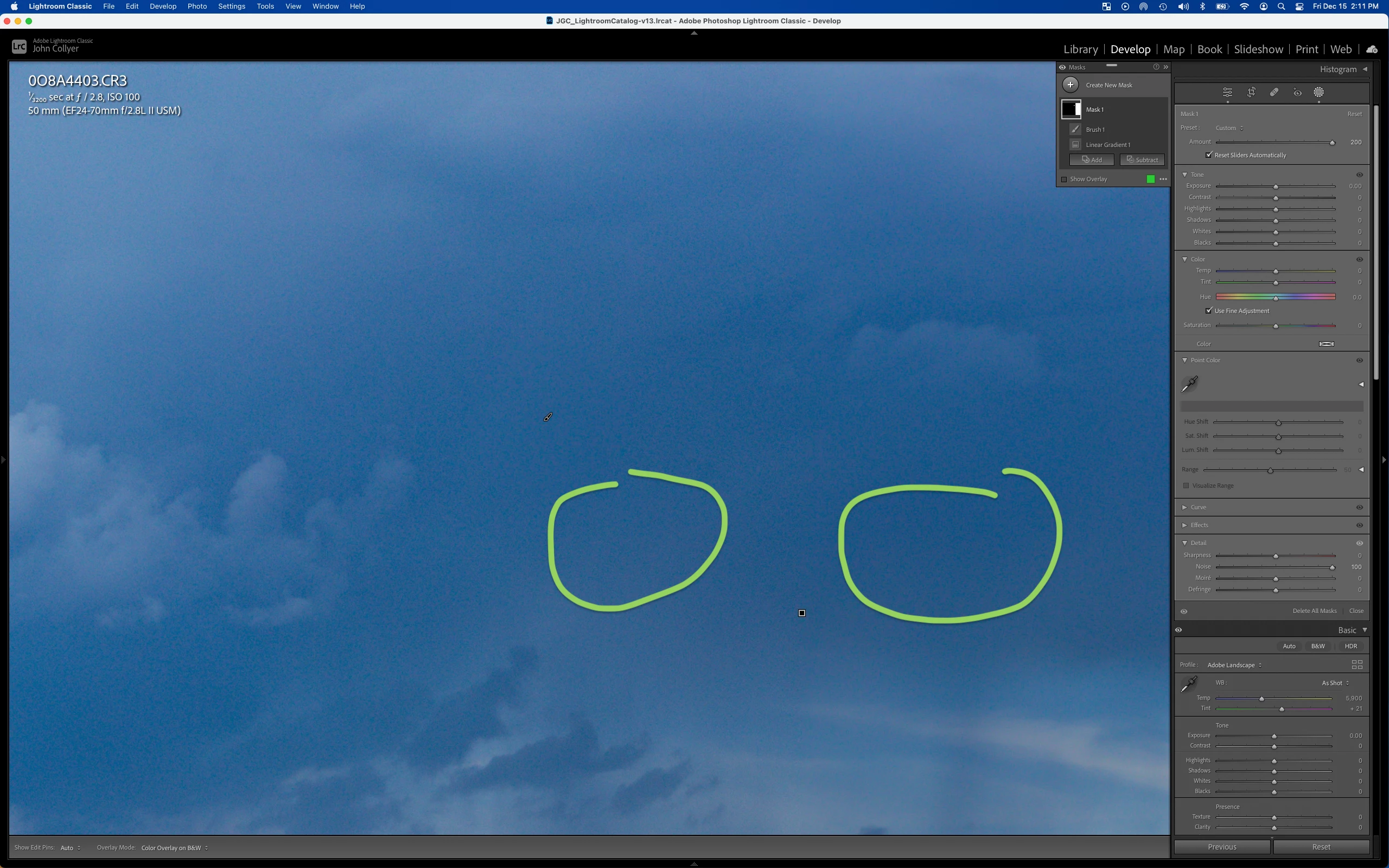

This is the masked results, it’s a very minor visible improvement, not as good as it used to be, and my masking layer noise reduction is set way too high not to see a smoother image.  See the results circled here in green.  The left circle is no layer mask NR, the right circle is inside the layer mask with NR

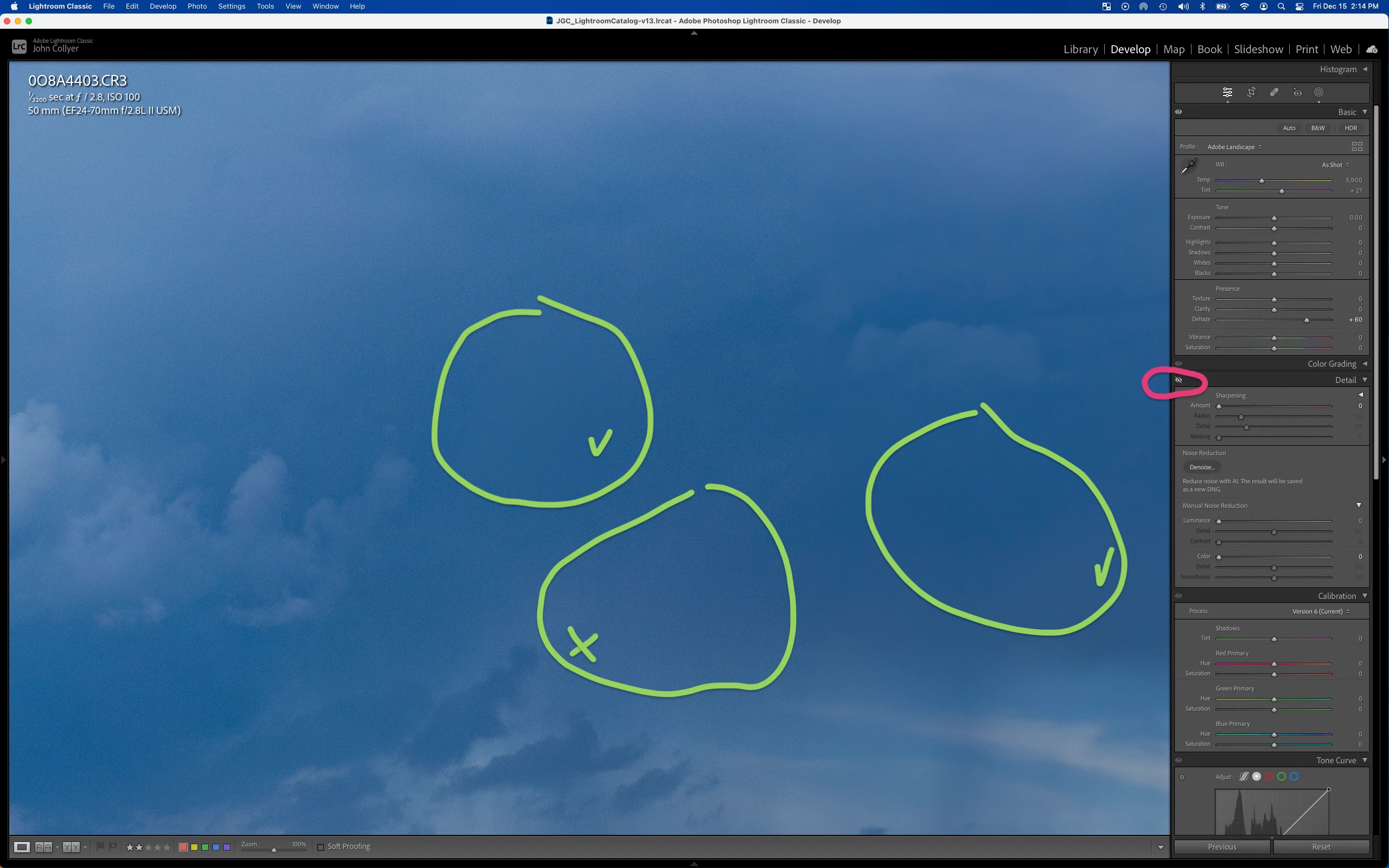

If I use the Eye icon (red circle) and toggle off the Details section, the marked areas with NR get many times better results from NR, here almost too much.  In the Right circle, nice and smooth.  In the left top circle, also part of the mask with NR, nice and smooth, the bottom center circle not part of the Mask you can see the original noisy base processing from the Dehaze.
Please note the “Details” setting on the base process, all the sliders are set to 0.
If I Option+Left Click on the on/off toggle (red circle) for the Details in the base processing, I expected to get the same smooth results as above, but it does nothing, the masking with NR are still not as good as when the Details section is momentary toggled off using the Eye button.
