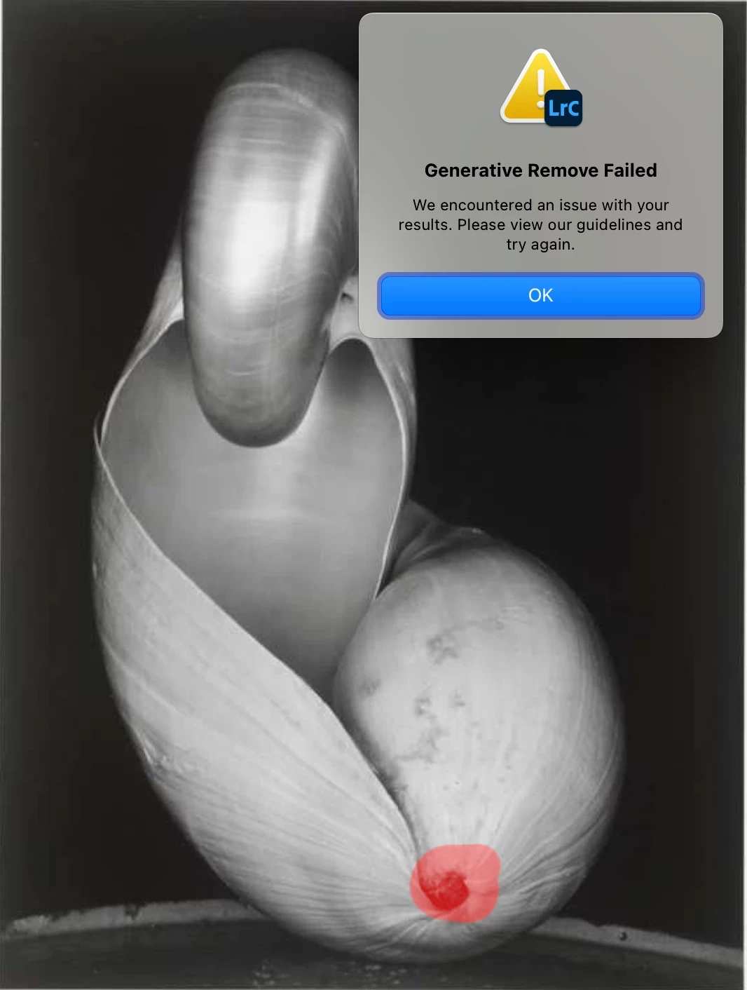

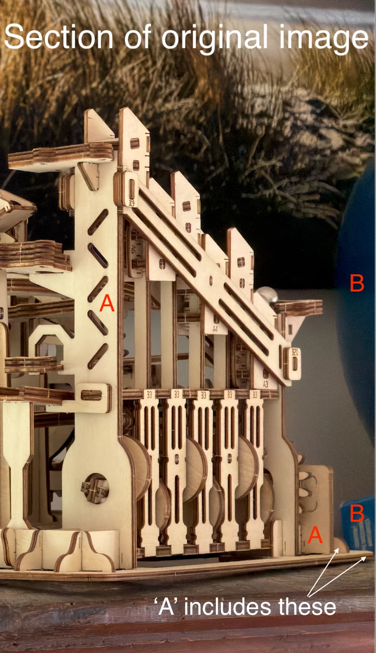

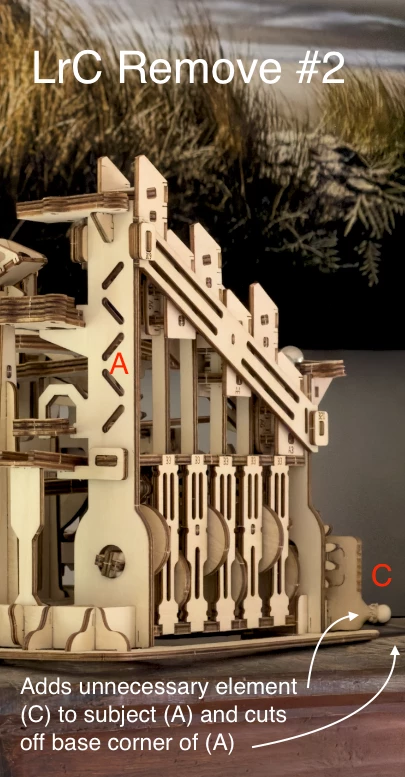

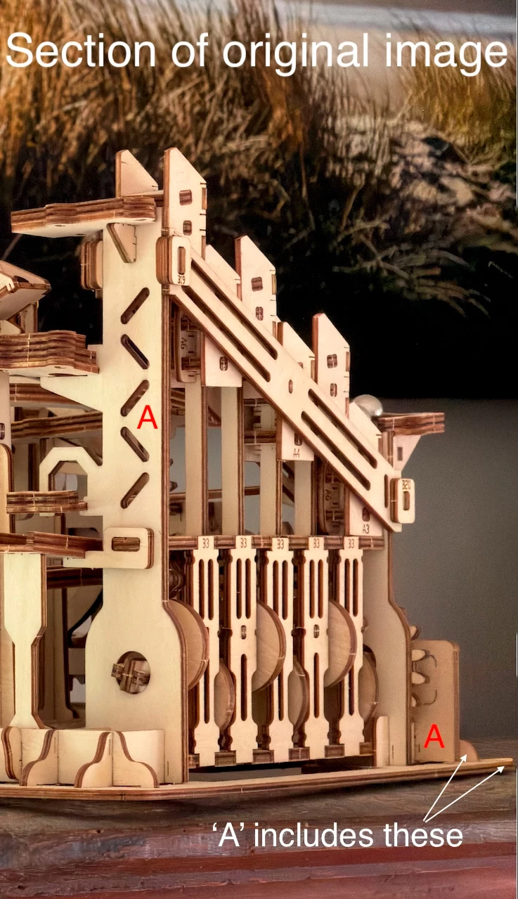

Recently I had repeatedly the situation that Firefly generative remove in LR Classic does not want to delete an undesired object in a selected photo area, instead it is insisting to generate a new or displaced object of the same type, see screenshots as example. Could we get prompt inputs to direct Firefly generating more desirable results for image retouching in LRC?
first screenshot above, generated new object from original photo seen in the second screenshot below. Ingore the red dot, the whole area with cables and cable shield was selected for generation.
johnrellis
September 16, 2026
[View this post in your web browser. It contains formatting and images that don't appear in email.]
​@mgroeteke I had repeatedly the situation that Firefly generative remove in LR Classic does not want to delete an undesired object in a selected photo area, instead it is insisting to generate a new or displaced object of the same type … he whole area with cables and cable shield was selected for generation.
Using your screenshot, I was able to remove the cables and shield quickly:
A couple of tricks:
- Don’t use Detect Objects. It gets in the way often enough that I just always keep it disabled.
- Make sure you select the shadows of the cables and cable shield as well. Otherwise, it will try to generate a replacement matching the shadows.
- Select all the disconnected parts of the cable -- otherwise, it will try to generate a replacement that matches the unselected parts.
If this doesn’t help, please attach a full-resolution JPEG exported from the original image.

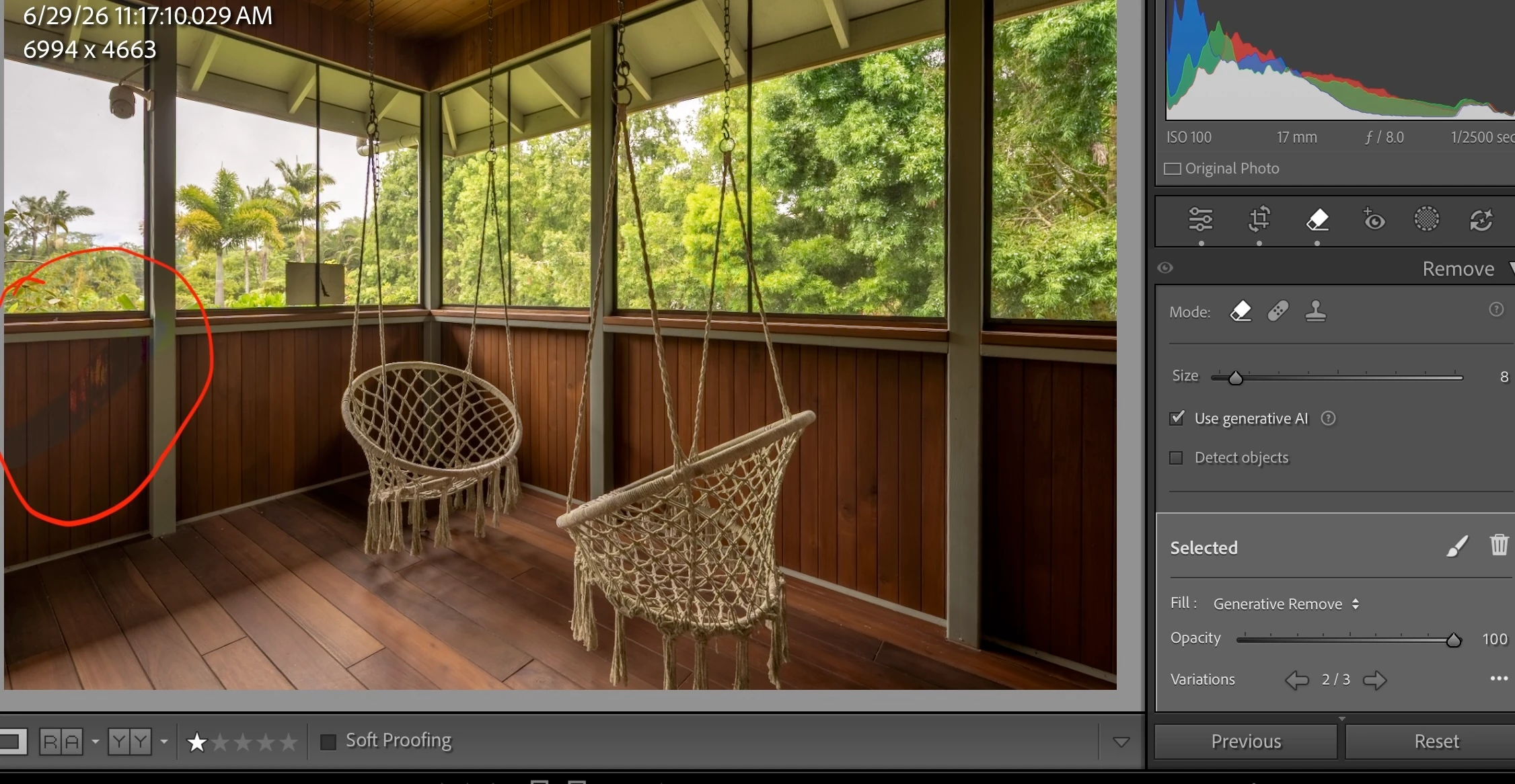

September 6, 2026
I removed several unwanted branches in this photo without any problem but the last branch does not disappear tottaly regardless where I put the opacity
johnrellis
September 6, 2026
​@Eager_Buttercupa540 I removed several unwanted branches in this photo without any problem but the last branch does not disappear tottaly regardless where I put the opacity
It may be that you applied Remove on top of an AI mask, in which case the AI Edit Status button will be yellow:
Click the button and do Update to recompute the mask.
If this doesn’t help, then attach a full-resolution JPEG exported from the unedited photo and a full-resolution screenshot (not a phone pic) of the entire LR window showing the removal that’s not working.
