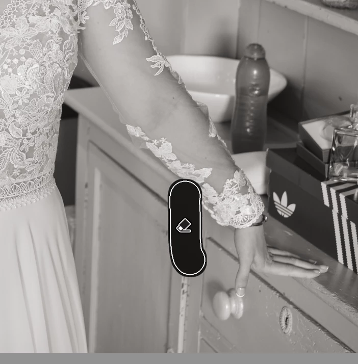

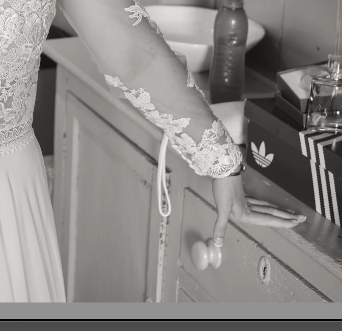

What have you done !?!?!?!?!
The Lightroom Classic 16.0 update is unacceptable.
I'm a professional photographer, and since this update it takes me HOURS to remove things that used to take minutes. This is simply not okay!
1. The Remove tool with "Generative AI" now processes every single spot immediately. Marking several areas and applying them all at once used to work – now it's gone. With hundreds of images per shoot, this costs me hours every single day.
2. Even the simplest retouching fails: small spots on plain cardboard or a thin string – the tool can't handle it. Leftovers remain or new artifacts appear.
3. The red mask overlay is only partially displayed while brushing – I can't even see what I've selected.
New AI gimmicks at the expense of basic functionality – that's not what I'm paying a subscription for!
FIX THIS IMMEDIATELY: Bring back the ability to mark multiple areas and apply them at once, and make simple retouching work reliably again.
System: Lightroom Classic 16.0, macOS 26, Intel MacBook Pro

​@Ela5C7C The red mask overlay is only partially displayed while brushing – I can't even see what I've selected.
That was a bug introduced in LR 16.0, and 16.0.1 was just released, fixing it.

​@Ela5C7C The Remove tool with "Generative AI" now processes every single spot immediately. Marking several areas and applying them all at once used to work – now it's gone. With hundreds of images per shoot, this costs me hours every single day.
If this still occurs after updating to LR 16.0.1, then something’s amiss in your installation -- that’s not how LR 16 normally works. Some things to check:
1. Triple check that the Remove option Use Generative AI is checked.
2. Try resetting LR's preferences:
https://www.lightroomqueen.com/articles-page/how-do-i-reset-lightrooms-preferences/
LR sometimes soils its preferences file, and resetting it can fix all sorts of wonky behavior. That article explains how to restore the old preferences if resetting doesn't help.

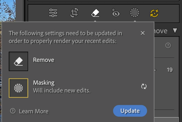

non capisco perchè dopo l’uso della rimozione con ai resti la sagoma del soggetto rimosso in chiaro al posto della nuova immagine. Ciò accade dopo l’ultimo aggiornamento. Follia. Questo penalizza molto il mio flusso di lavoro.
johnrellis
Nov 14, 2026 4:51 PM UTC
[View this post in your web browser. It contains formatting and images that don't appear in email.]
​@vincenzo_6388 why after using the removal with AI residuals the silhouette of the removed subject is left clear in place of the new image.
Silhouettes result from applying Remove on top of an AI Mask. In this case the AI Edit Status button will be yellow:
Click the button and do Update to recompute the mask.

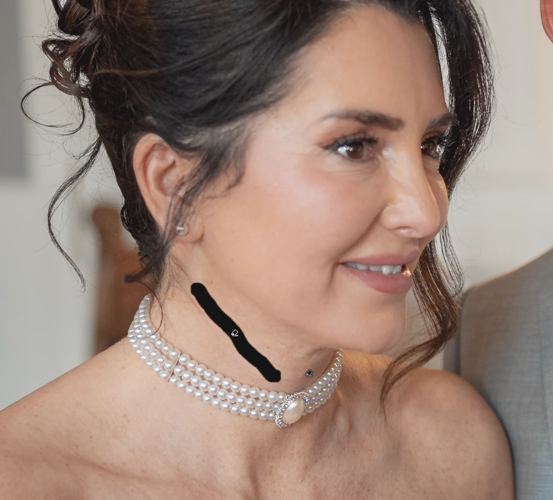

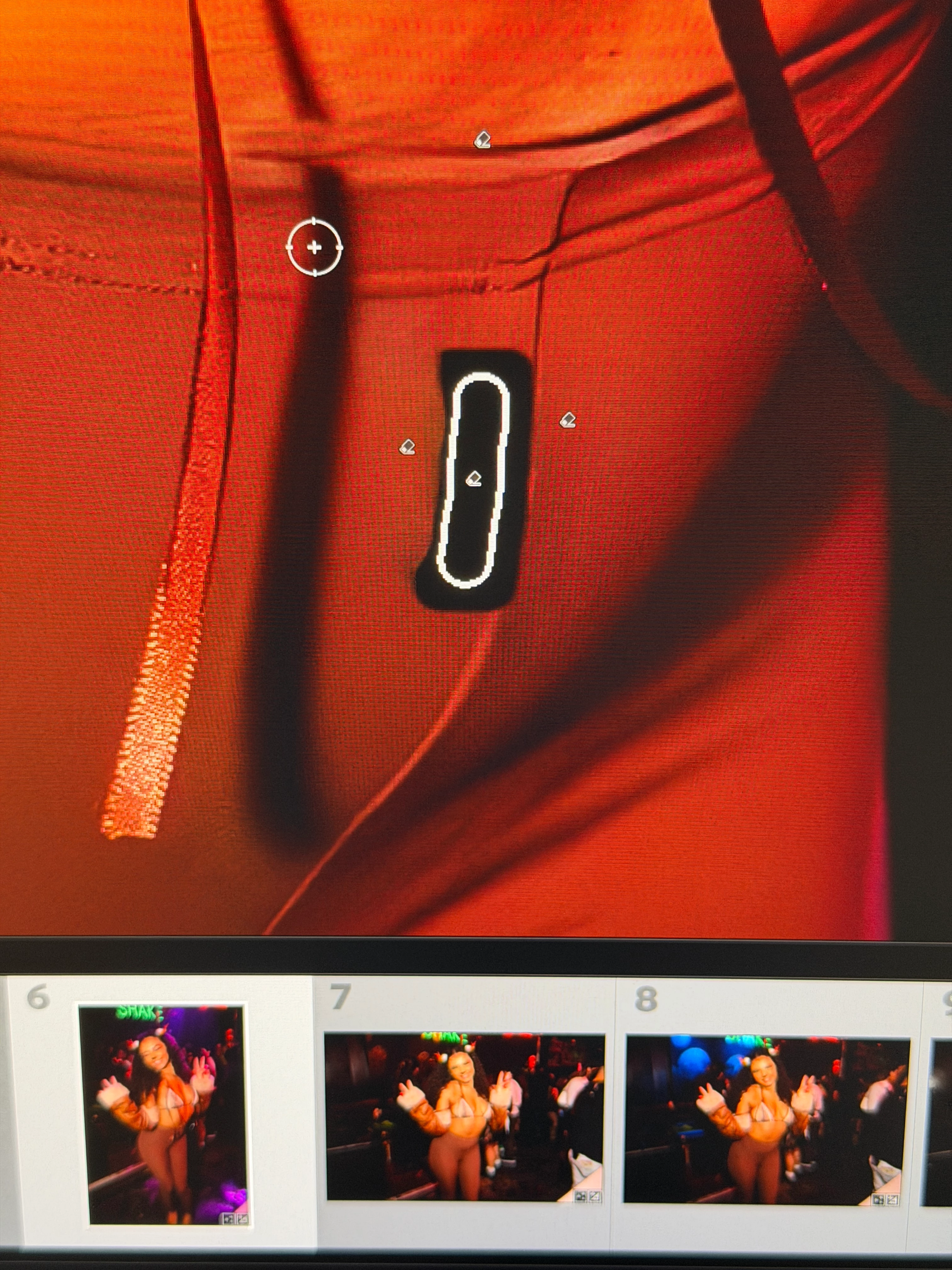

Nov 12, 2026 8:36 PM UTC
When selecting areas for removal, the first one selected shows up with a red mask.  Subsequent selections may or may not show any indication that they’ve been selected.  This occurs whether visualize spots is on or off.  All areas selected will be removed, regardless of whether they’re highlighted.  For example, select 6 spots, and maybe 3 will show that they’ve been selected with the red mask, the other 3 won’t, but all 6 will be removed.

Mein Problem war dass ich zuerst das Foto bearbeitet habe (Helligkeit etc.) und dann das remove tool benützt habe. Da hat das Programm ein Problem!
Wenn ich zuerst das Remove Tool benutze funktioniert die Entfernung des Objektes.
Erst dann bearbeite ich das Bild weiter.
Ich meine dass das Remove Tool nur auf das unbearbeitete Bild zugreifen kann - sicher ein Programmfehler.
In meinem Beispiel war der Himmel wesentlich heller - deshalb der helle Schatten des Astes.

​@herbertn83855588,  it looks like you applied Remove on top of an AI mask, in which case the AI Edit Status button will be yellow:
herbertn83855588
Nov 9, 2026 12:05 PM UTC
Danke für die Info - ja so funktioniert es!!
