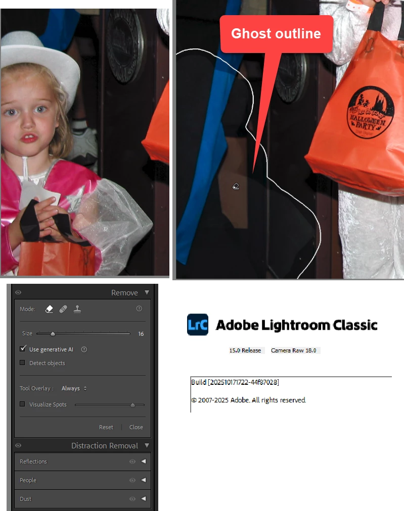

Sep 14, 2026 1:37 PM UTC
Even with the remove 100% removed birds are still visible as ghosts..
While working on an image 2 birds were trowing the image out of balance. So i wanted to remove them. And so i did. And yes the remove is 100% . But it feels like its only set on 95% as the ghost of the birds is still visible. Is this what i pay for?
johnrellis
Sep 16, 2026 9:17 PM UTC
[View this post in your web browser. It contains formatting and images that don't appear in email.]
​@maiky-nisute But it feels like its only set on 95% as the ghost of the birds is still visible.
It may be that you applied Remove on top of an AI mask, in which case the AI Edit Status button will be yellow:
Click the button and do Update to recompute the mask.
If this doesn’t help, then attach a full-resolution JPEG exported from the unedited photo.
