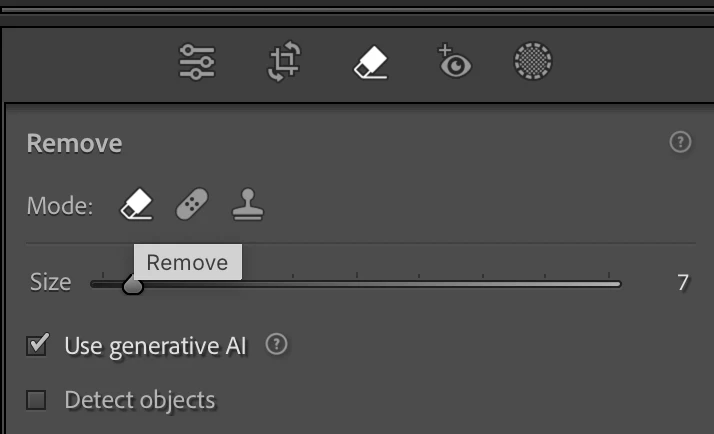

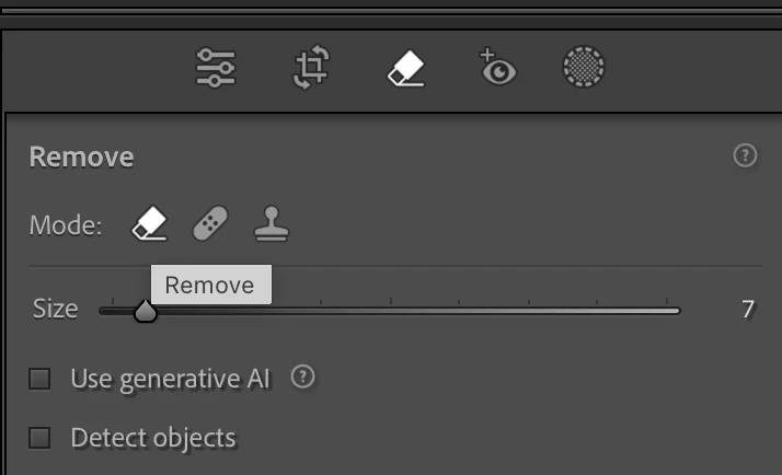

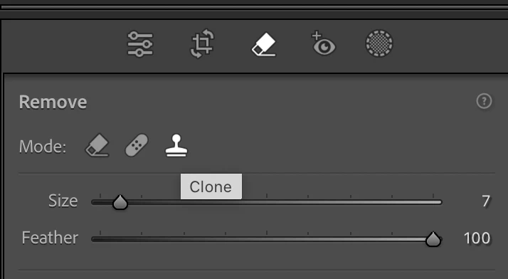

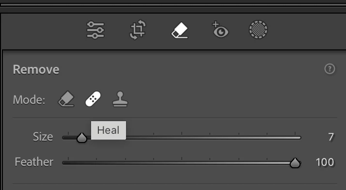

@lynnr8655735: "I absolutley hate the ai please let us have a turn off button"
All the older, non-generative-AI remove options are still there.
Clone:
Heal:
Content-aware Remove (non-generative AI):
But you might read this short tutorial about how to Generative AI Remove more effectively:
https://www.lightroomqueen.com/generative-remove-replace/
Once you spend a few minutes learning to use the tool, it works quite well. But if it doesn't help, please attach a full-resolution JPEG exported from the unmodified original photo (not a screenshot). With nearly every one of the many dozen problem photos posted here, we've been able to show how to quickly remove the desired objects.

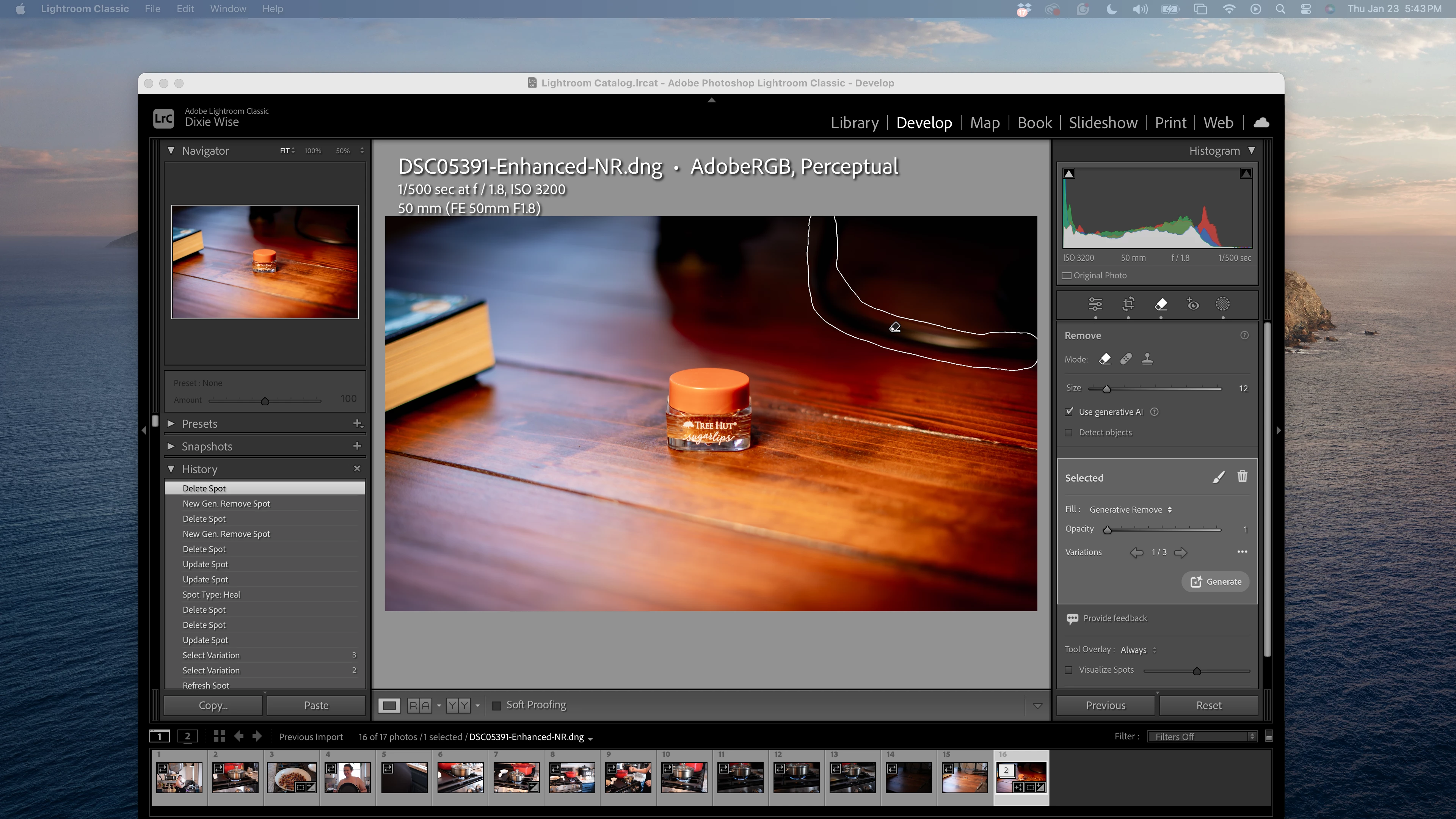

Remove rfesult - see
pics- artifacts
johnrellis
April 23, 2025
@cermetmj: "Remove result"
You need to select the stool's shadow as well as the stool itself, and also select a little bit into the fur of the dog's tail to ensure every bit of orange stool is selected. Otherwise, Remove will generate a replacement that tries to cast the unselected shadows and match any unselected orange bits.
See this short article for how to remove objects more reliably:
