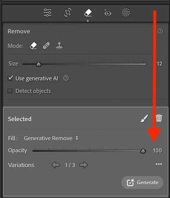

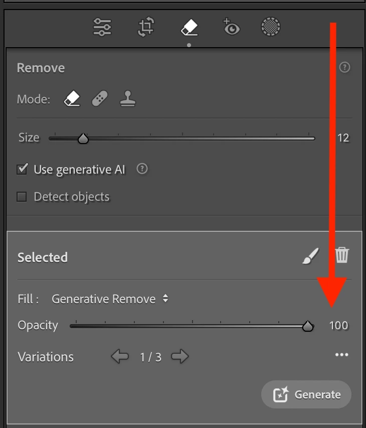

since the new update i have some issues on my Apple M2 Pro with lagging when using the healing tool.
also the generative fill seems to have a transparency
hope that helps to search for bugs 🙂

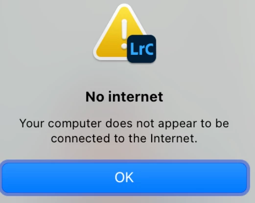

hi! It doesn't work....
johnrellis
Feb 23, 2025 3:10 AM UTC
@hanna_2225: "Generative Remove Failed. We've encountered an issue and can't complete your request at this time. Please try again later."
That badly written error message indicates that the Generative Remove command was unable to contact the Adobe Firefly servers to do the removal. Sometimes firewalls and anti-malware / anti-virus utilities incorrectly block some network requests from LR. Try these troubleshooting steps:
- Temporarily disable all the firewall / anti-malware on your computer. If that solves the problem, then add a specific exclusion for LR to the firewall's rules.
- Connect to another network, preferably one serviced by a different ISP. E.g. a Wifi connection of a neighbor, a coffee shop, work, or your phone's hotspot. Sometimes the routers in these networks block LR's requests, especially in authoritarian countries like China.
To help others, please let us know which of these work and which don't.

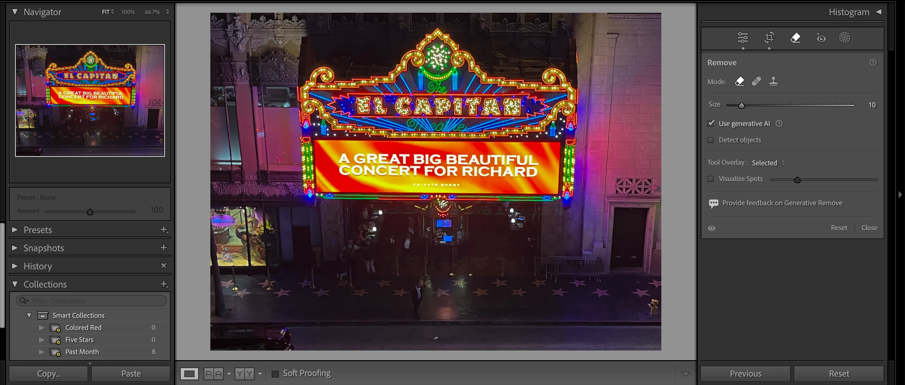

Feb 22, 2025 9:30 PM UTC
So far, this is amazing! Thanks!
