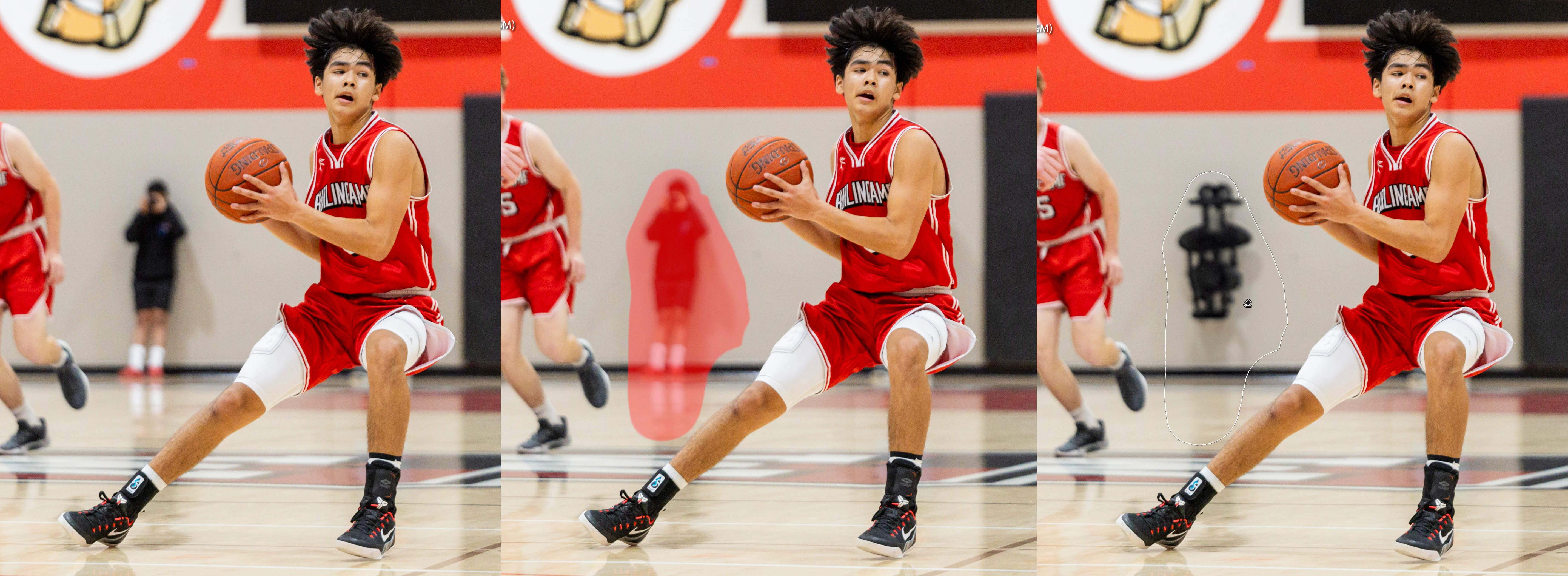

P: Generative Remove Feedback (Lr Classic & Lr Eco)
This post applies to Lightroom Classic and the Lightroom Ecosystem products.
Camera Raw feedback can be found here.
Generative Remove makes it easier to remove unwanted objects and distractions with a simple gesture, even on complex backgrounds. For more accurate results, be sure to include the object's shadow in your selection and/or expand its size.
Detect Objects uses AI to find the objects underneath a brushed area. The masked areas will now appear larger than the Early Access version of this feature. You can also circle objects for quicker selection now.
We have also updated the spot selection experience to make it easier to manage variations, switch the fill type, refine the selection area, or re-generate as needed.
Batch updating is also now supported for Generative Remove spots.
Try out the latest updates and share your feedback with us here. Please also include the following details in your post:
  • App version
  • System details
  • Example image(s) if you wish to share
Our team continually monitors this thread to track issues for future improvement. Thanks!
