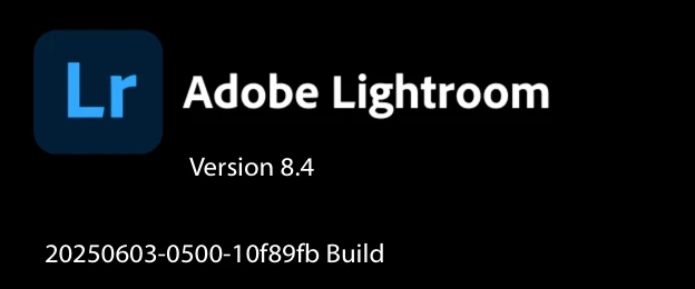

Has the ability to apply ai-Denoise to multiple images simultaneously been removed? This renders the app WAY WAY LESS useful to me.
I'm going to have to roll back / move off the platform if I can't apply the denoise to multiple photos.  (attached screenshot of the version I'm using)
