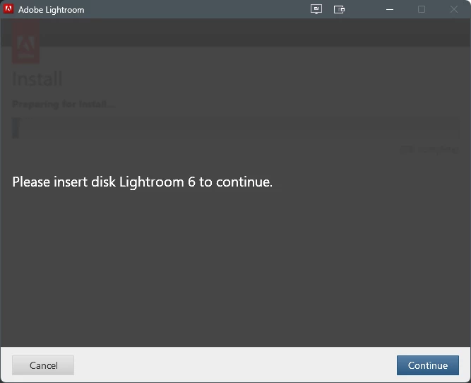

I have used LR6 standalone for years via the perpetual licence from purchase. I recently had to upgrade my PC to a new machine. I have all the download installers for LR6 so I installed it on the new machine. However I am now stuck in an Adobe sign-in loop that prevents me from launching the software. If I double-click to run LR6, the Adobe prompt window comes up saying I need to be signed in, in order to proceed. I sign-in (online verification etc). I am told to close the sign-in window and continue. Nothing has launched. I click on LR6 to launch it manually, I get the Adobe prompt telling me I need to be signed-in to continue (despite having already signed in). Repeat, on a loop, ad infinitum.  There is zero support from Adobe for this. It is also impossible to connect with a human agent as the AI bots just spout links to irrelevant ‘resource’ articles and declare that support is not available as I don’t have a registered product. I realise this no viewed as ‘legacy’ by Adobe, but if I paid for it and was able to run it on my old machine, does a computer upgrade now mean I can never run it again, and never access my LR catalog?! Could someone at Adobe, or anyone on here, please advise as to a way out of the above loop? This all seems brutally unfair on the paying customer.
Jul 5, 2026 4:35 PM UTC
Jeg vil flytte min LR6 clasical til ny PC. Jeg har en setup-fil fra den gamle PC, som har virket ved tidligere flytninger. tidligere. Jeg har endvidere en kode fra jeg købte LR. Når jeg installerer LR og starter den op går den blot over i en sign-in mode.
dj_paige
Jul 5, 2026 6:01 PM UTC
I want to move my LR6 classical to a new PC. I have a setup file from the old PC, which has worked during previous moves. I also have a license from when I bought LR. When I install LR and start it up, it just goes into sign-in mode.
That is the translation of your message to English.
Please read the message from ​@Eldiin at this link and follow that procedure to install Lr 6.
