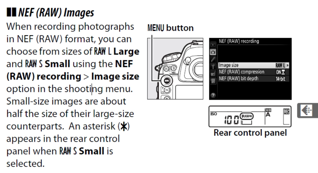

It's hidden deep in the user manual and in the menu. In the chapter called Image Recording Options, there is a table showing Image Quality and another showing Image Size and neither mentions this Small RAW. There is no warning when Nikon describes how you should choose the quality by pushing the QUAL-button and rotating the main command dial. But later in the chapter there is a small paragraph that is very, very important:
If you choose JPEG the quality and size is shown in the row in the rear control panel, and you may control it with the two dials. But the only indication that you have chosen RAW S is a small astrix and you can not switch size/quality with the sub-command dial.
You have to go into the menu and avoid the RAW S Small 2464 x 1640.
