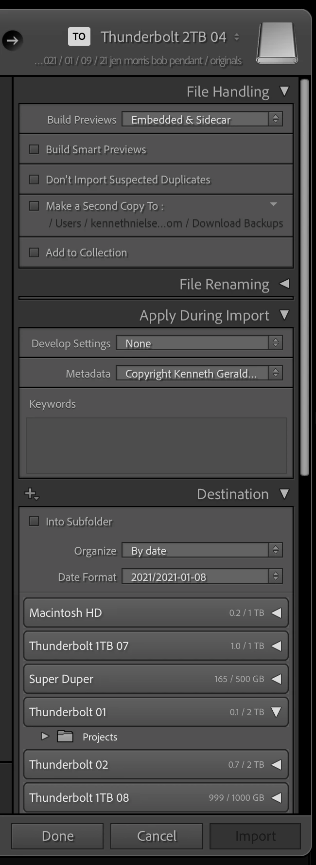

In the past years I've imported files arranged by folders with dates and brief folder content names - All of that has come in very clear and easy to find images I need from the past. Now, this year, the only time this has happened, the folders are simply dates and not showing folder date and description even though I import the same way I've done in the past, pointing Lightroom to the CF card where the images exist and to copy to a folder on my hard drive with folders inside and pointing to 'original images' as I've always done in the past.
I don't know if I can fix this and get it working like it has in the past, All of my images are 'hidden' in a sense as there is no date or description showing in lightroom just... well you can look and see... The screen shots I'm shoing here show how it has been going in the past and now current imports and showing how there is no description or dates even though Lightroom shows when importing that it sees clearly the main folder named by date and description and the target folder 'original images' within that folder.

It would be helpful if we could see a screen-clip of your Destination Panel in the Import module.
The settings in this panel determine the folder name and structure.
But my first thoughts are that you are seeing the "Duplicate Folder" syndrome also known as the "Capitalization" problem.
Your screen-clips do not show it, but if you hovered over each of the 2021 folders you might see that one letter in the full path in the folder path is either Upper or Lower case differently.
Some site links to get you started on a fix. AND NOTE: It can only be fixed by the methods given! Simply trying to move or rename folders does not correct the problem.

Good comments and first, I only use lowercase always for that reason, helps narrow possible errors. I include the screen shot anyway. I don't have any duplicates, but here is the strange thing... after posting this thread asking for help I tried to import again but only to the main folder and specifying the main folder as the target and also the same for the destination, I have no idea why it worked as I was at the point of desperation at this point and willing to lose my entire library as it is useless to me the way it started out anyway. and amazing enough! - It Worked! The folders now show up and in their proper name with date first then brief description (all in lowercase always) So I don't know what to say but give credit to desperation at this point.

The Destination Panel requires a good understanding to be sure that image files 'go' where YOU want them, and the settings are not always 'sticky', meaning they may change. (and you can have multiple Presets). Many are confused (like I was) by the "Nested Folder" Date Formats. Explained here-

You can see what is happening, every import only shows as a folder named 2021... This is going to be impossible to search for images after I continue on in this way.
