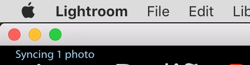

Lightroom CC stuck "Syncing 1 Photo" for hours
I just excitedly, potentially, foolishly migrated my Lightroom Classic library to the new Lightroom CC.
It's been powering along with the upload - my library isn't huge at 200gb, and the fibre has held up well.  The app is now stuck 'Syncing 1 Photo', and has been for hours.
Looking at network traffic in/out of my machine I can see there's nothing happening (unlike the 20mb/sec I've been seeing for most of the day).  So I don't think there is actually an upload happening.
Is there a way to debug and find out what single image is potentially stuck?  The new interface is very light on information.

Hi Marek,
In grid view, please hold down the Option key (Mac) while clicking on the cloud icon in the upper right. This should show you which photos are still trying to sync. From here you would have the option to delete these and re-import them. Can you please try this step and confirm if this helped or not.

Hello.  I had the same problem on Windows 10 PC and Lightroom CC (version 2.1.1).
5 photos which were stuck in "Syncing"  -- I tried the tips here (added star ratings, updated meta data, etc.) and that didn't clear out the continuous syncing message.
Since I also have a mac, I checked Lightroom CC on it.
On the Mac, the Cloud icon (top right corner of screen) showed a red exclamation mark for 5 photos.
Clicking on the red exclamation mark resulted in a message that the photos were corrupted and I needed to delete and reimport them -- which I did, for each one.
Interesting was the fact my Windows 10 PC Lightroom CC didn't show the red exclamation marked photos and, without the second Mac device, I wouldn't have known there was an error (corrupt photo).  I'm not saying this is a problem with the Windows 10 version - more likely that I needed the second device to see the error(s).
BTW - I was able to "see" the 5 photos in continual "Sync" via the filters "Sync Status".
