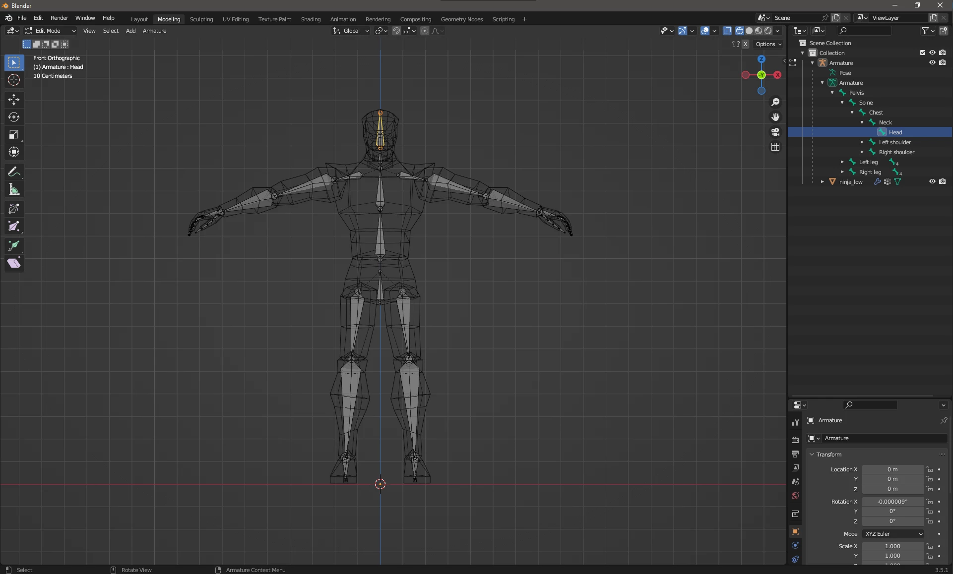

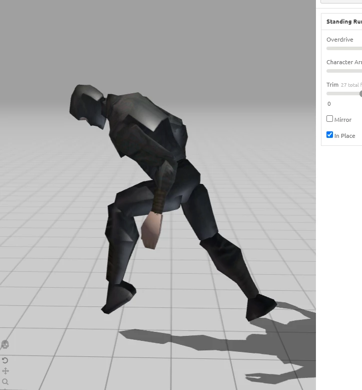

I have a rigged character that I'm uploading to Mixamo and it's 99% working and animations are playing correctly, except that the head of the character isn't animated as if he has a neckbrace on.
I've attached a video of what that looks like too.
This is the skeleton and heirarchy as they appear in Blender:
I got the original rigged model from Sketchfab (The original setup doesn't animate the head either when uploaded). I removed the bones for the sword and the top of the head.

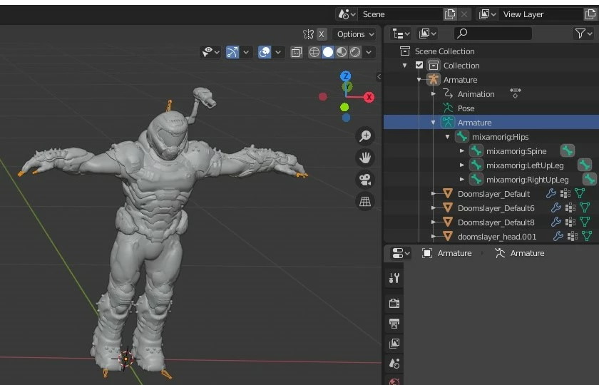

Mixamo animations are designed to run on a Mixamo bone rig
strip out those bones and use one of the default Mixamo named rigs
