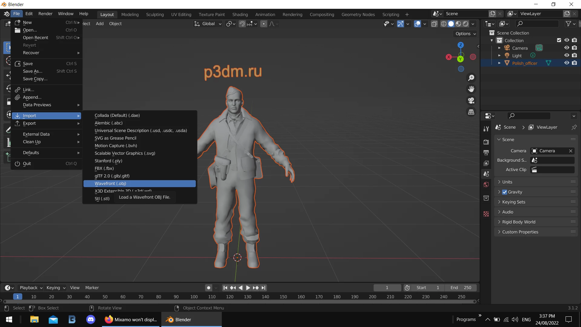

Hi, I'm trying to rig a textured model downloaded from the web. It opens correctly in Blender and 3d Viewer. I followed the advice from earlier discussions here.
My model was already an obj file, I made all the texures into png, then modified the mtl file accordingly (although it still contained folder paths from my PC, maybe that's the issue?), then I've packed everyting into a zip.
But uploading the zip into mixamo.com still gives me a textureless model. What am I doing wrong?

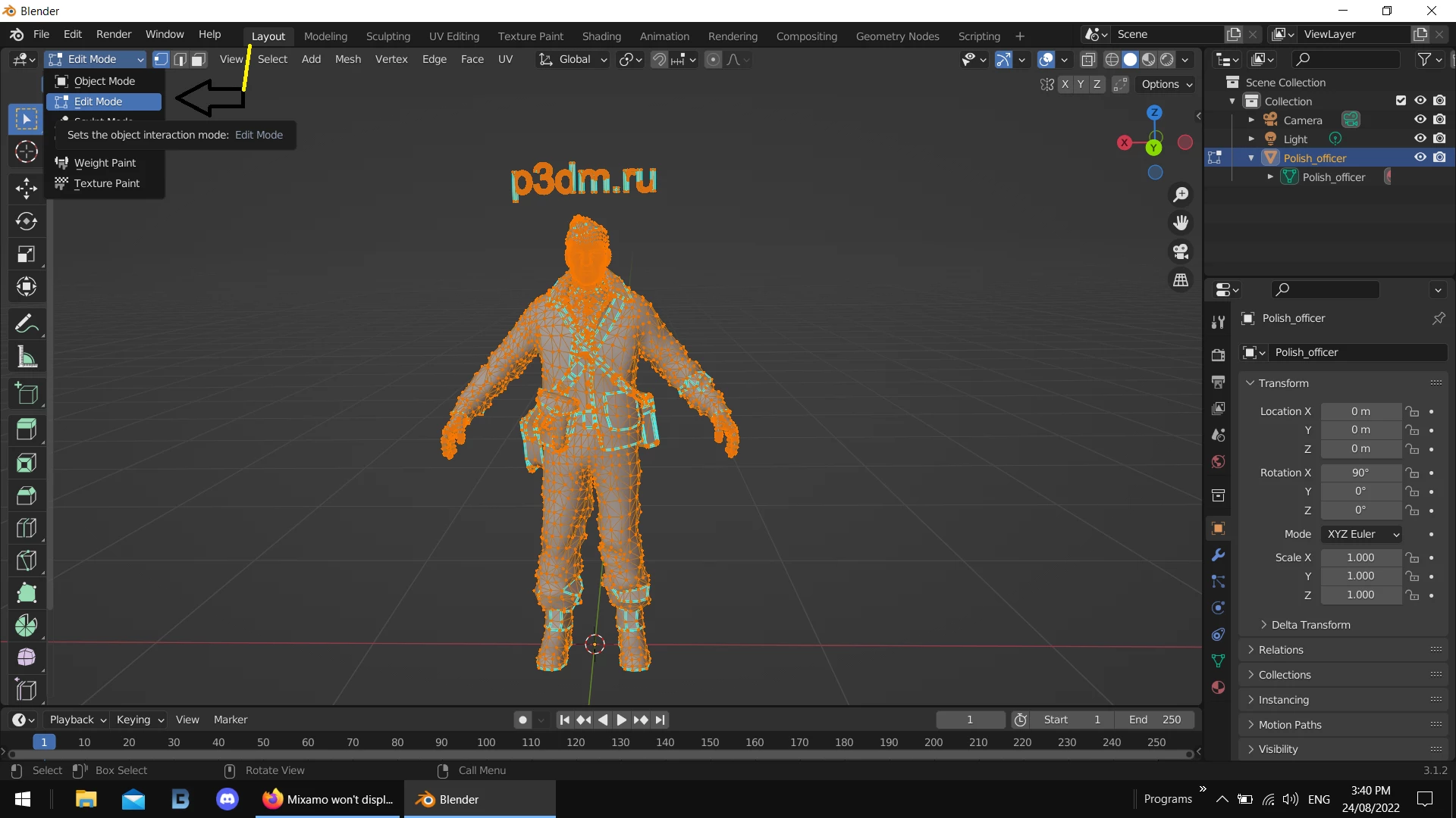

Ussnorway7605025
Aug 24, 2022 5:54 AM UTC
i just used Blender on a Windows system

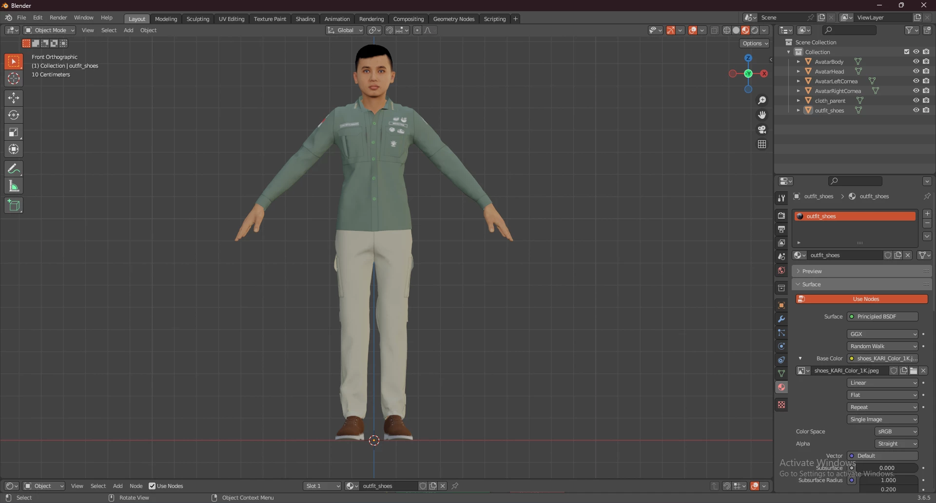

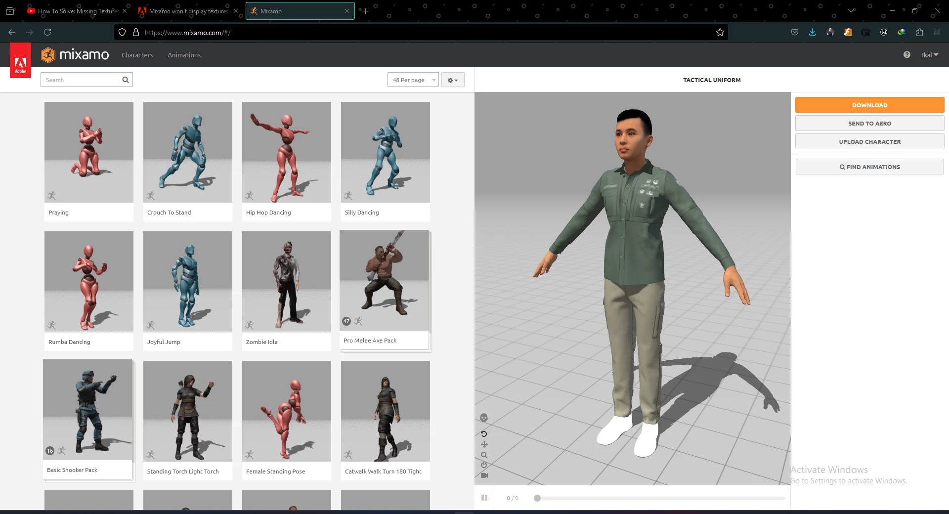

Jul 7, 2024 12:11 PM UTC
I have a pretty similar problem.
Everything is fine but the shoes not.
The
I have done every tutorial on web and Youtube, but no success.
Please help.
Aug 17, 2025 6:13 PM UTC
I'm stuck too and hope you figured it out

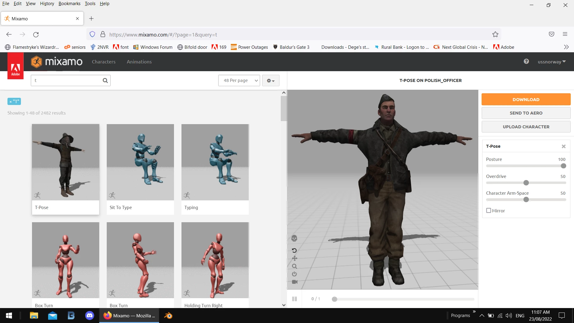

Ussnorway7605025
Aug 23, 2022 1:13 AM UTC

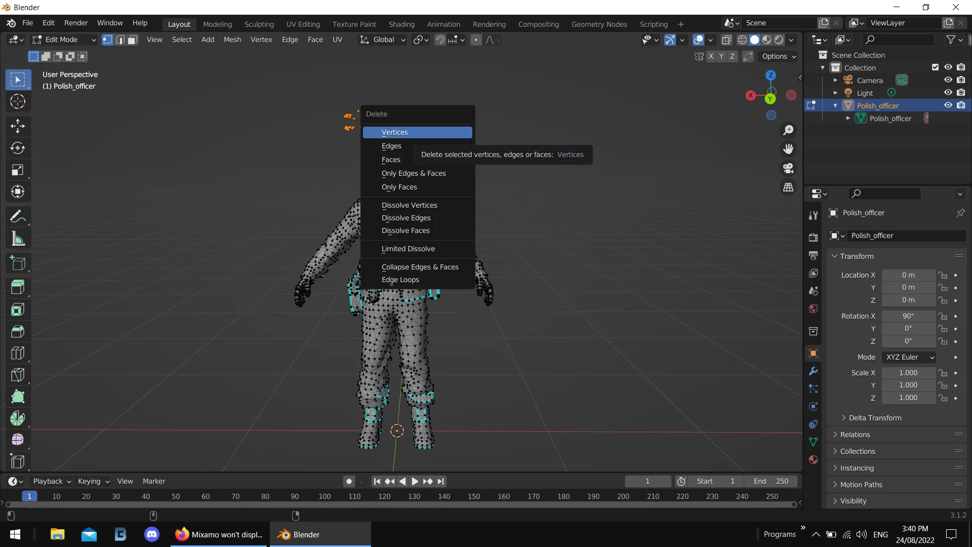

there is some adjustment needed on the jacket because the model was designed A pose instead of T but its minor

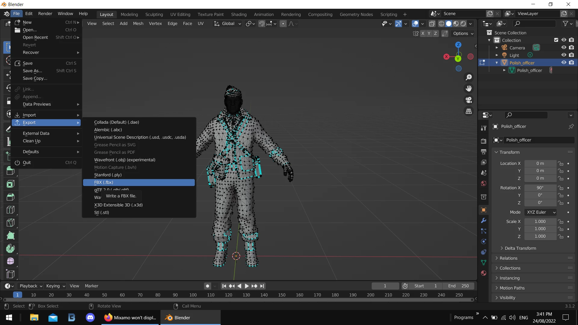

And what should I do to achieve it myself? I'll have more models from this website, and from other ones. What should I do to be able to upload a similar textured model into mixamo?
Exporting it from Blender as fbs does not work (textures show in Blender, but after I upload the fbs to mixamo, model is textureless). What software did you use to create the attached fbx?

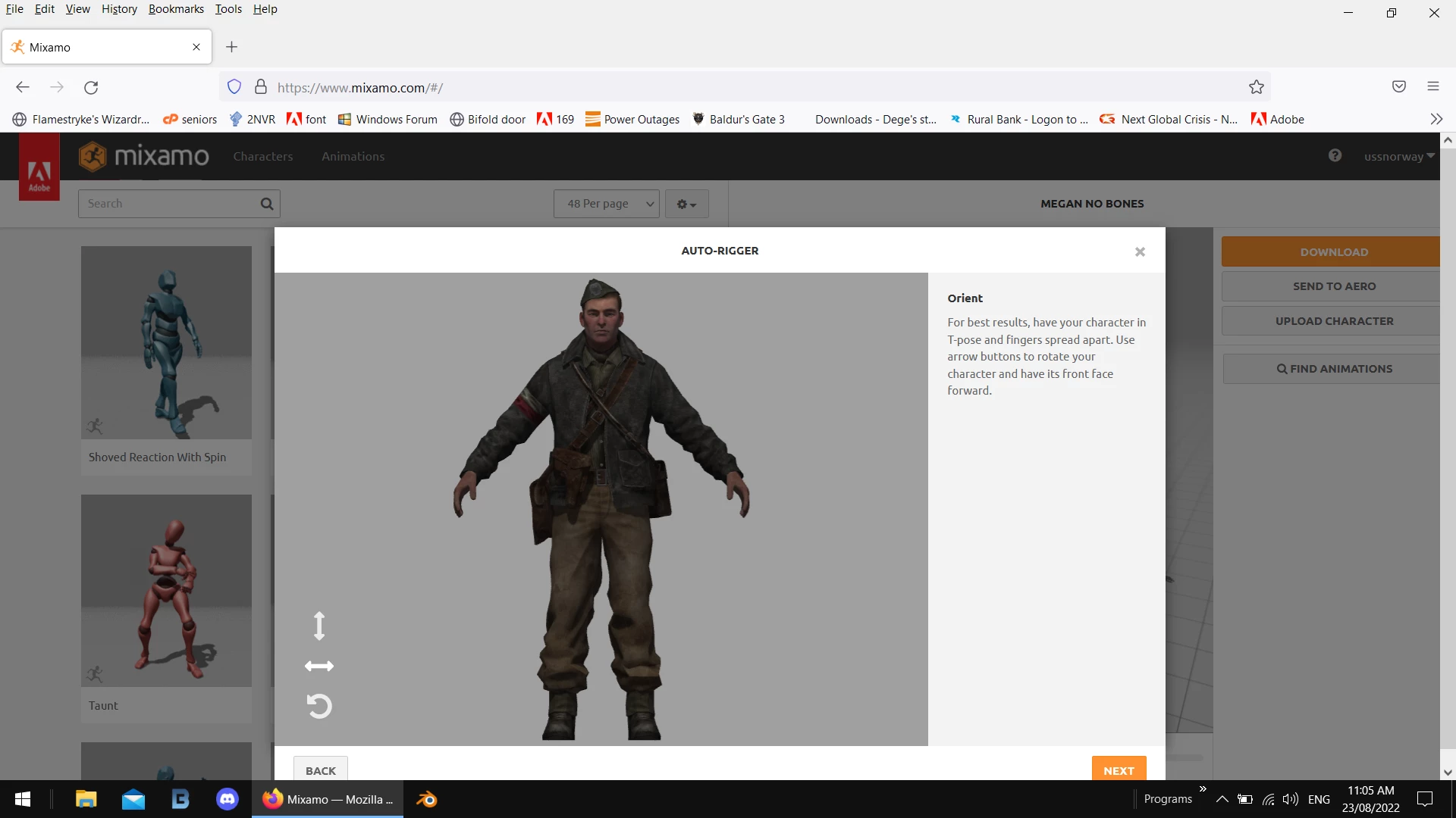

Ussnorway7605025
Aug 23, 2022 12:16 AM UTC

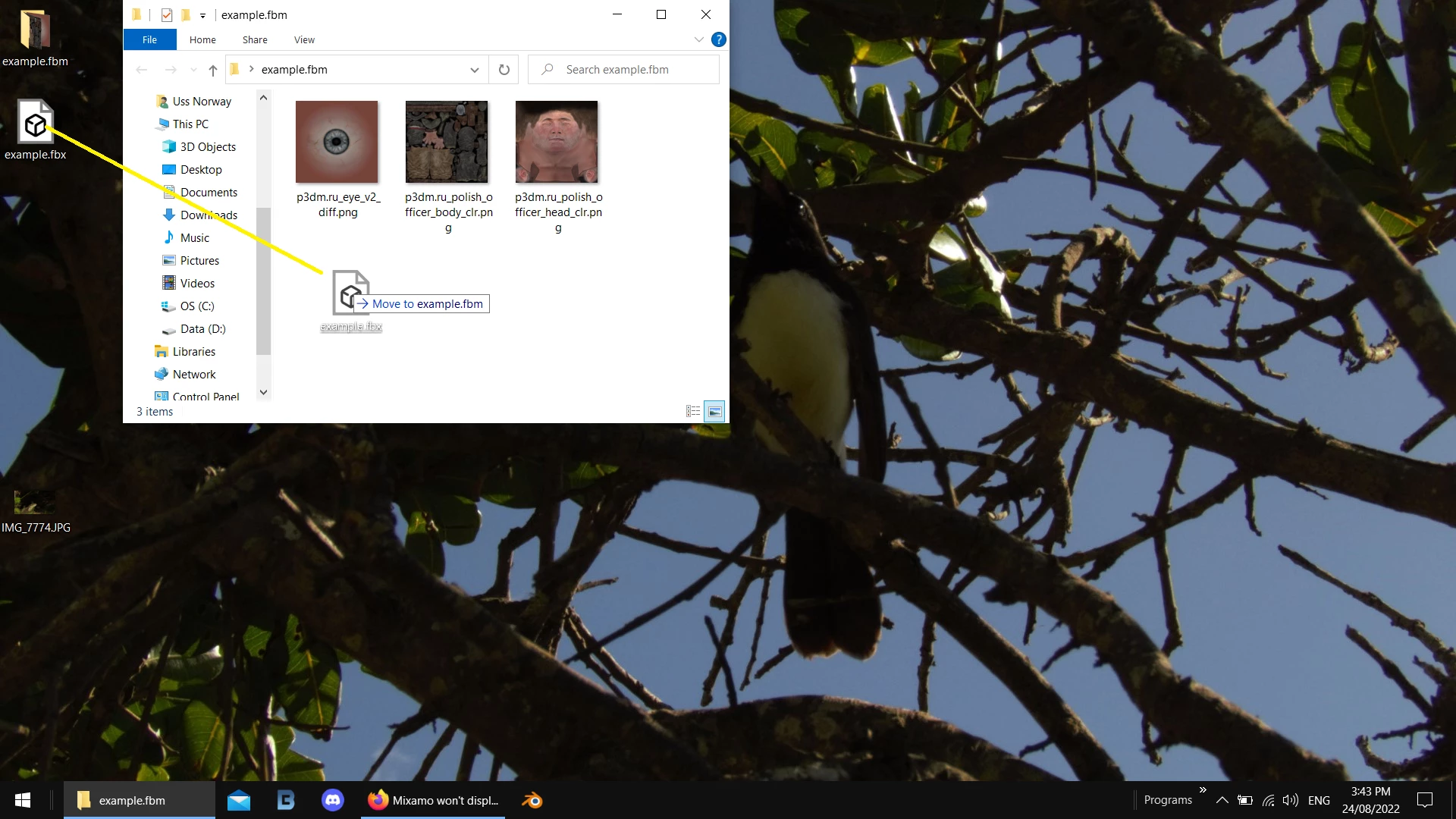

The issue is Mixamo is old school and can't read a plot system so most of your MTL is ignored, you need part I'd and texture name then as long as the actual texture is included you are fine
I'm at work but will try to take another look today
