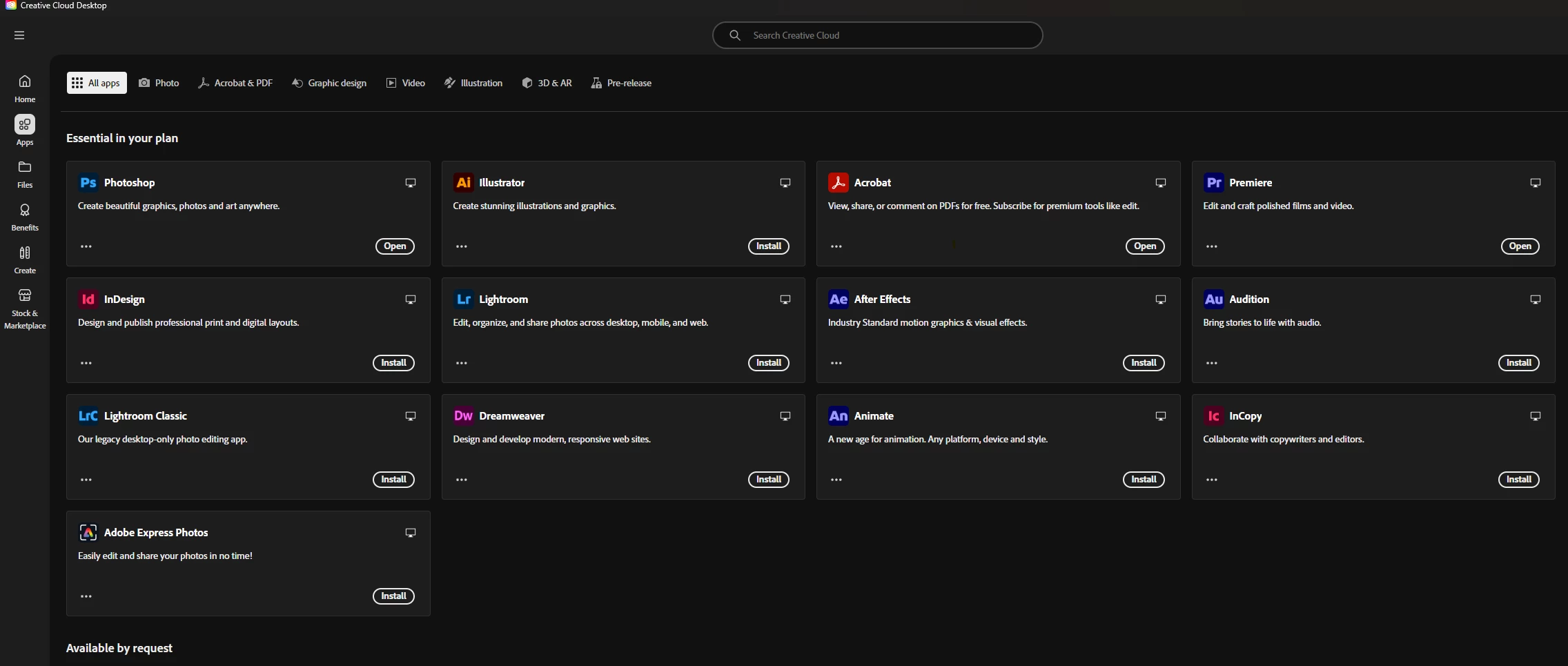

Hi, i just subscribed to Photography plan yesterday and looking for Photoshop beta in the creative cloud beta apps but i didn't found it . Is it normal ?
(Windows 11, Creative Cloud 5.10 installed twice)

Hey,
Not an entreprise account on my PC. I tried everything (CC uninstaller) but nothing worked. Creative Cloud did not lauch again after that (i reinstall CC many times) so i decided to reinstall windows 11 (i know, brutal solution) and everything is OK now. Creative Cloud is working and Photoshop Beta is here.
By @Valentin301007491aq0
It's not "normal", but we have seen a couple of posts.
First, if you are on an Enterprise account, you need to talk to your IT department to give you access.
Otherwise, see if this thread helps:
https://community.adobe.com/t5/download-install-discussions/beta-apps-are-not-showing-up-in-creative...
The OP with the same issue solved it this way:
"I downloaded and ran a Creative Cloud Uninstaller (straight uninstall wouldn't work) then downloaded and re-installed Creative Cloud. It's shows up now."
A second thread (in Enterprise) has a different solution provided by an employee:
https://community.adobe.com/t5/enterprise-teams-discussions/adobe-creative-cloud-app-5-7-1-1-not-sho...
There is a screenshot there as well.
A third idea is to contact Adobe Customer Care and let them assist.
Try the link to auto-open the Chat:
https://helpx.adobe.com/contact.html?rghtup=autoOpen
Type "agent"
If your browser blocks the Chat window, try the troubleshooting tips here:
https://community.adobe.com/t5/creative-cloud-services/how-to-contact-adobe-support/td-p/11875703
You can send a tweet to @AdobeCare.
Do not reply to PMs, which are likely to be scammers.
Please let us know which of these works for you.
Jane
